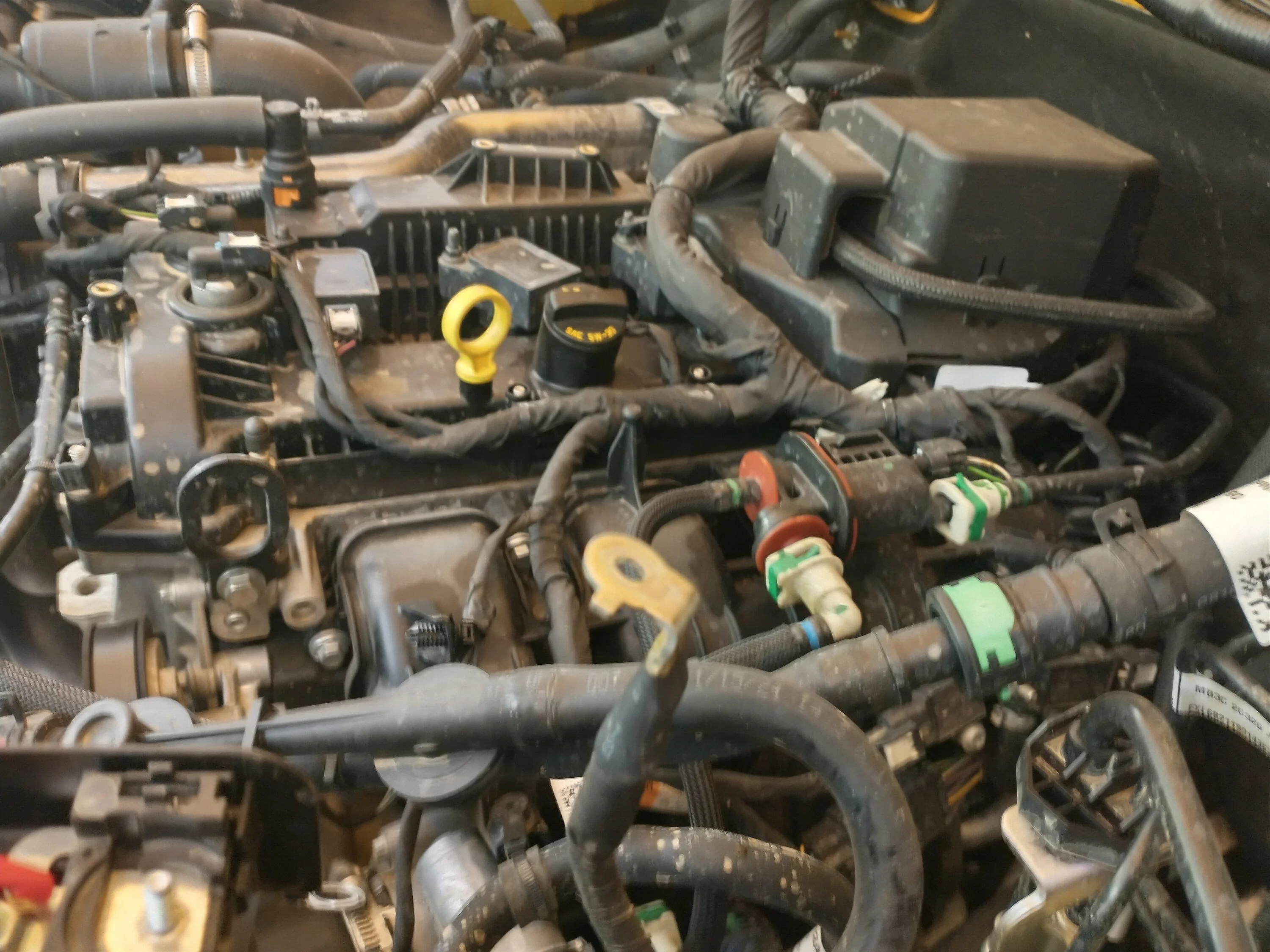

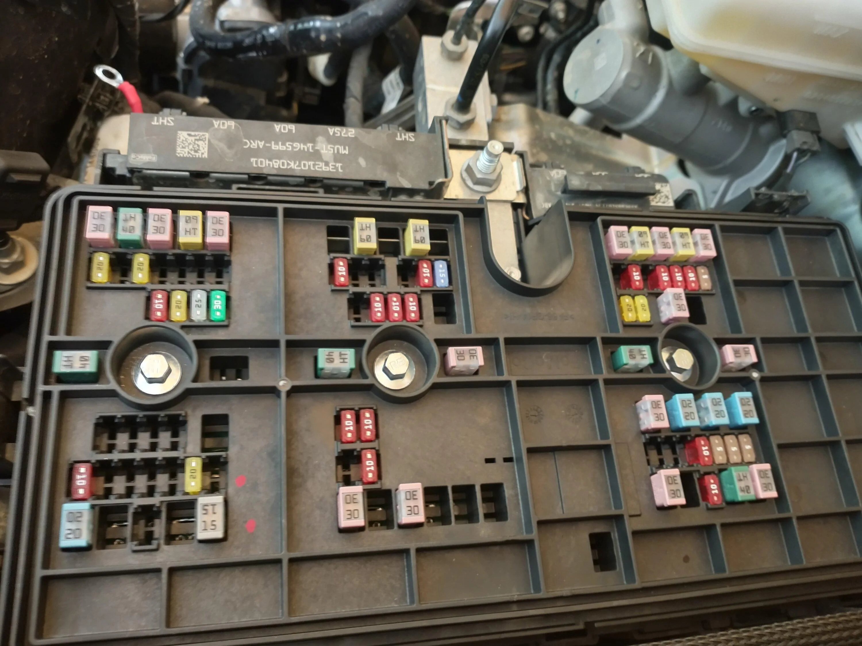

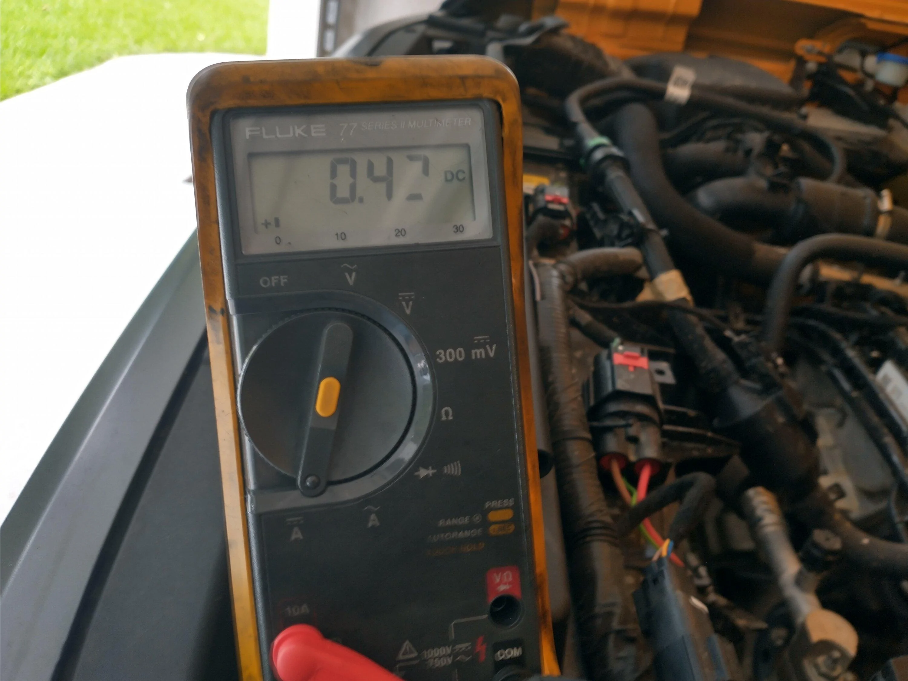

Ok update, unwired all mods hooked up amp meter, the only mod that has a drain is 100ma from stepslider, probably solid state relay leakage current from motor circuit, this is not uncommon, especially if made in China. Now as you can see from photos their is a constant 0.41 amp drain on the cable that goes from battery to engine compartment fuse box. I pulled all fuses and it had no effect on drain. If you unhook that cable from ammeter and rehook it up there is a 7amp draw from something that powers up, you can hear it , like a fuel pump or something. After whatever it is cycles it slowly drops to the .41A drain and then periodically jumps to 4A and then drops back down. Their is another fuse box under dash, I will remove those fuses tomorrow and see what happens. So to make a long story short with all mods hooked up and vehicle just sitting there it has a constant .5a drain. Seems excessive. Still investigating. I hope that Ford man reads this and replies.
