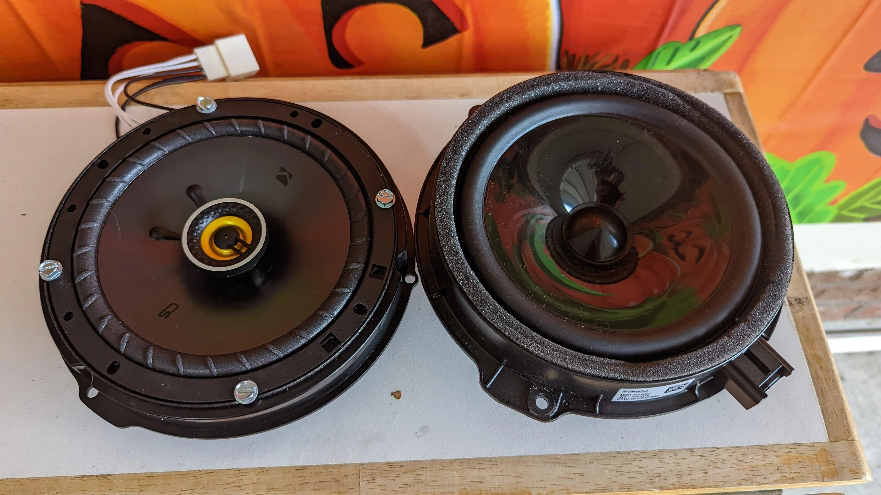

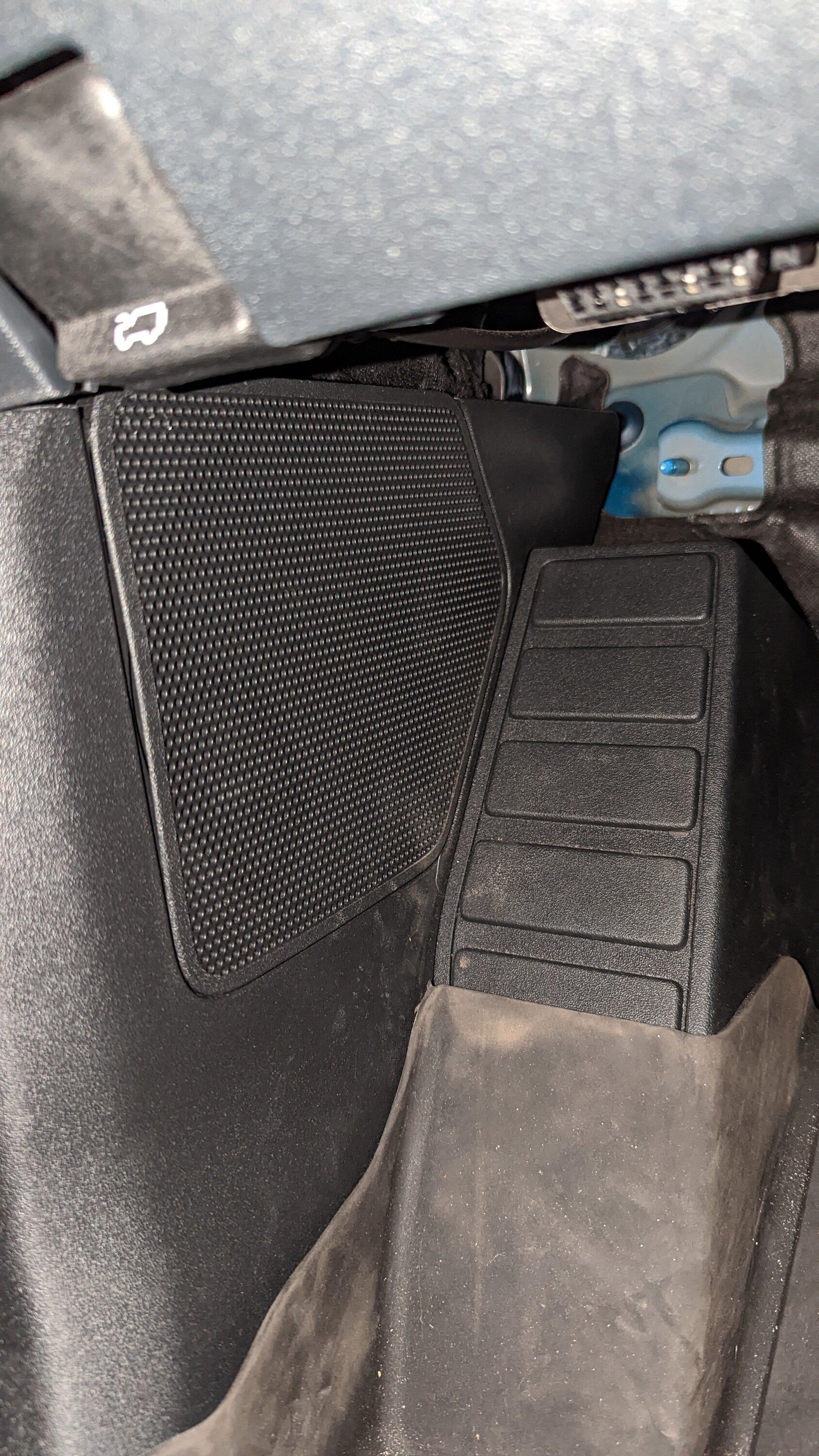

Do you have a photo? I can go re-inspect mine shortly. What screws did you use to mount it to the adapter? Are they sticking up a lot. Mine have a slightly larger head to them but seem just fine.
Axiom89
Oct 30, 2022
South Dakota
2022 Ford Bronco Base
Sorry for them being sideways - New to forums

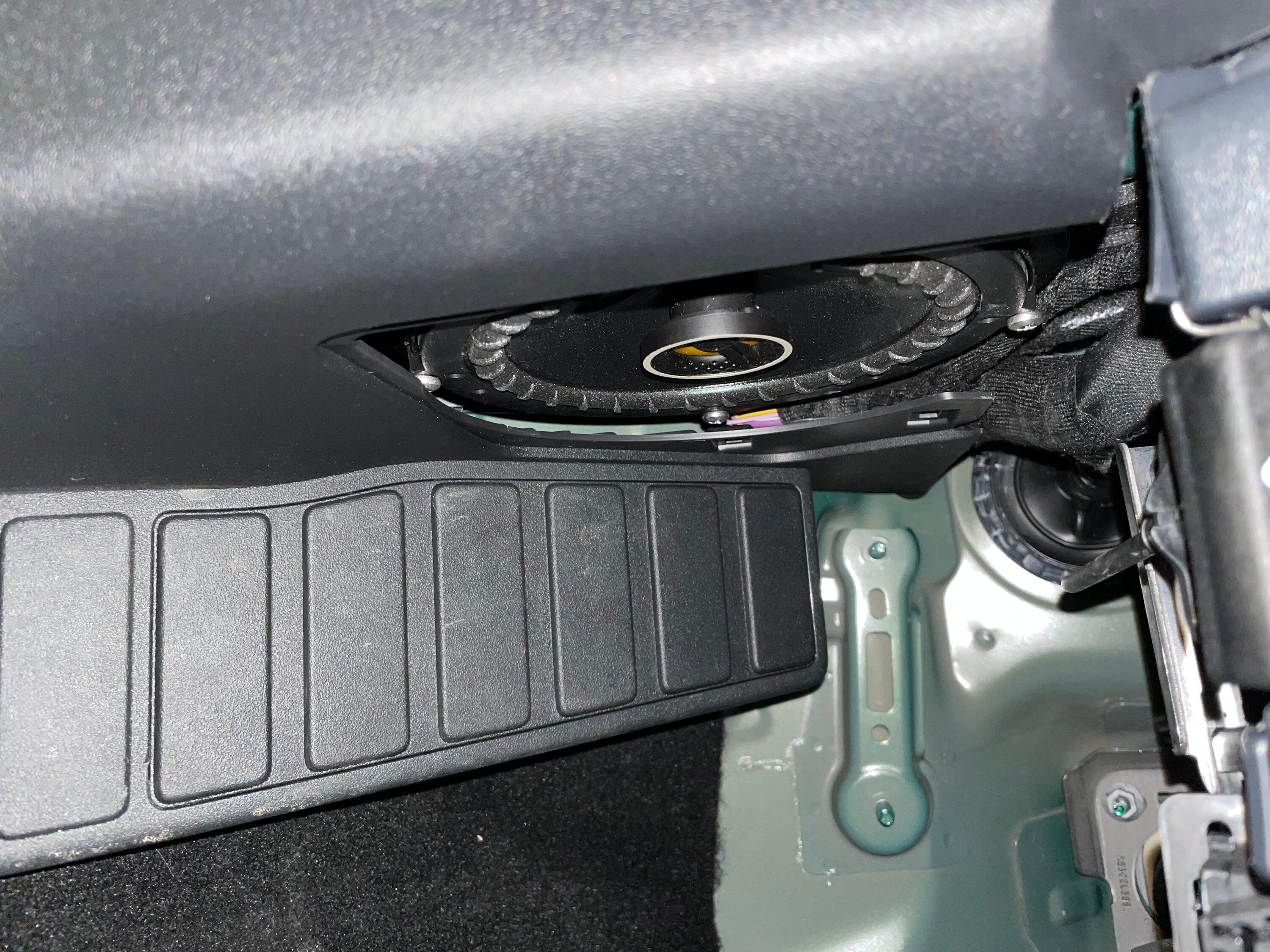

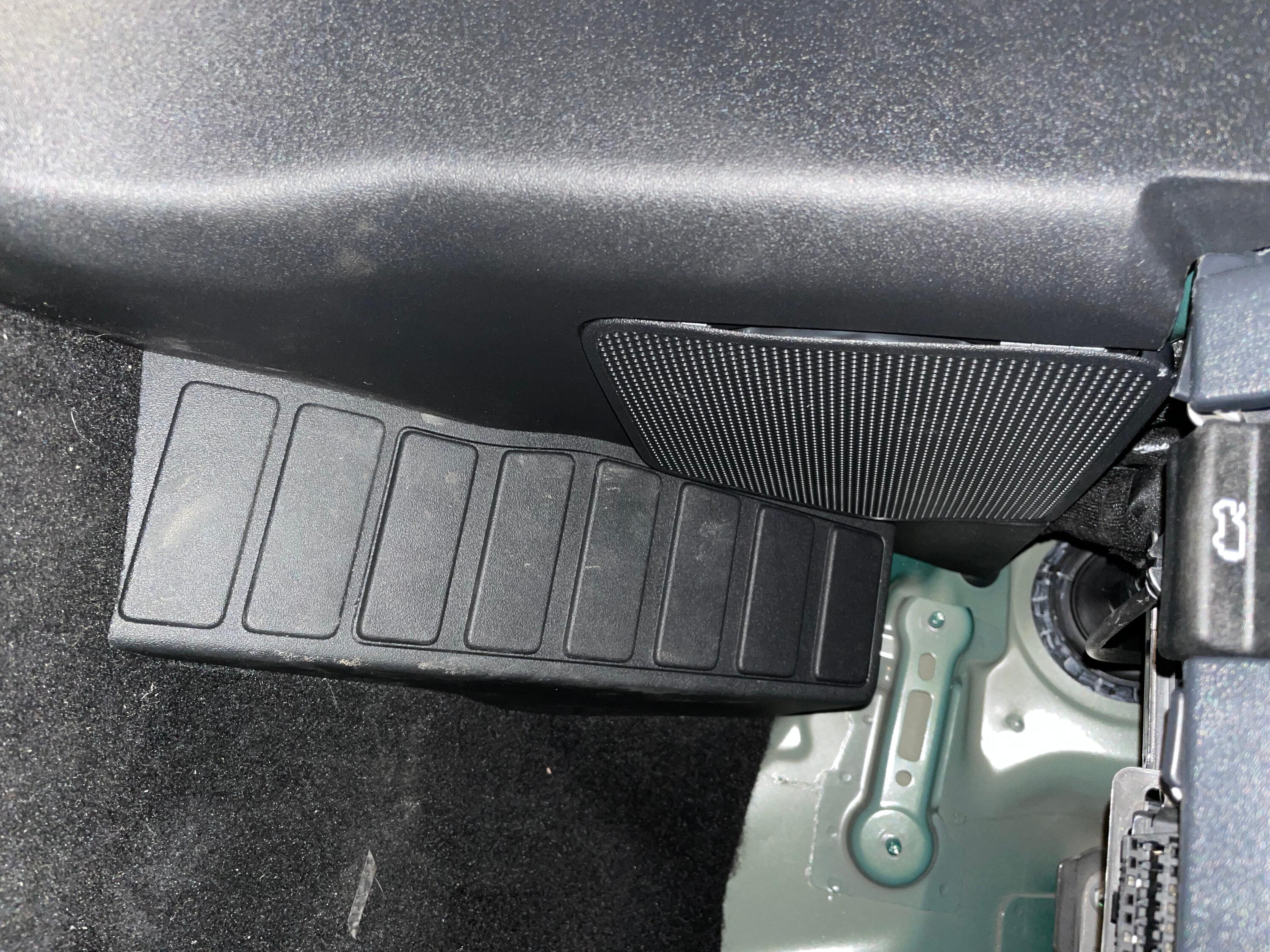

Are you sure you have the grill clips seated into the kick panel correctly? It looks like the speaker sits fine and the grill should clip in fine. Your bolts to mount speaker to bracket don't stick up any worse than mine.
Here is mine:
Ford Bronco Better Kick panel adapters than metra? PXL_20221104_170502578
And before install. My screws have hex heads so are a lil taller too.
Ford Bronco Better Kick panel adapters than metra? PXL_20221102_154658506

Yeah it looks like that just from how much its pushing against the speaker/Screws - there is a circle lip on the grill that its hitting on
