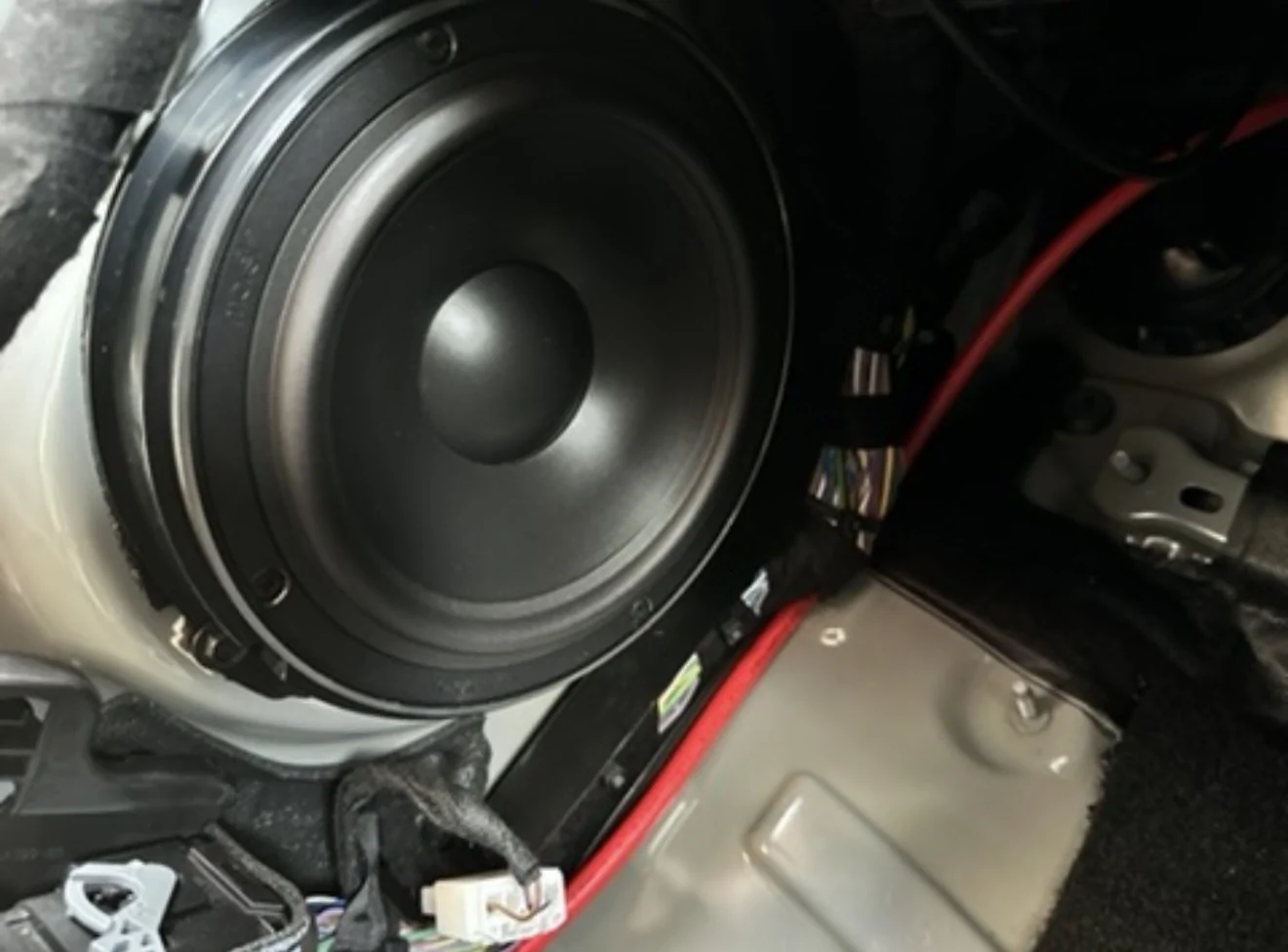

If you go with Morel Hybird MW6 MKII and build out the kick panel with deadening to make a seal you’ll be fine. Initially didn’t do that and so much air was leaking from the crappy foam piece ford puts in there. You can leave the foam but just use material on the inside to build out.
Ford Bronco Kick Panel Speakers IMG_0621
Ford Bronco Kick Panel Speakers IMG_0620
