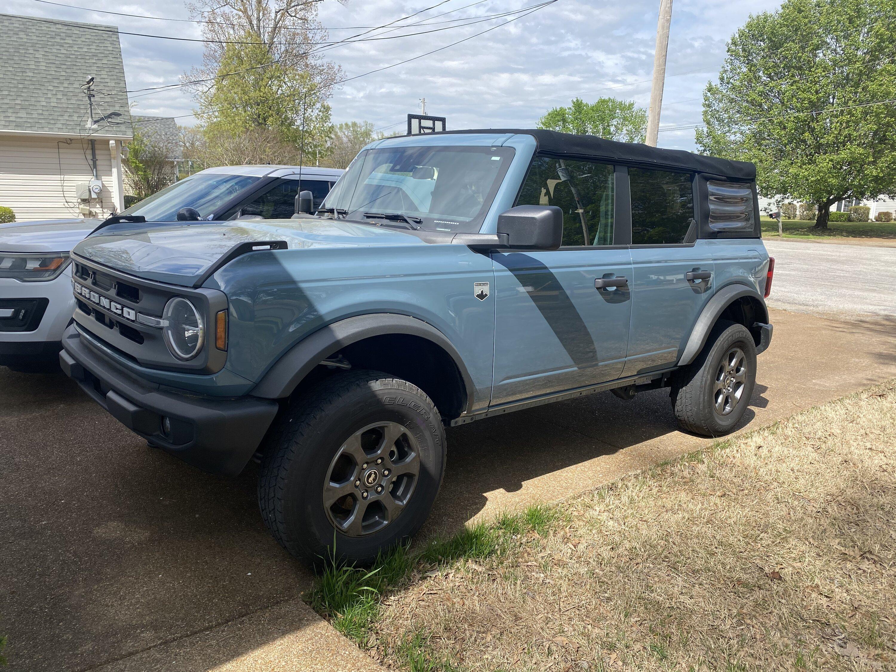

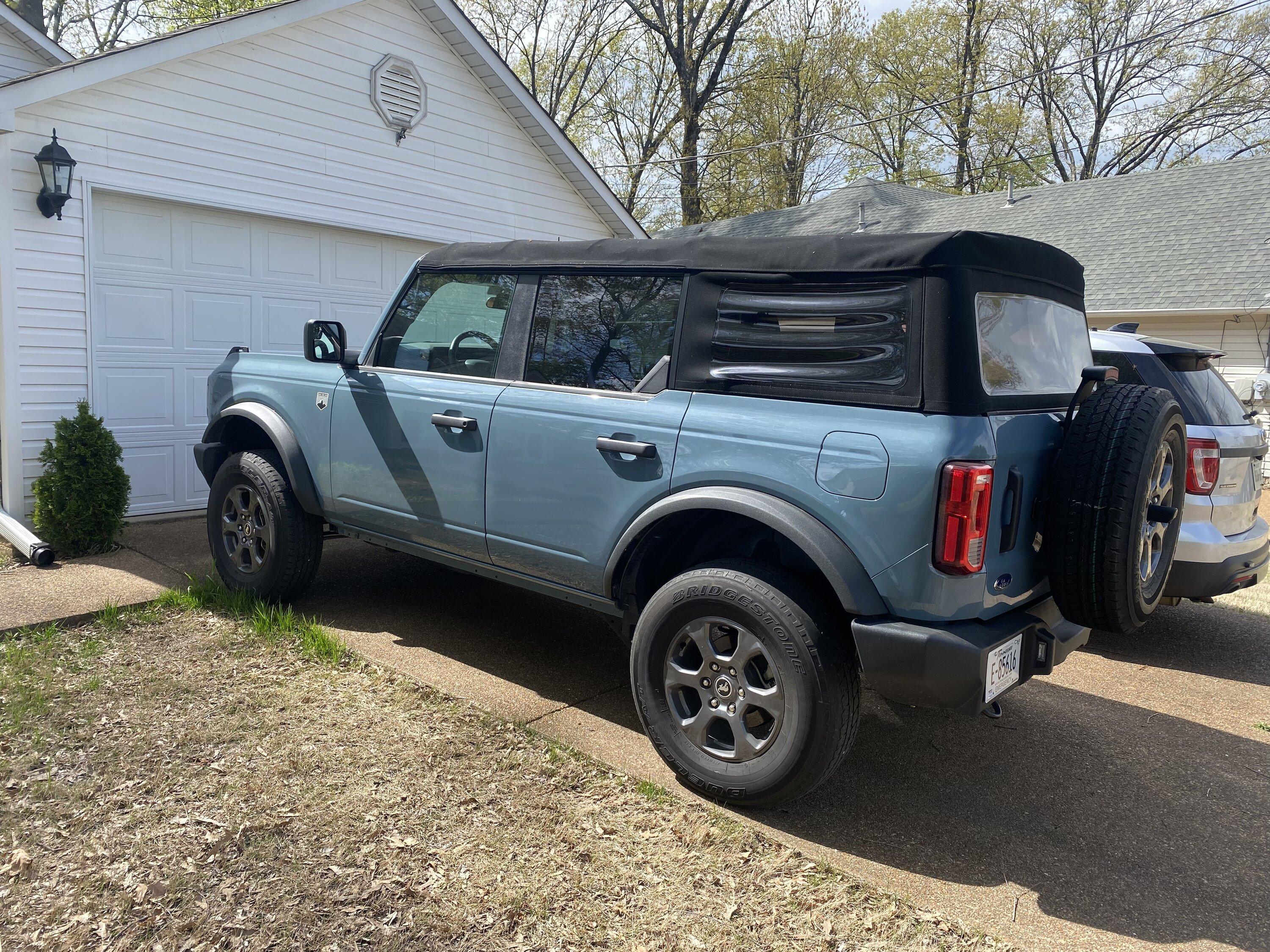

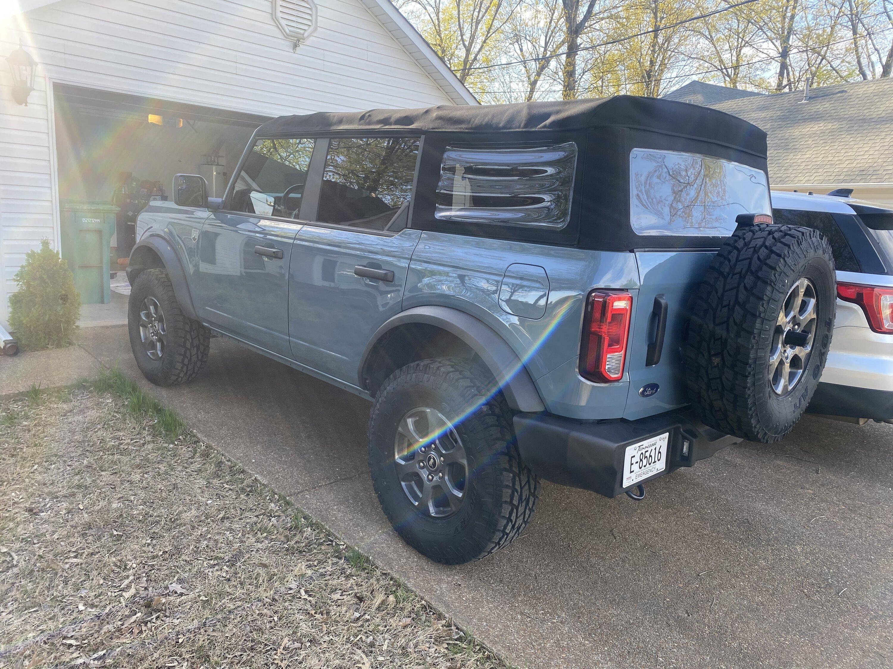

Figured I’d post pictures for everyone googling different options. I found a lot on this site that helped me research what I wanted.
Stock Big Bend wheels.
285/75r17
All I have on there is a Zone leveling kit.
Tires are Toyo AT II
I think if I went any bigger they wouldn’t fit on the center brake light where the spare goes. It’s like a perfect fit. This tire size is basically a 34x11.5
No rubbing or anything, fits great. Didn’t need to remove crash bar. Looks ever better in person. Pictures don’t do it justice.
Before

After

These are technically 33s but they are closer to 34s it’s like 33.84 or something. Rides fine. Won’t know about MPG until later. Haven’t had them long enough. This is just the standard 2.3 engine so I decided not to go with 35s due to the gearing issues. Some people say it’s fine some say nah don’t do it so I just went with the 33s. They look a lot bigger in person. If you want to go the safe route and not re gear this is probably the perfect tire size with the stock rims.

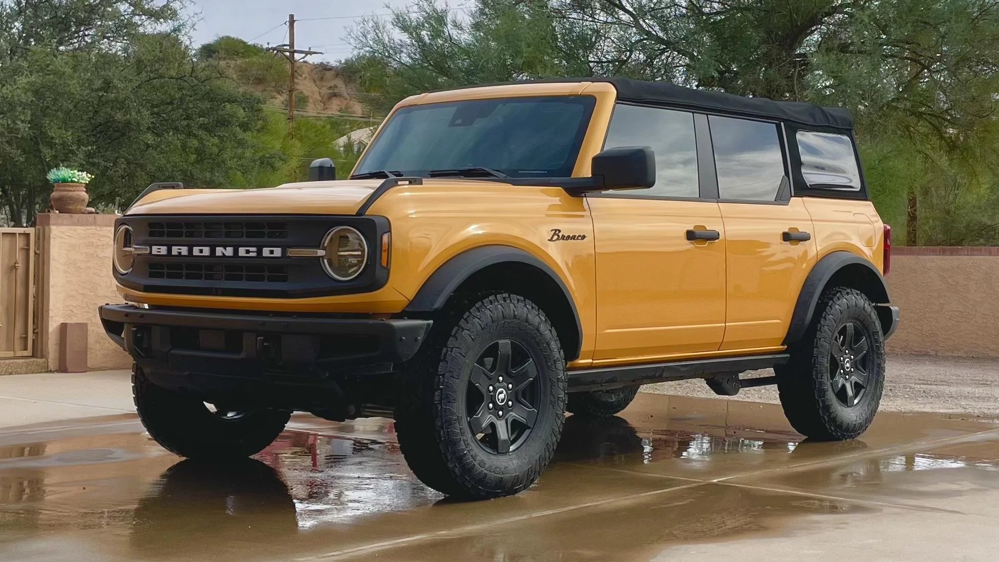

I agree.

Here’s mine…

I think if I were to go any larger on the stock rim, I wouldn’t go so far as a Sasquatch-size tire, but rather a 35/11.50. That would look great - but then you’re removing crash bars, and possibly compromising your gearing, speedo calibration, and clearance if you don’t have some kind of lift. Whereas the 285/75 works great without any of those changes…

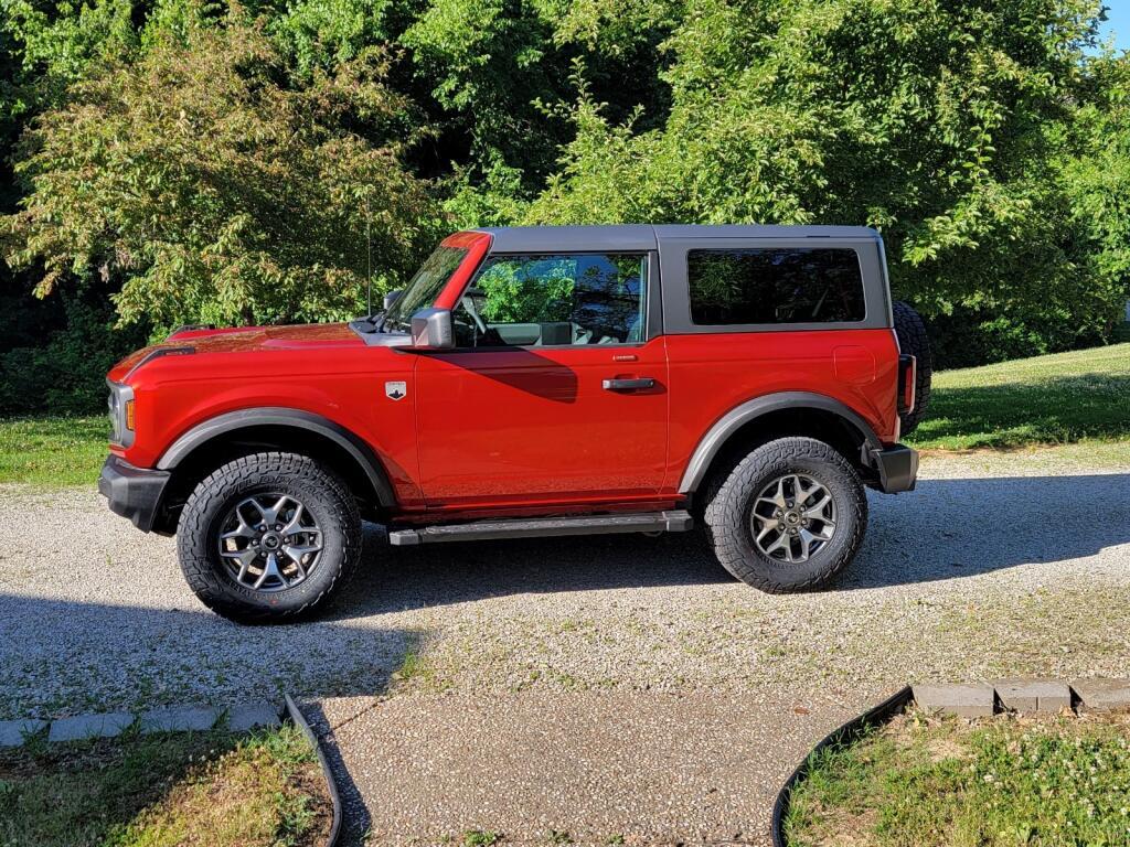

I changed my BB tires to 33's also , but I have a two door . and I used the OBX wheels cause I like them and were cheap to purchase ( don't know if ya'll will believe me but I got them @ $40 each from someone local that wanted them out of their garage , $200 total ) I still have the factory wheels in garage attic.

they look awesome, can you please provide the exact tire model?

Cooper Discovery AT3 XLT - 10ply - 275/70/18 comes with 60k mile warranty
they do ride smooth considering shorter wheel base , keep mine @ 36psi , balanced well , minimal road noise ( even my wife noticed )
