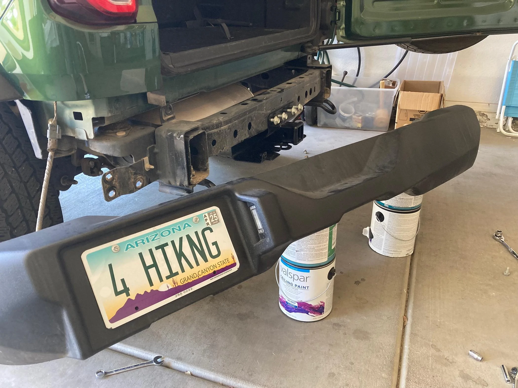

I'm going to remove my bumper tomorrow to install the Ford trailer hitch. I found a video from AIG on youtube and it looks pretty straight forward. However in the video the bumper they have doesn't have sensors. I have the Big Bend with the rear plastic bumper and it has sensors. I haven't had a chance to peak under there so I thought I'd ask if anyone has had trouble removing this bumper or if it is straight forward with another plug to unplug.
Any advice is appreciated.

Just finished up installing Ford hitch. The bumper with sensors had one additional wiring clip on the passenger side for the rear sensors. Otherwise this was exactly like the video.
Two easy wiring clips to unclip and 8 bolts. Crazy easy!

NEW HITCH and the parking sensor party.
So I self installed a new hitch for an upcoming trip. I squeezed the clips on the sensor harness but they were still kind of hard to release . I did the usual wiggle and they finally gave. Now I went to put them back in and NO BUENO. No click, and it threw the parking sensors every time I started the vehicle. Apparently not EVERY Bronco has these issues but some do.
The problem: Let's face it, you're upside down, the clips are in a hand cramp spot behind those fender well cut your palms up plastic liners and you can't even SEE everything you need to, because theres two different sets of male pins on each plug that go in differently and ya don't want to bend those by forcing them. . Besides, theres just enough play there the way its mounted to kind of send things in a bad direction if you push too hard.
1. I removed the harness from the mount and pulled it gently over the top of the bumper where i could SEE EVERYTHING in the light .
2. I checked for dirt, debris, bent pins, malformed gaskets, plastic housing or other f-ery.
3. I blew some compressed air in there anyway just to be sure because SOMETHING was causing that clip not to go over the catch. That didnt do it.
4. The plastic housing was slightly mis-shapenso I squeezed that a little but that didnt do it .
5. No pins were bent and thngs lined up the way they should.
6. I sprayed some pam cooking spray not only on the insides of the housing but the outsides of the male end of the plug.
7. I visually aligned things perfectly but also started kind of at a slight angle to make sure the pins actually entered the holes properly first, and slowly.
8. I pressed on the tabs to release the catch inward as much as possible and STILL had to press really firmly to get that plug to catch.
Outcome: My problem is solved . My alarms are no longer sounding and all seems functional and well. I do have some concerns about this plug breaking for people.
