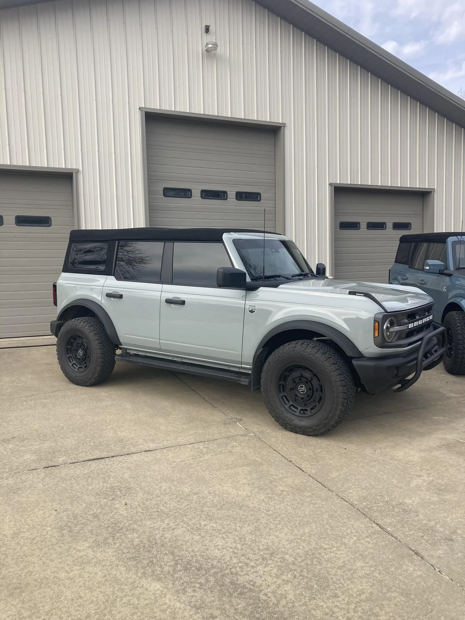

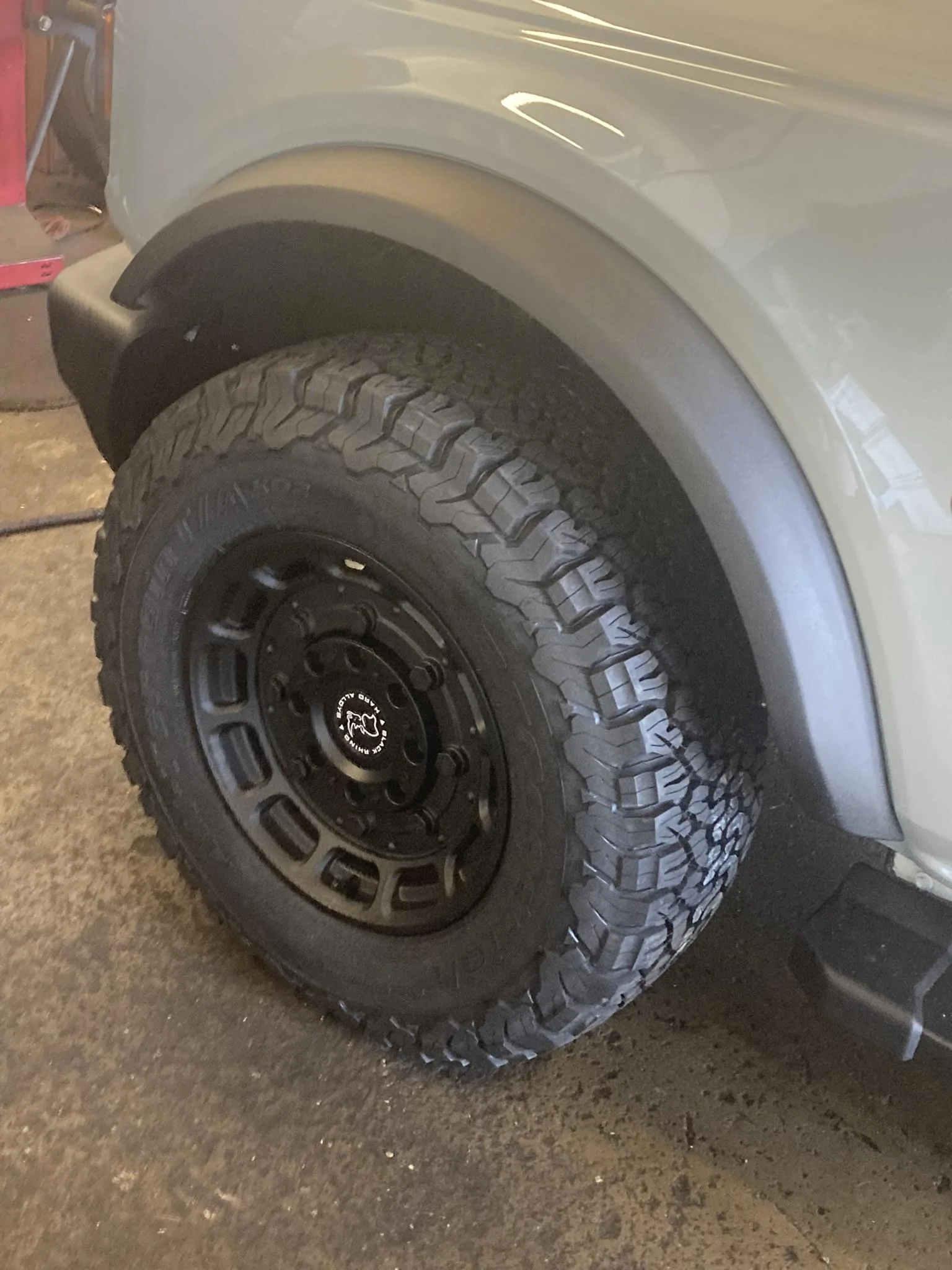

I went with a 295/70R17 in BF Goodrich AT KO2. 33.3 inch diameter 11.8 wide with 0 offset Black Rhino WARTHOG WHEELS. Had to remove rear crash bar and push front crash bar forward. The dealer found there is play in that front crash bar, loosened the bolts, pushed them forward and retightened. I have done same set up on BB and OBX models. Slight rub at hard turn backing up only. Factory flares still work great. Almost 0 splash. Tire sticks out about 2.5 inches beyond flare. Did put front mud flaps on BB not on OBX. No difference in splash.
