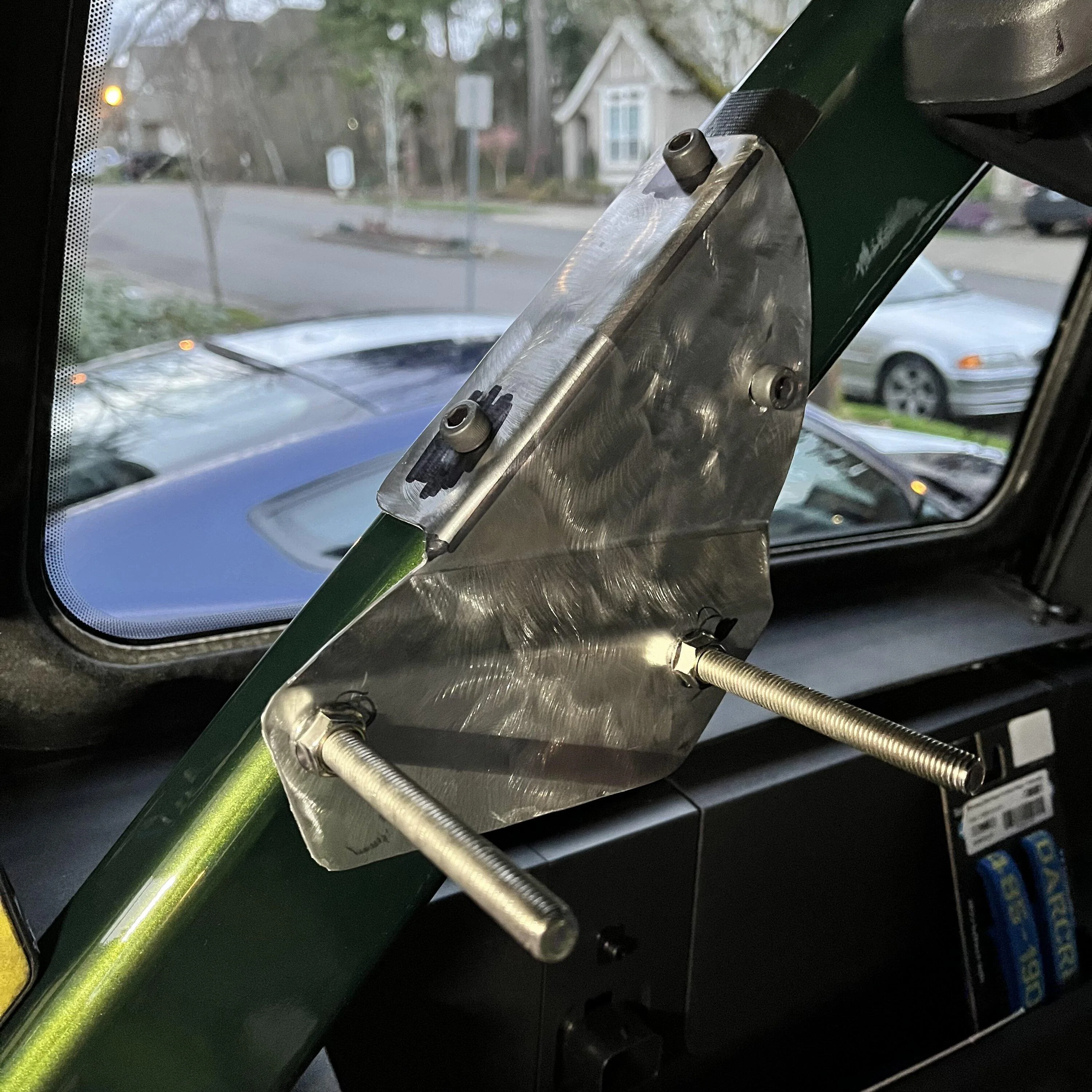

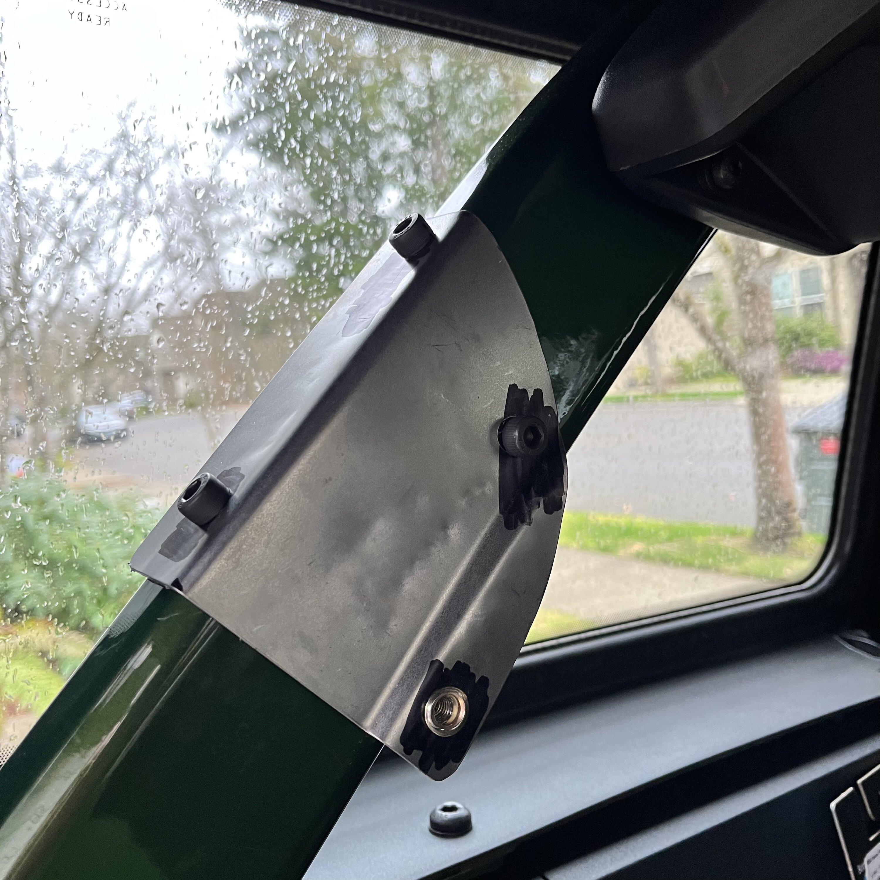

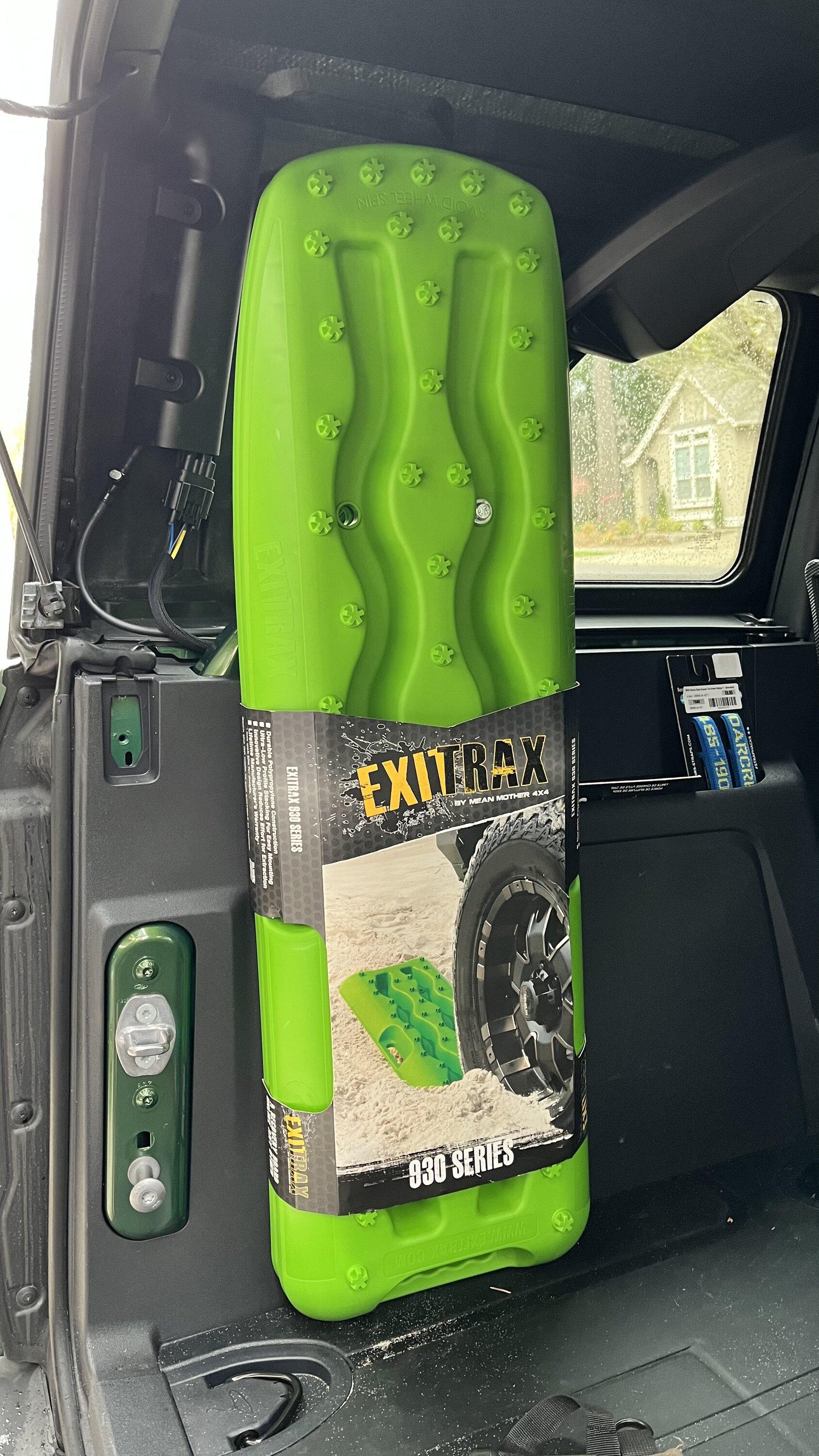

I’m trying to keep the external attachment to a minimum so I opted for the Exitrax 930, which are their shortest boards. From what I can tell the Exitrax are very well made Australian boards, not some cheap stuff off eBay. I’m sure someone will correct me on this.
I’m going to have a fridge on the passenger side so I looked at how to mount the boards to the opposite side.
I’d call this of a prototype as there are some things I’d change. I might make the bracket wider and use both mounting holes on the board. I need to see how much they rattle. I’m also using 22 gauge steel which is about as much as my power shears can handle.
I believe the Exitrax use the same mounting as Maxtrax so I may look at that solution. Right now I just have a bolt and some spacers.

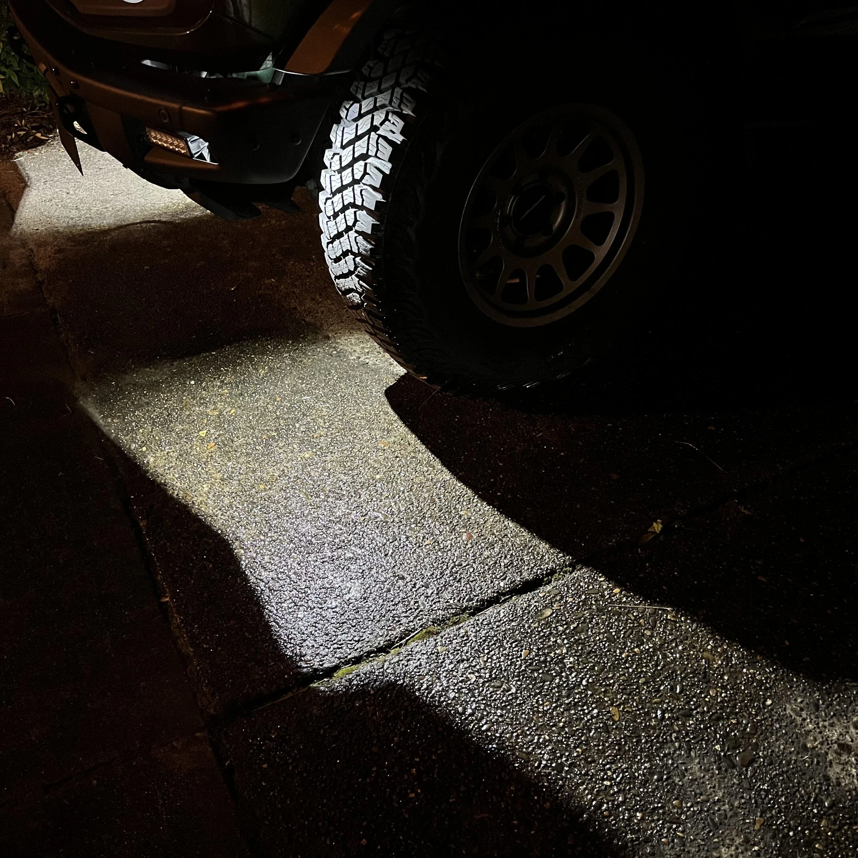

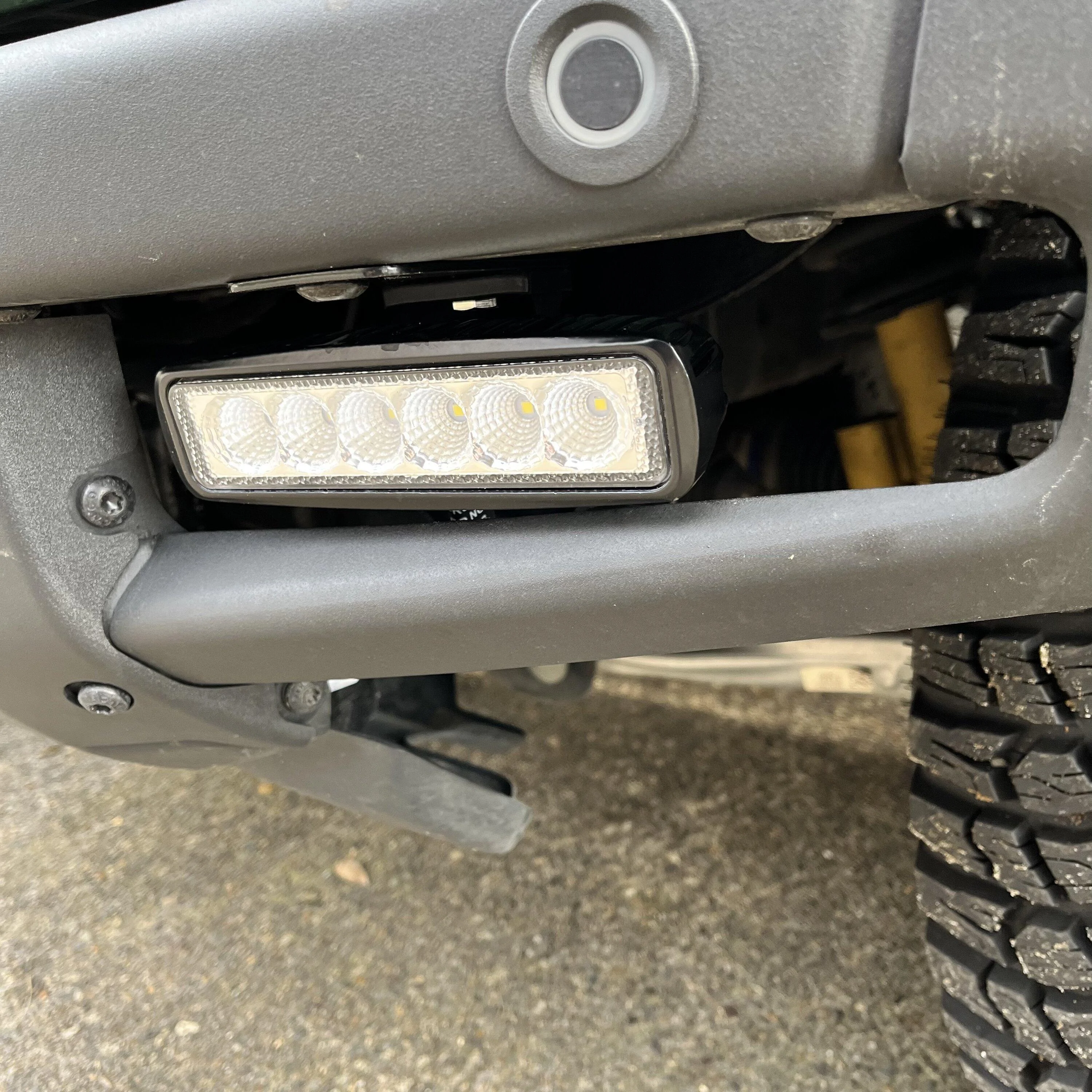

Got my driving lights installed today. Sure I’ve got some cheap lights but dang, they are bright! Next will be the rock lights. Then I might be done with lights. Might.

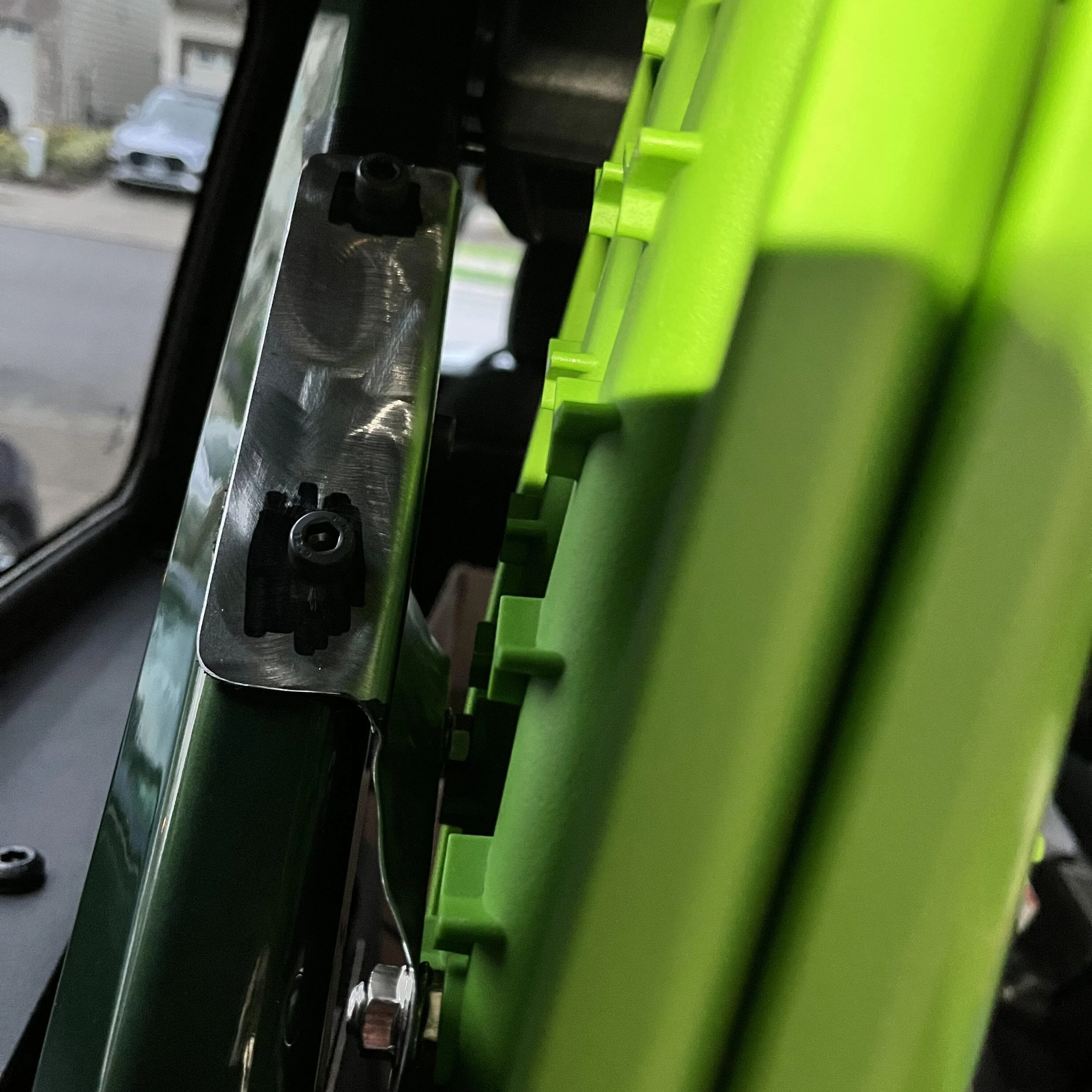

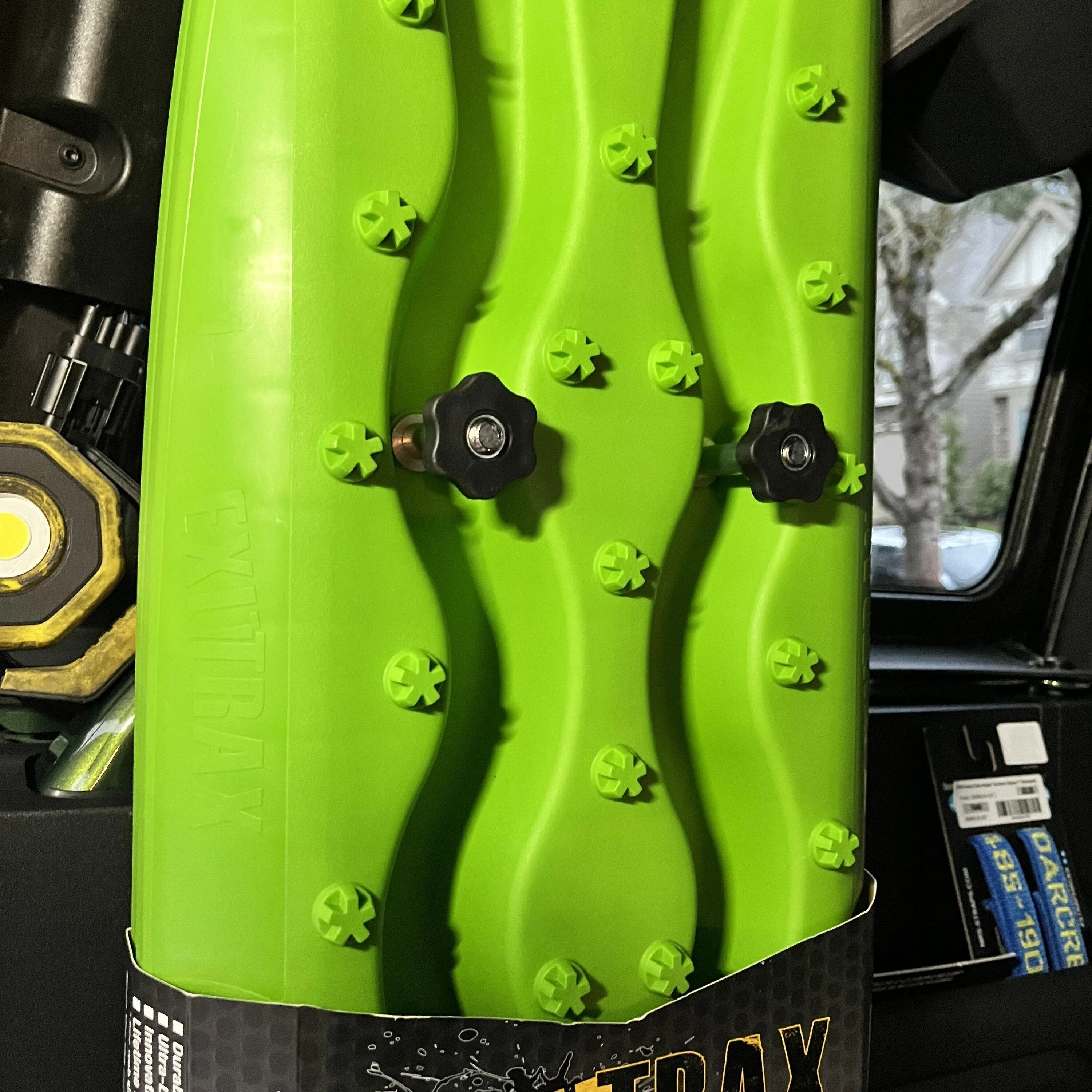

Version 2. Bought some mounting screws for Maxtrax. They don’t really work well with the Exitrax but I made them work. The single bolt was probably plenty sturdy enough. I never heard the boards even rattle. I think the last change I’d make is to the spacer on the bolts. And maybe paint the bracket black.

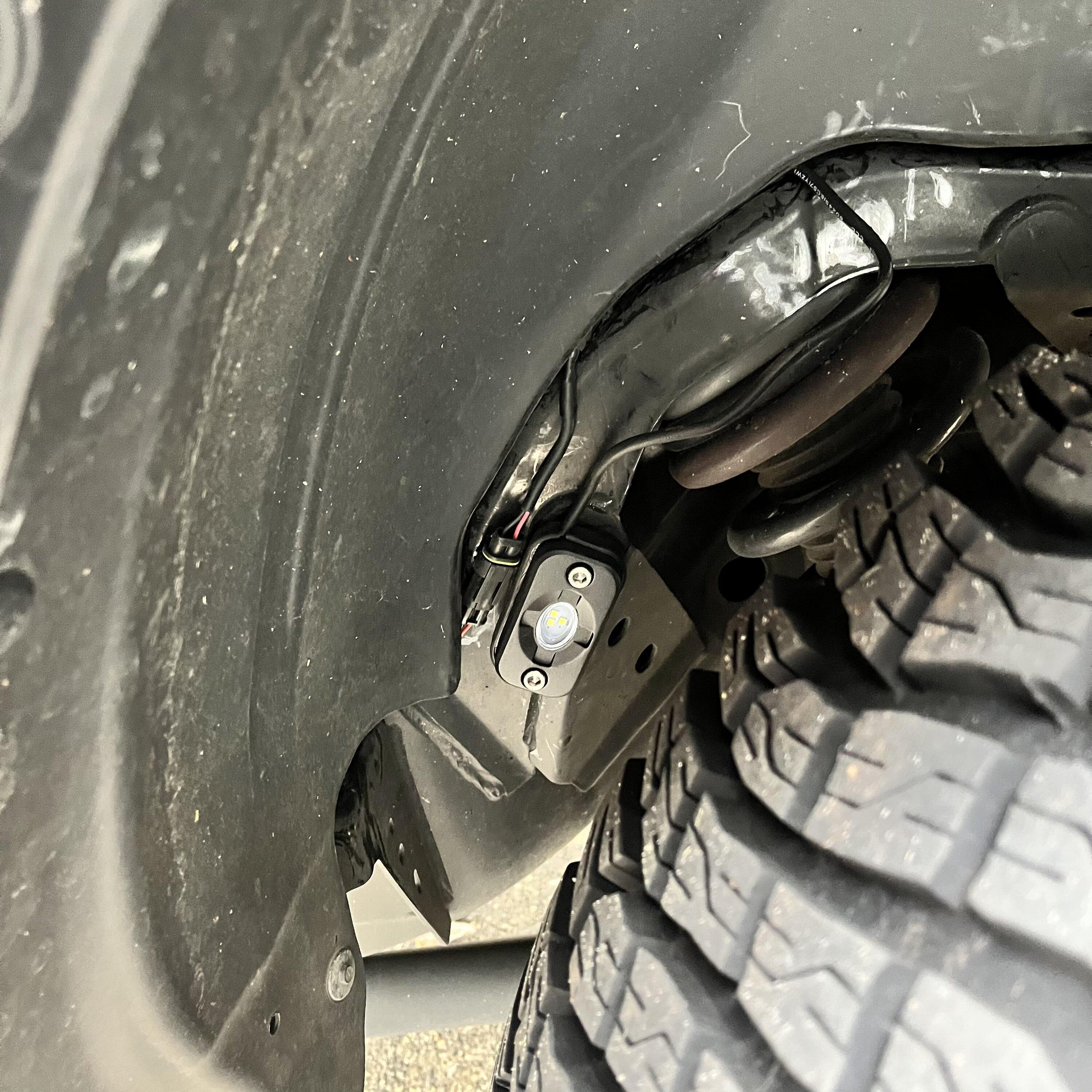

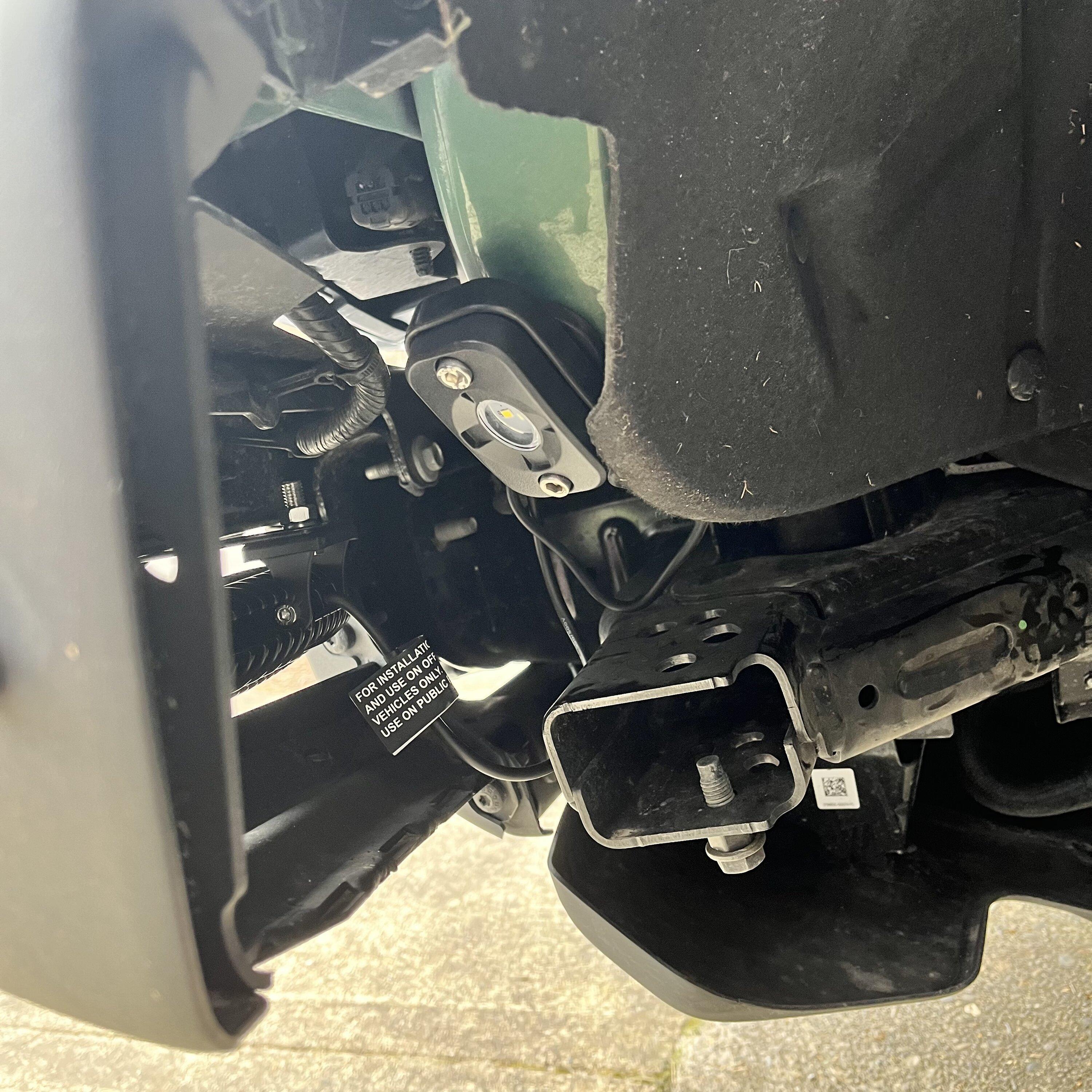

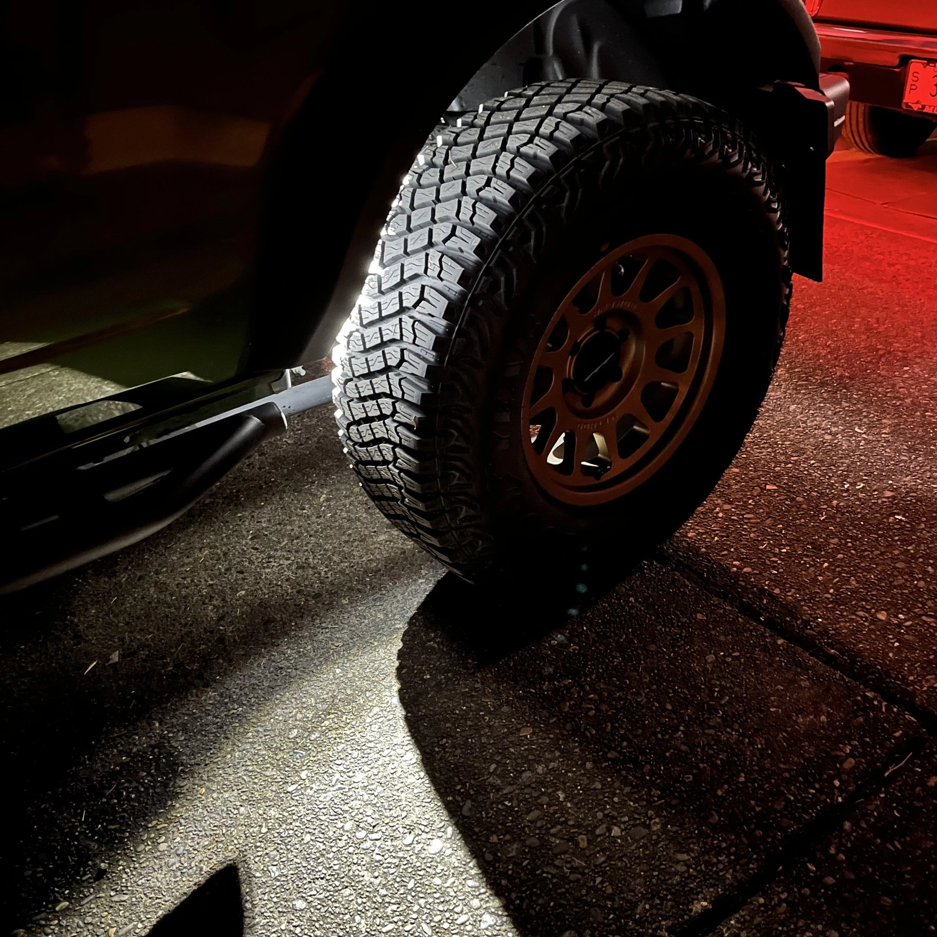

Welp, finally finished the rock lights. Took me about the whole day. Glad I’m not making a living installing this stuff. But I’m taking a lot of care tucking the wiring and such. Because I have magnets on the lights I can tune the location assuming there’s steel.
