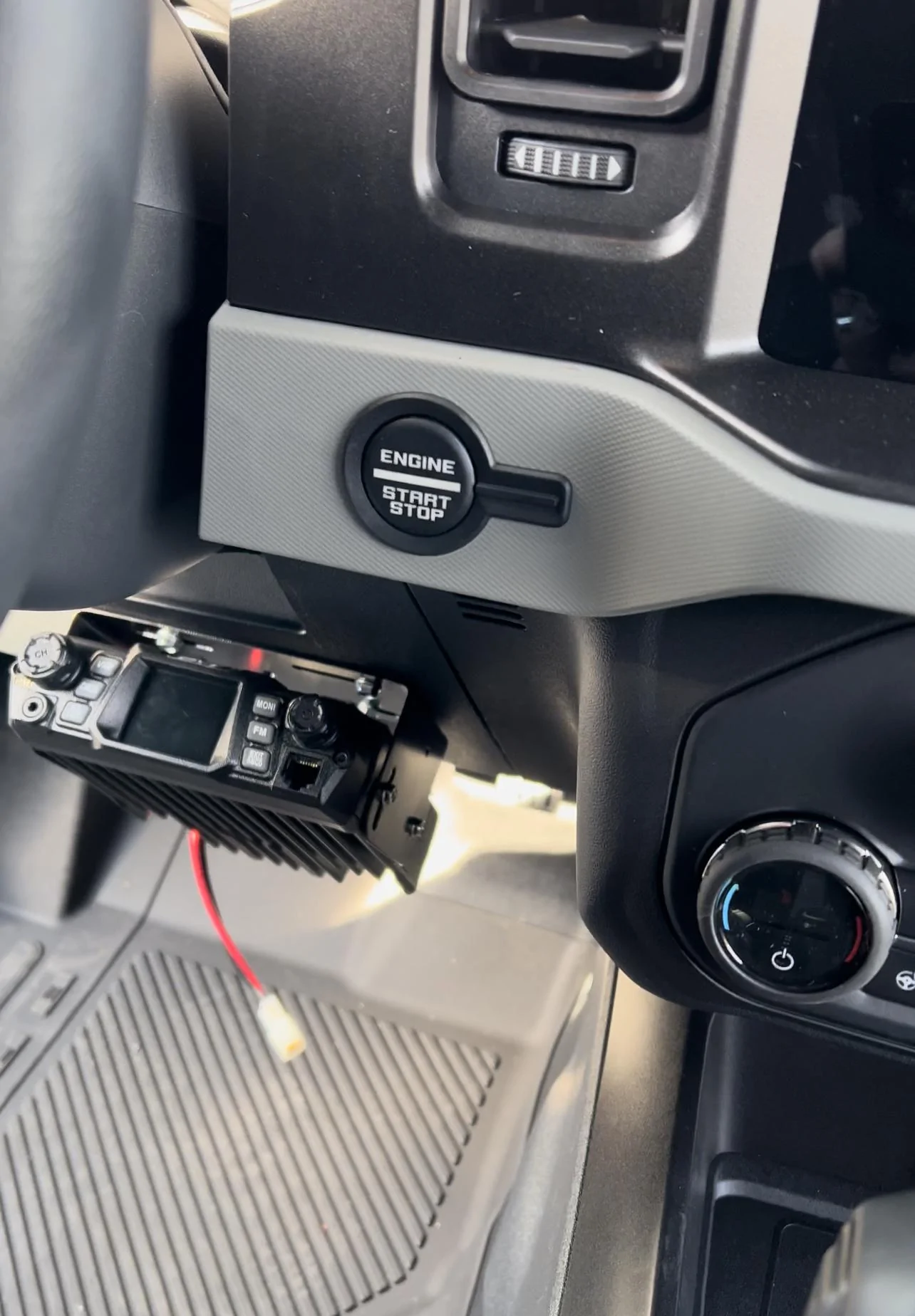

Just wrapped up installing a VHF. Figure this could be helpful regardless of what kind of radio you run.
I decided to mount the radio just below the steering wheel via self tapping screws. I have usually mounted my radios in the center console but it would have been a PIA to run wiring into it so I opted for this. I like the easy access and it eliminates the need for a auxiliary speaker.
I'm 6'4" and my knees don't make contact at all with the radio.

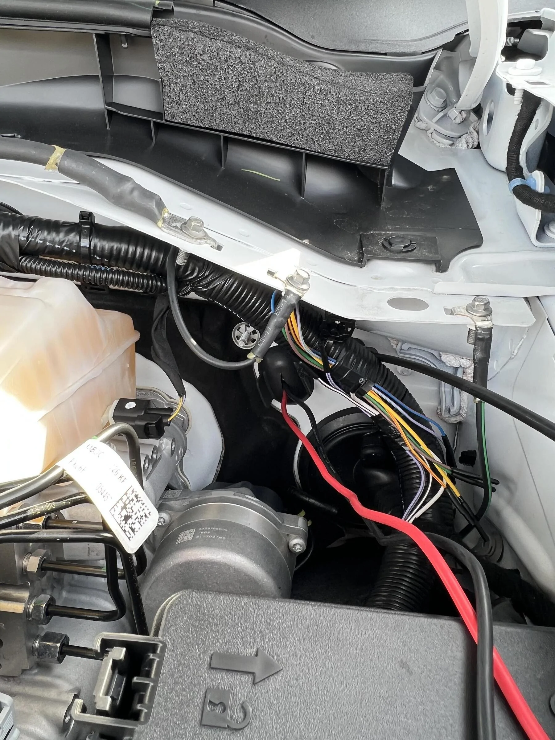

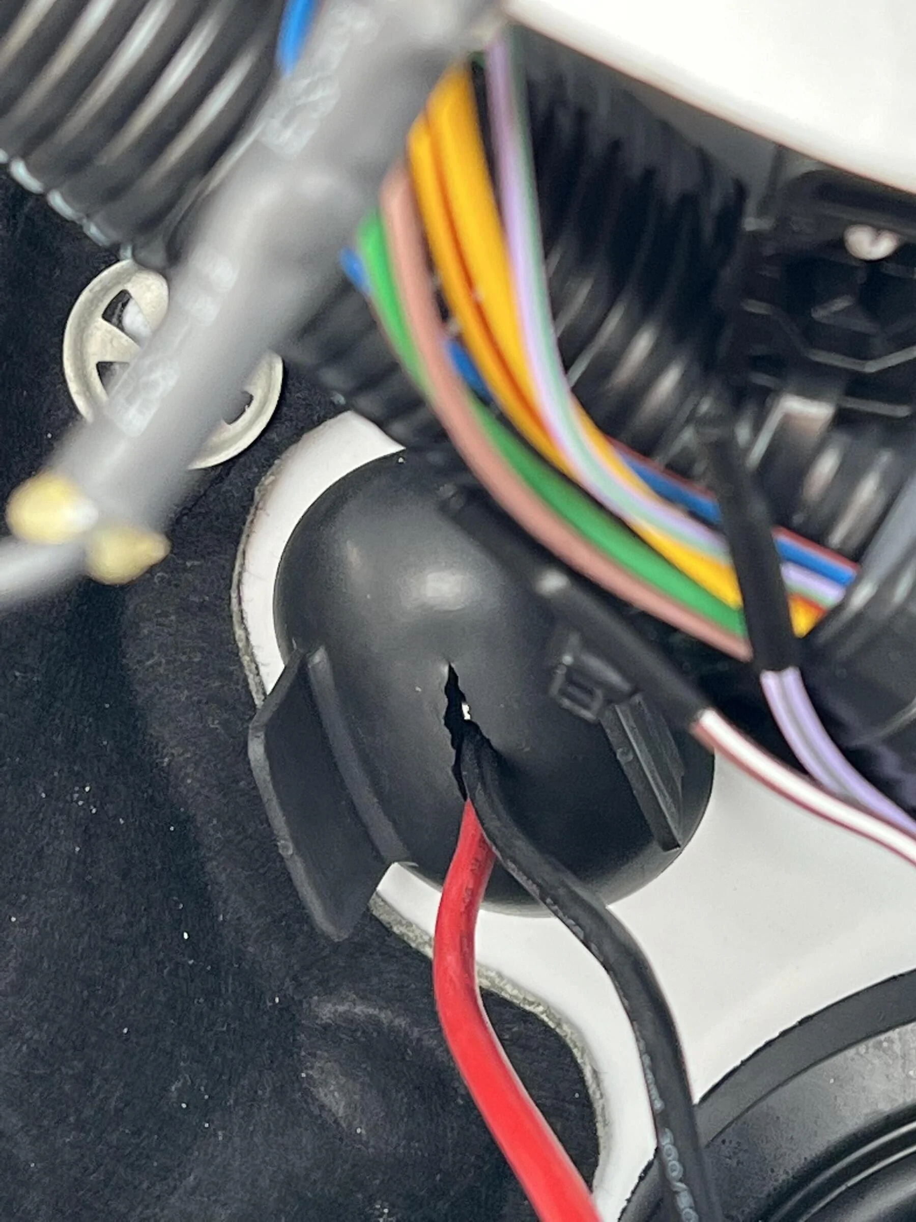

I ran the power through a perfectly placed existing bung in the firewall. I just cut a slit and ran the cord through. I wired direct to the battery.

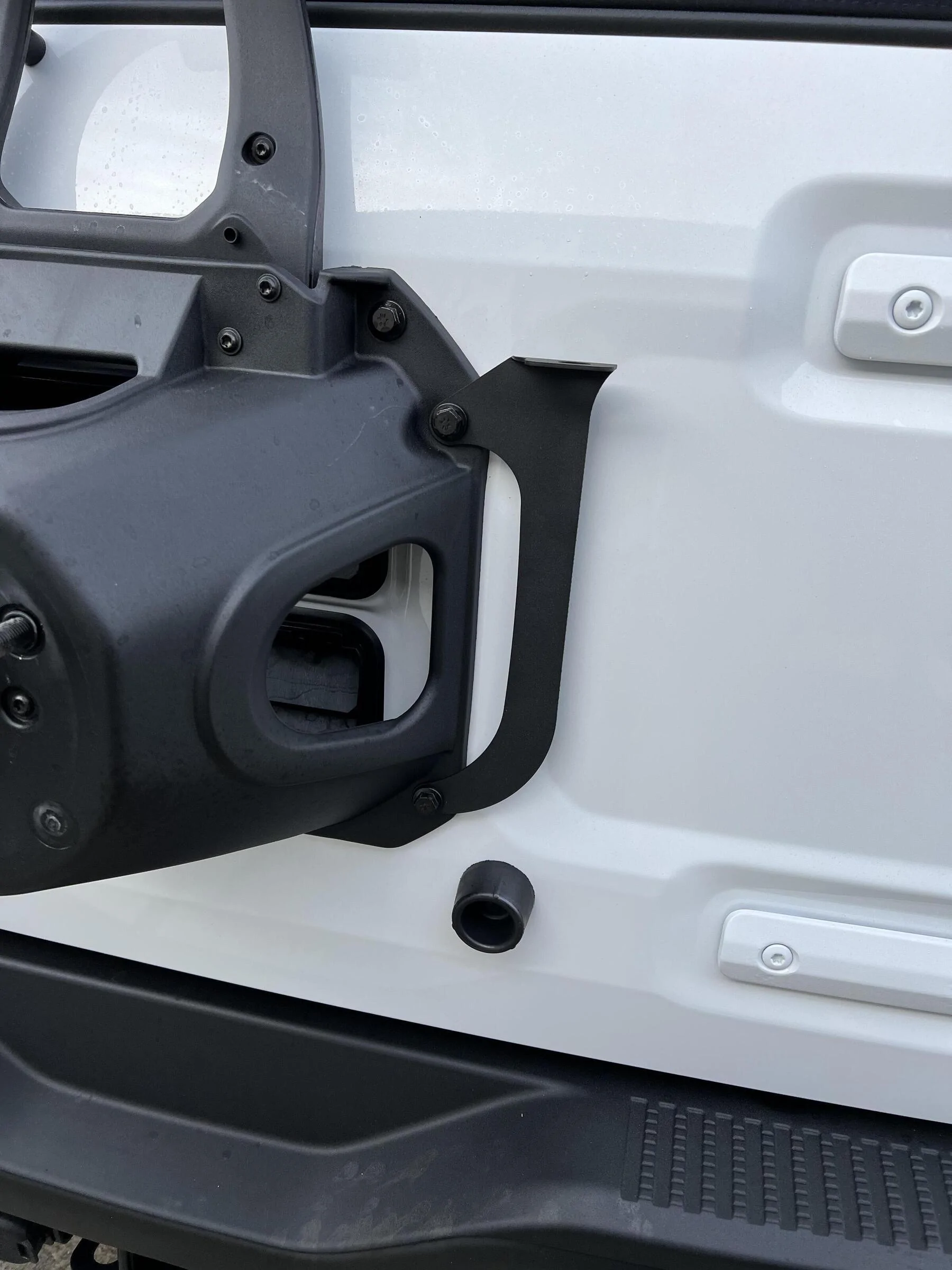

I picked up this Jeep spare tire antenna mount with the intent to modify it but it was a perfect fit. I guess Ford probably uses the same supplier as Jeep for the tire mounts. Antenna mount - Amazon

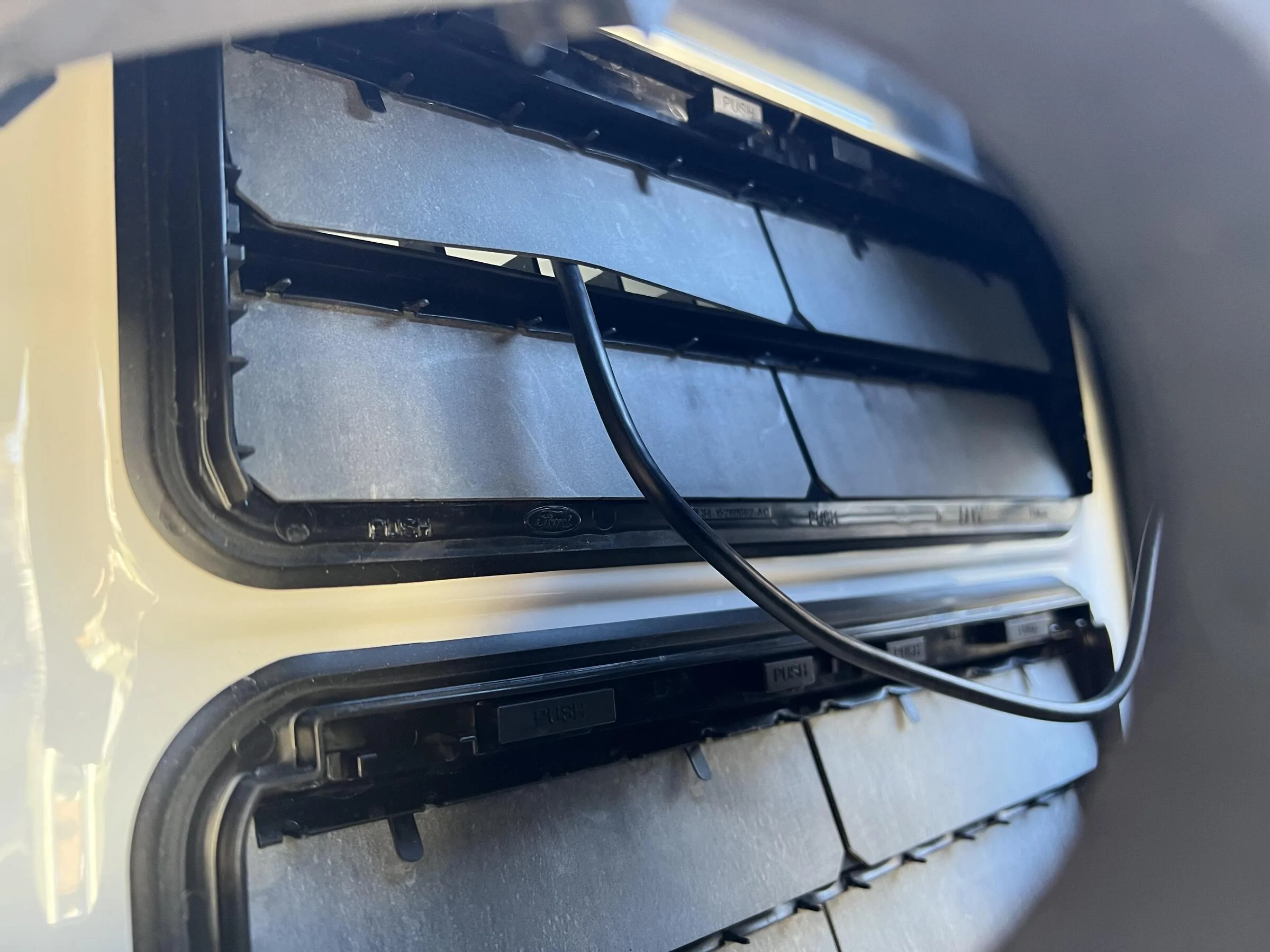

I routed the coax through the vents behind the spare tire.

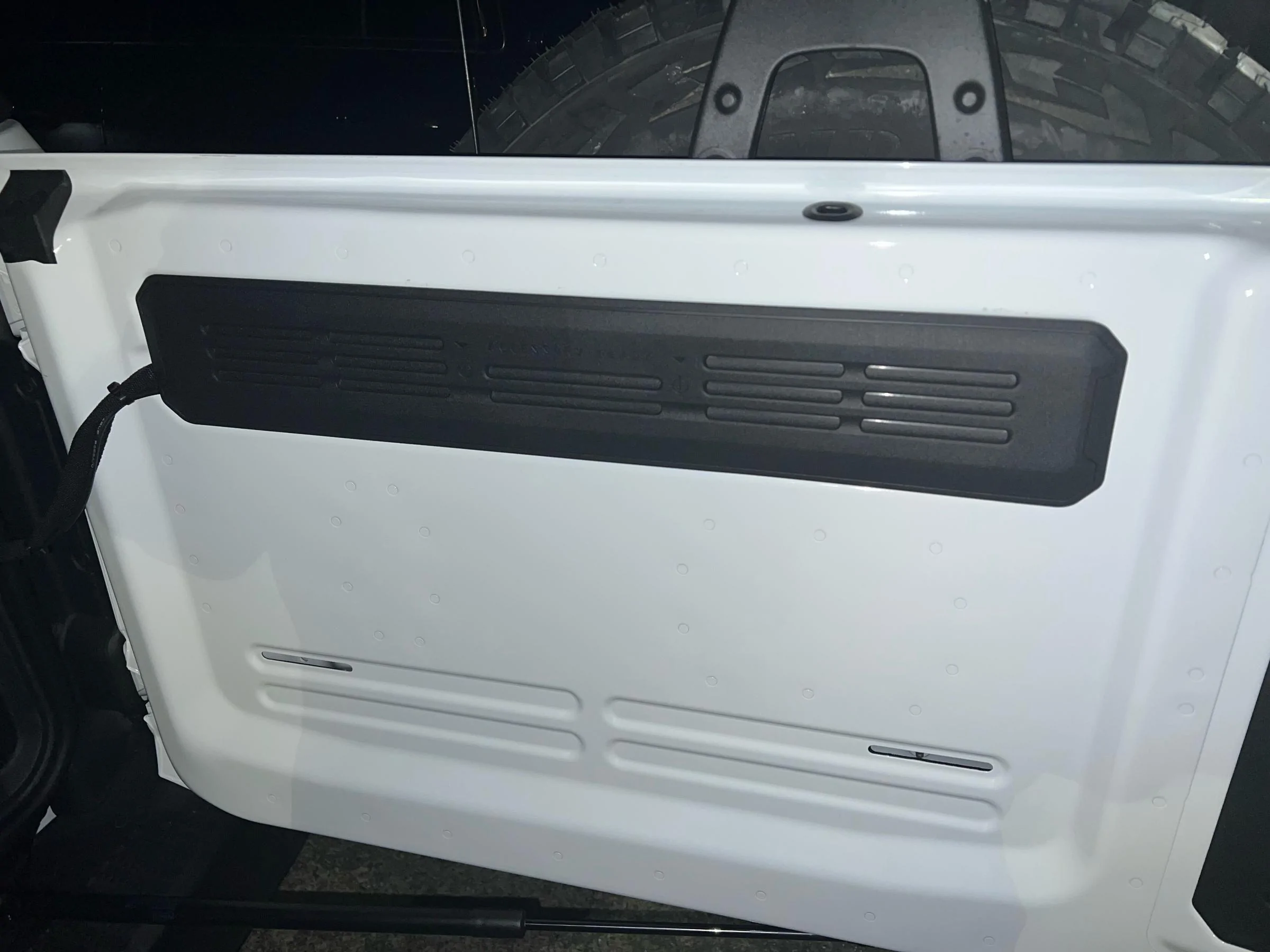

I then popped the plastic piece below off to access the coax and pull it through.

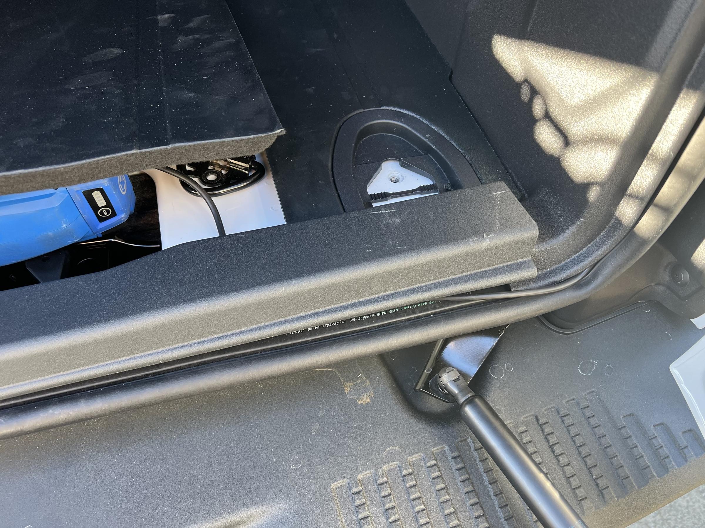

If you remove the bolts holding the tie down points down, the rubber flooring can be pulled up easily. I ran the coax under that along the side to the rear seats. I then ran it in between the single seat and double to the floor. I was lazy and just ran it on the floor under the mat. I figure you'd never know it's there. I would have used the door trim but 17' wasn't long enough to take that route.
Ford Bronco {thread} {filename}
From there I ran it under this piece of the center console.
I backed out the bolt located below to run the cord up above it. It also keeps the coax from coming down.

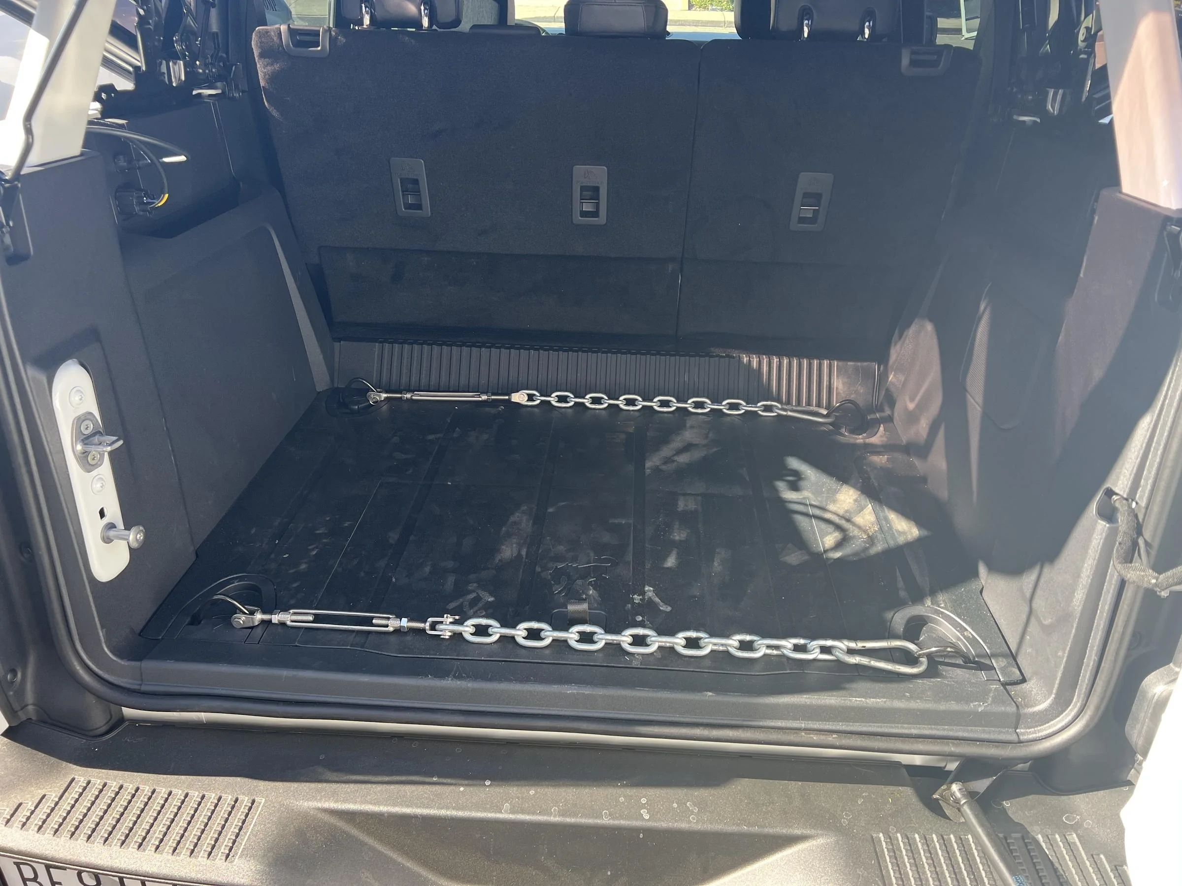

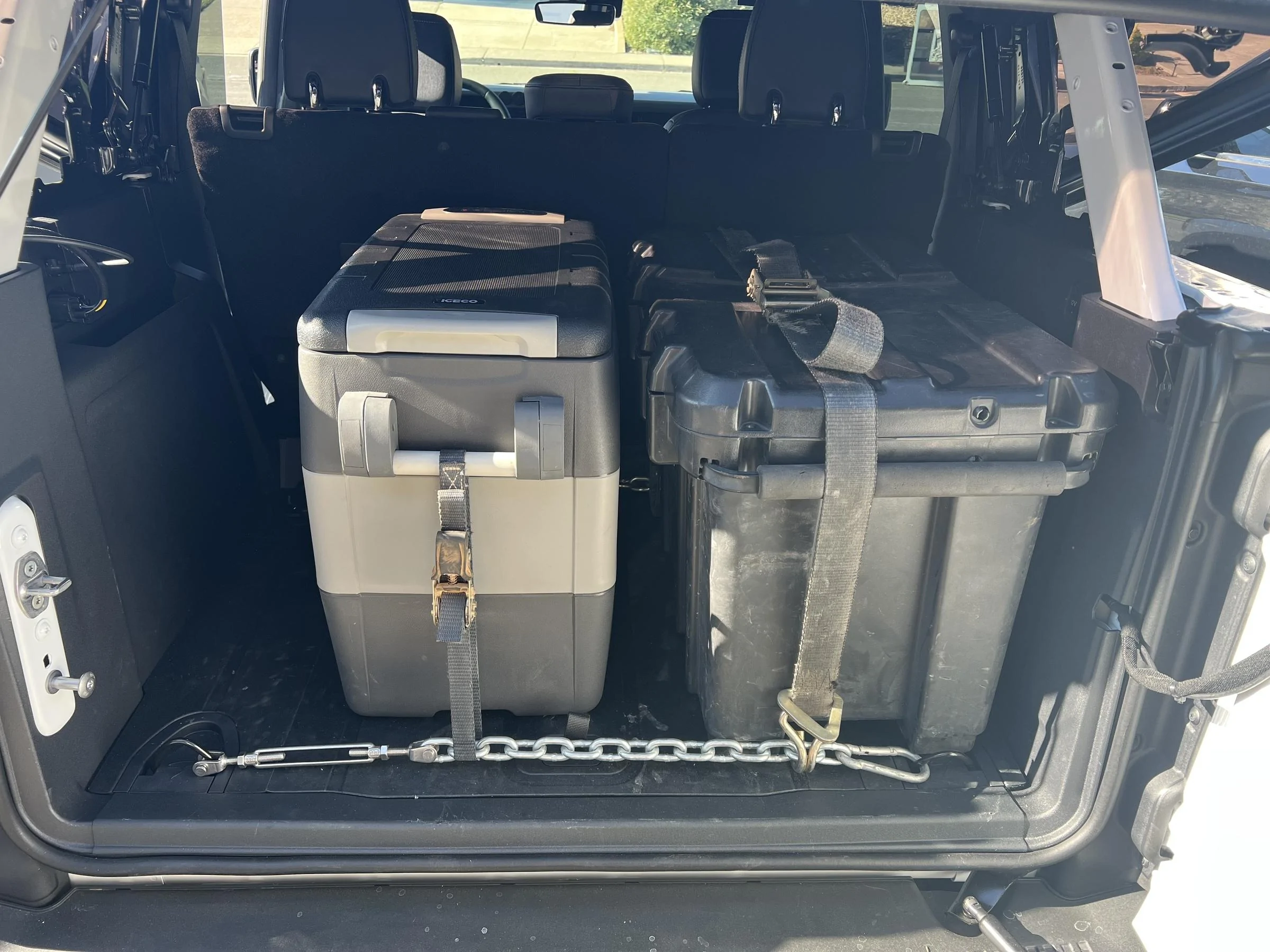

I decided to go with this setup for now. I've used a chain setup like this in my trucks for years with great success. I think all in, I spent $25 on the turnbuckles and chain. It's pretty handy to have the additional tie down options.
Ford Bronco Big50's Badlands build kC5mkse
Ford Bronco Big50's Badlands build EdehoIn
