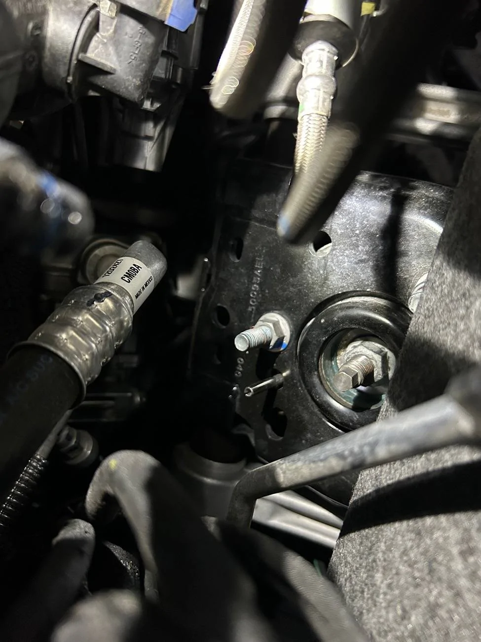

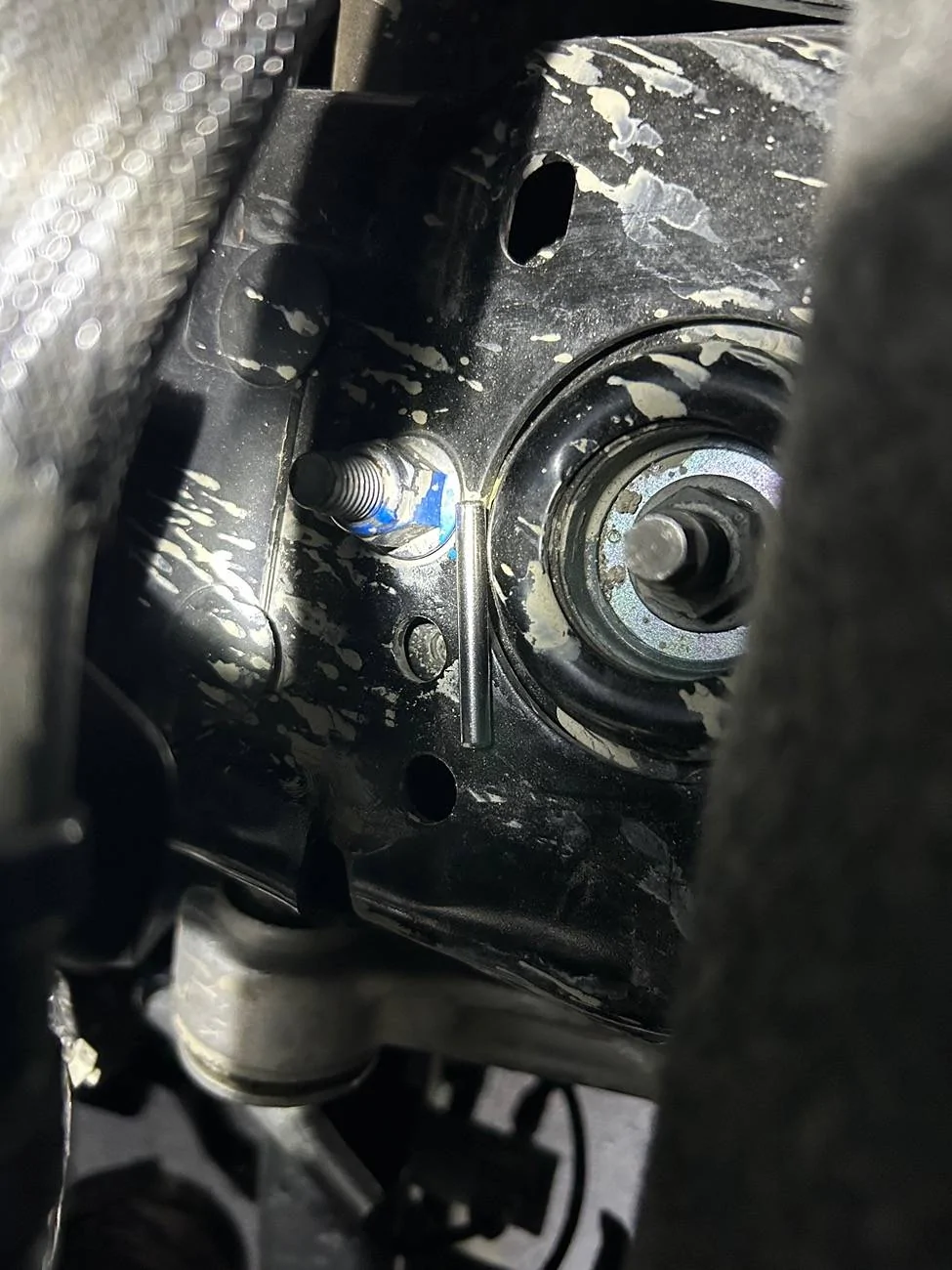

Passenger side still sits higher after couple thousand miles. Looked at front shock to check and make sure things were still torqued. ** when brought home after initial install one shock nut was hand tight. They checked everything out torqued and said let shocks settle. Mistakes happen and very reputable shop.** Anyways this alignment pin pulled right out this evening. None of others are loose. Long story short could this shock be spun the wrong way and why it’s little higher? Why would pin just come out? Something seems off from when installer installed.

Those pins will come out quite easily so don't worry about that. My drivers side is 3/8" inch high, on my 5100 install, but not noticeable without measurement. Other than that idk.

Cool. Thank you.
