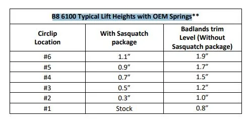

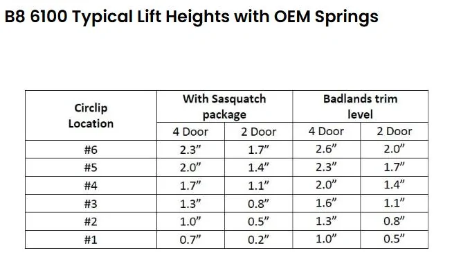

Can someone tell me which lift chart is correct? One is from the Bilstein Website and the other from a shock supplier website. I'll be using the strut with factory SAS springs.

The lower amount of lift are correct. Bilstein changed what they originally put out.
