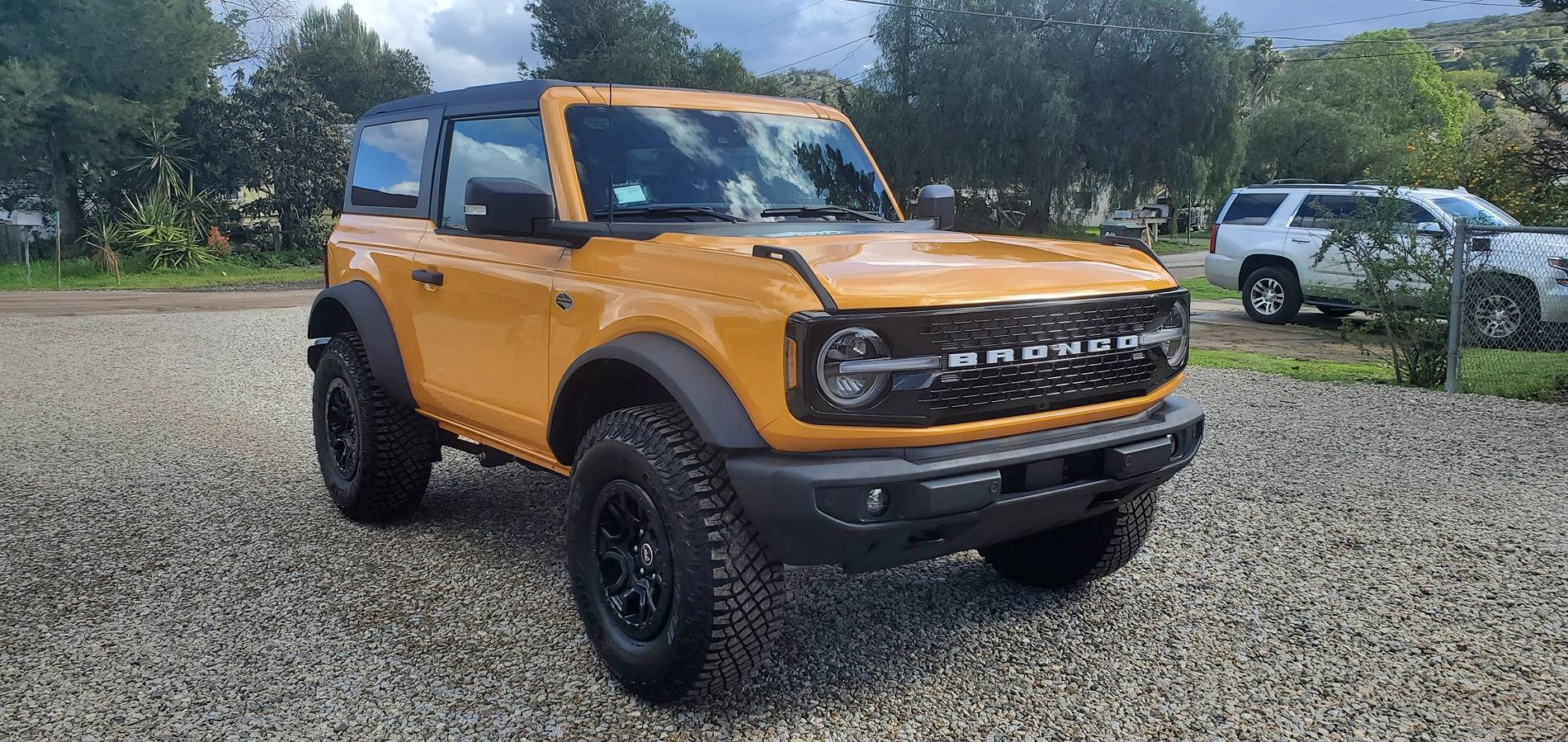

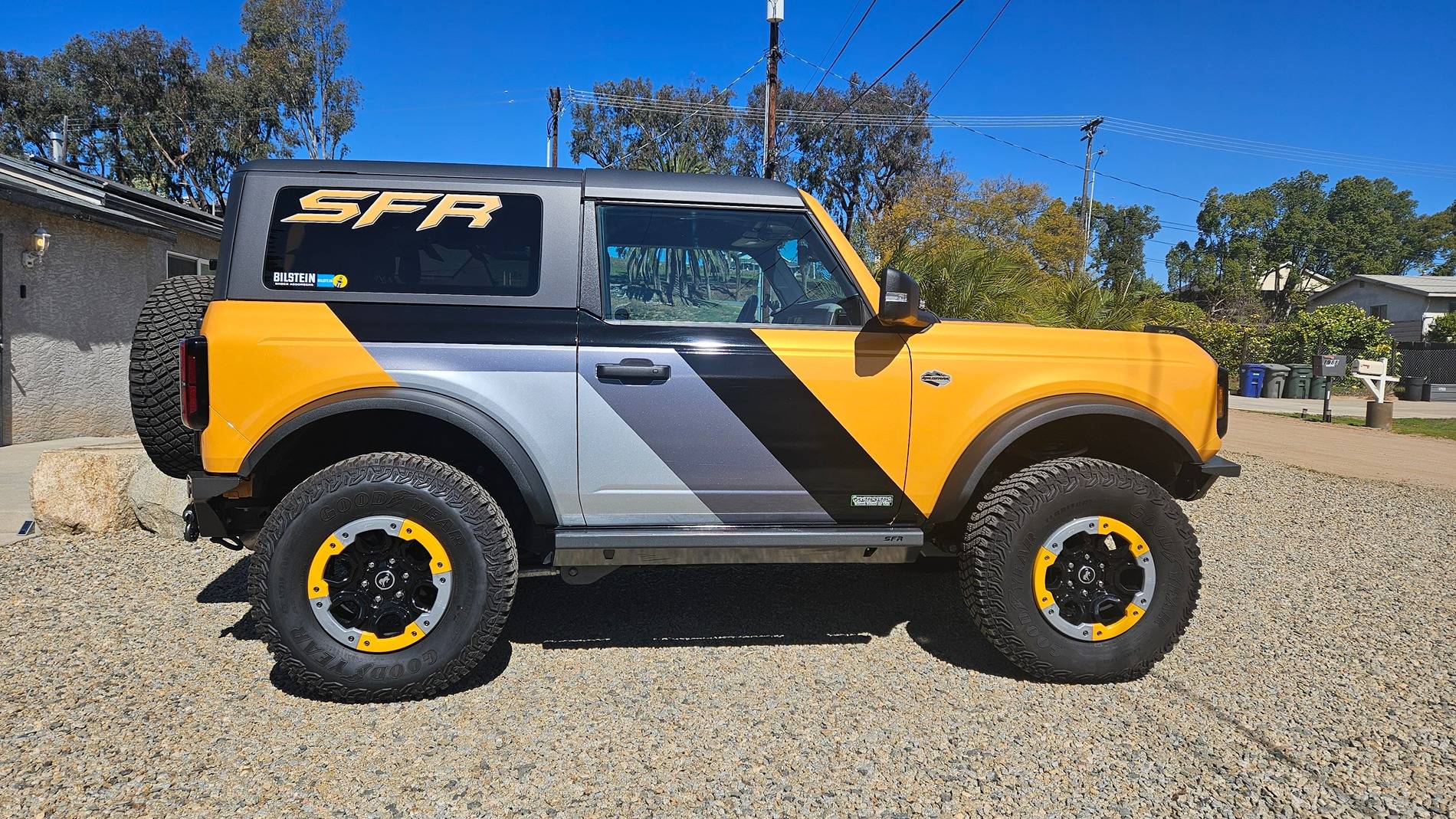

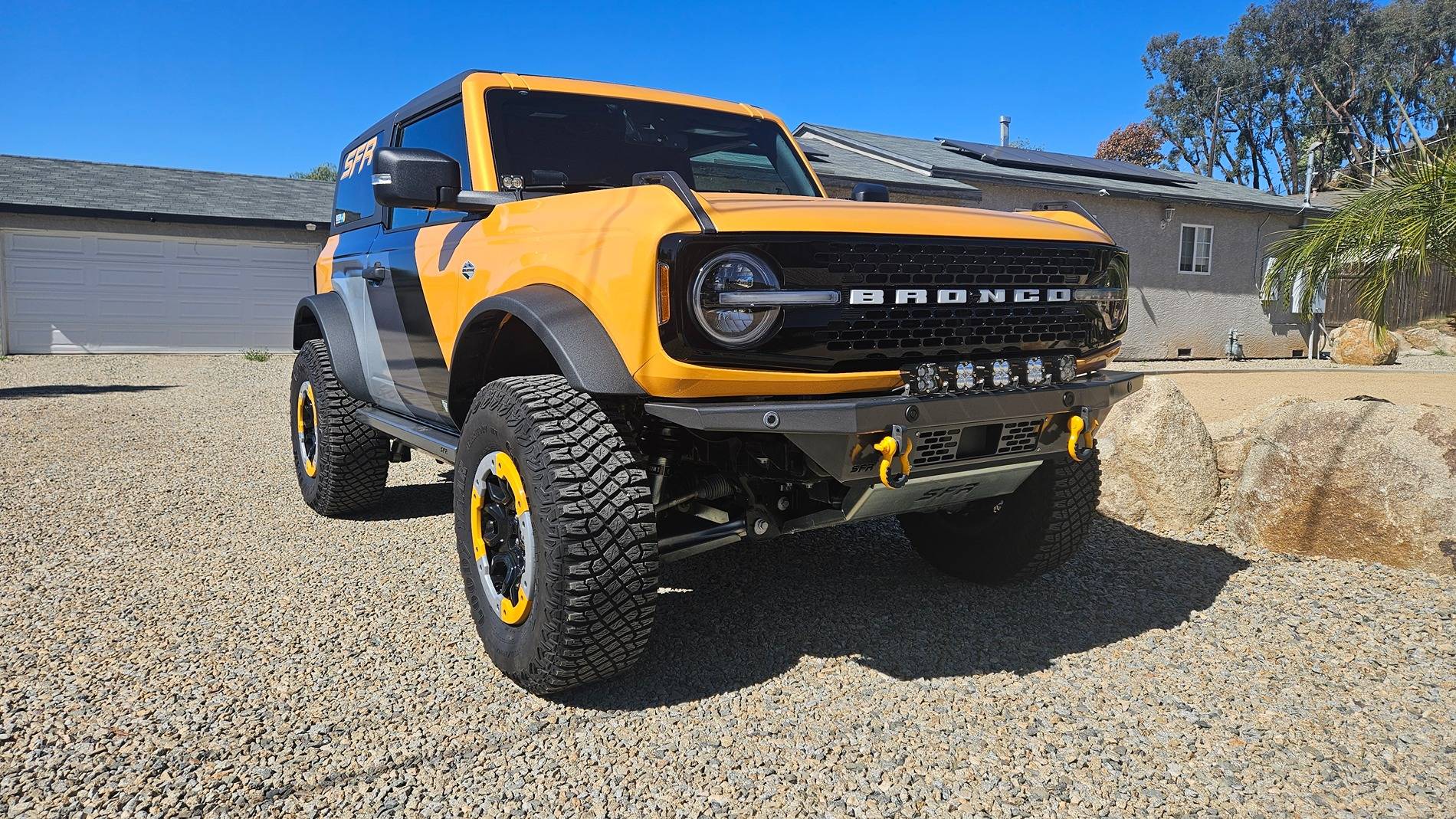

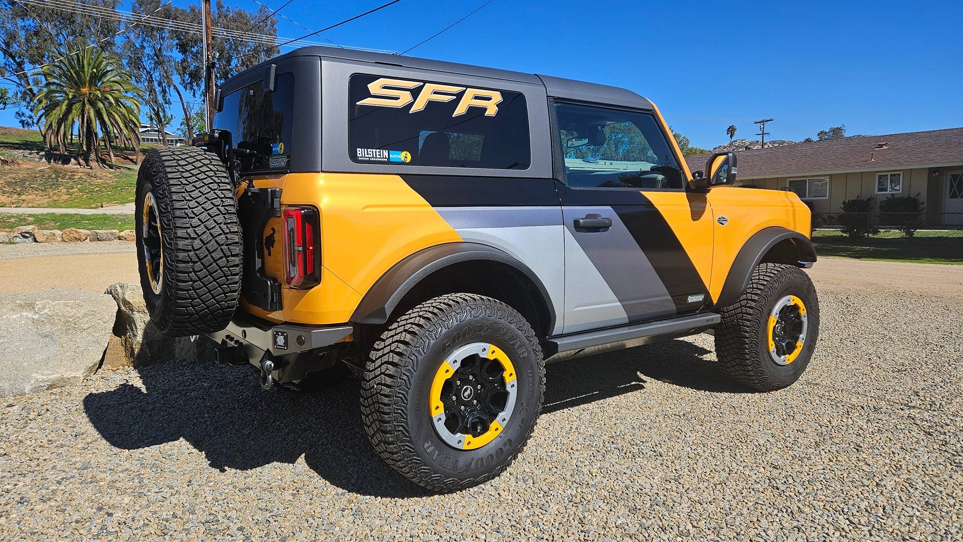

The Before/After from just installing the 6112s isn't really gonna be noticeable, as I purposely tried to keep the height close to where it already was with just the front leveled about 1.5". At most I gained half an inch, though I didn't bother to measure precisely. I used the 4th groove in the front and the 2nd on the rear, which in theory should be about .5" lift in back and 1.8" up front. Here's some current pictures with one from the day I bought it.
Thanks buddy. That looks like the perfect lift I’m wanting. Then I also don’t have to deal with track bars, upper control arms, and new rear links. Just looking for a little bit more lift over stock, better off-road capacity while maintaining OEM equipment.
