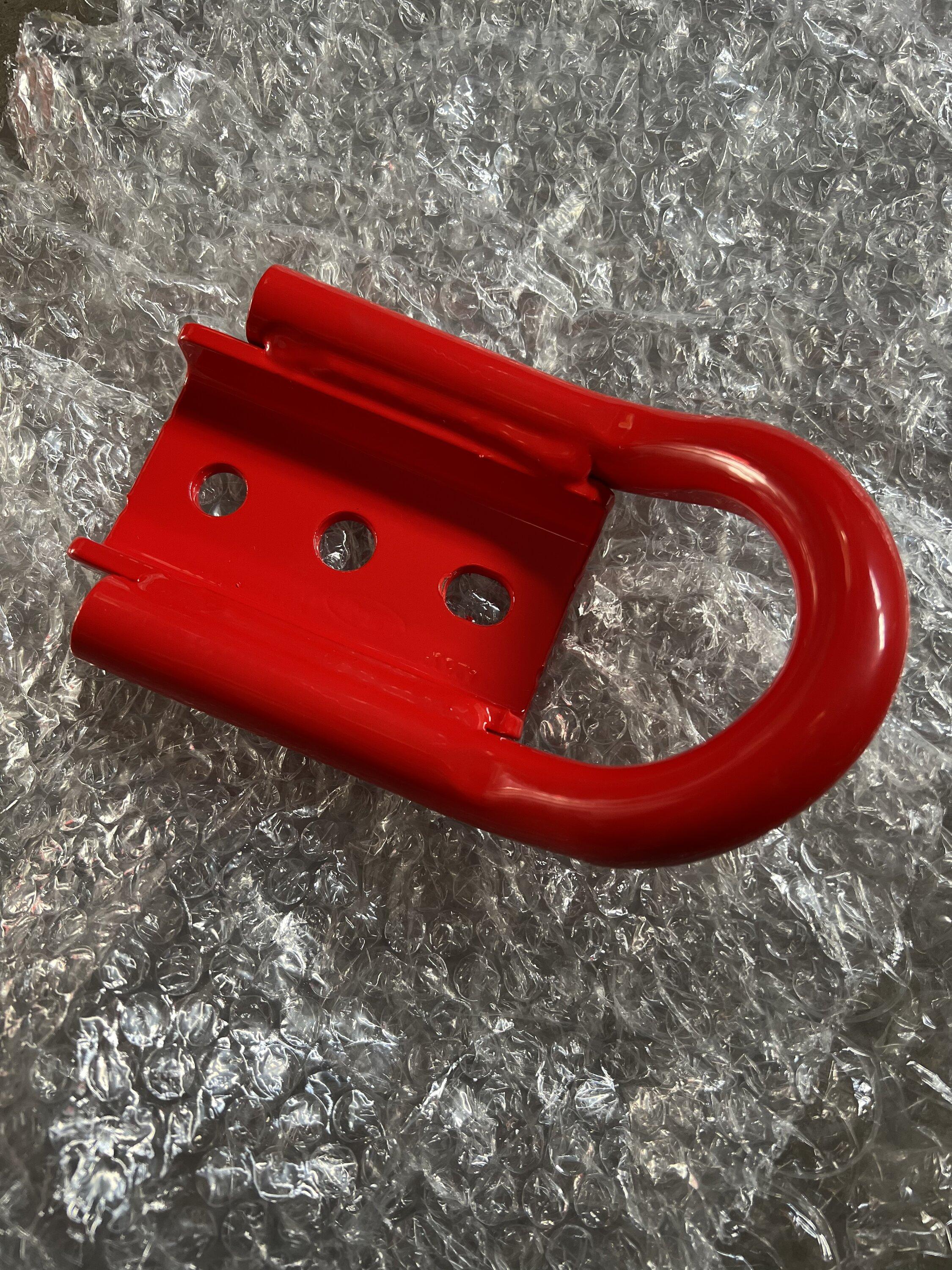

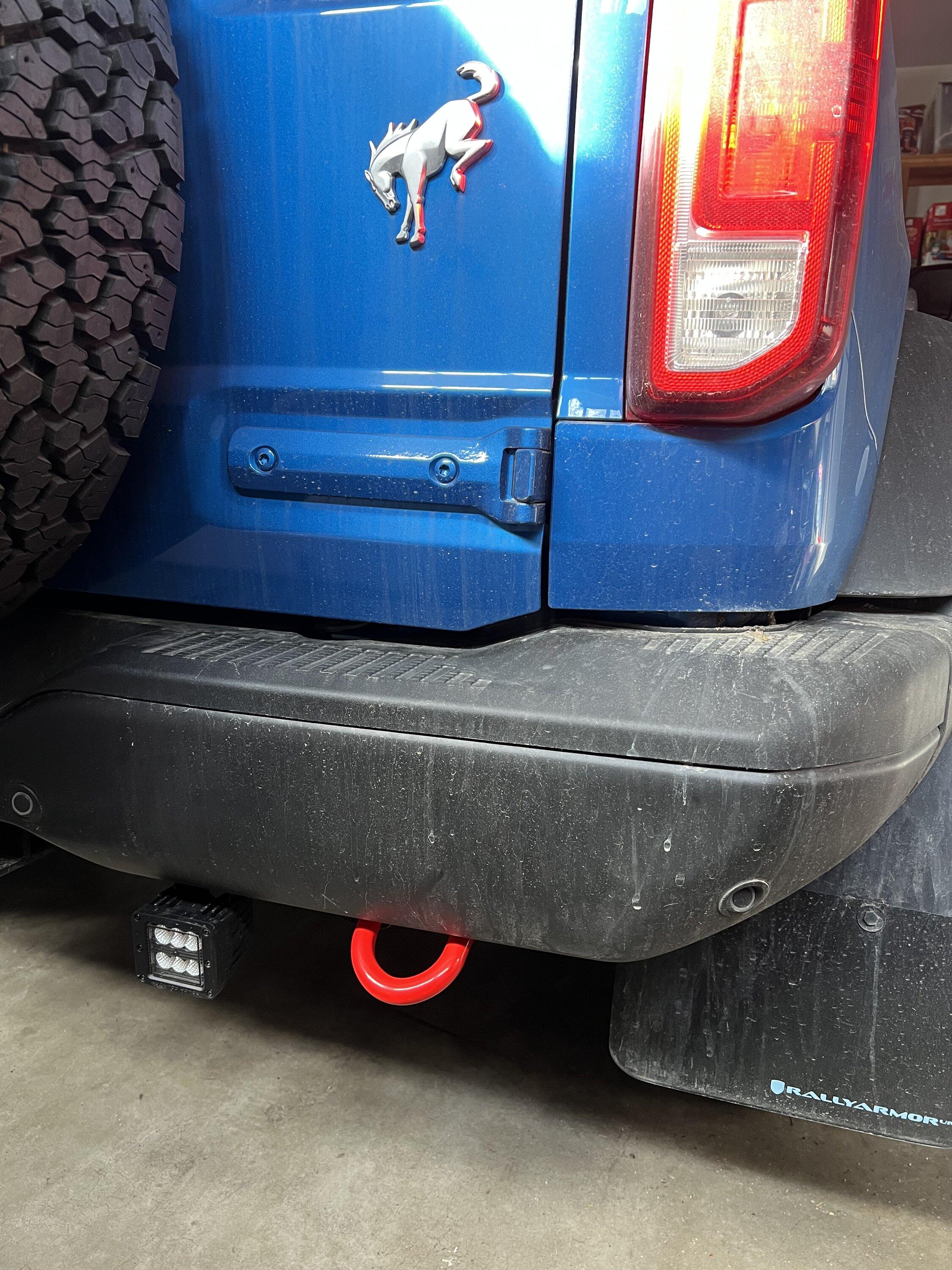

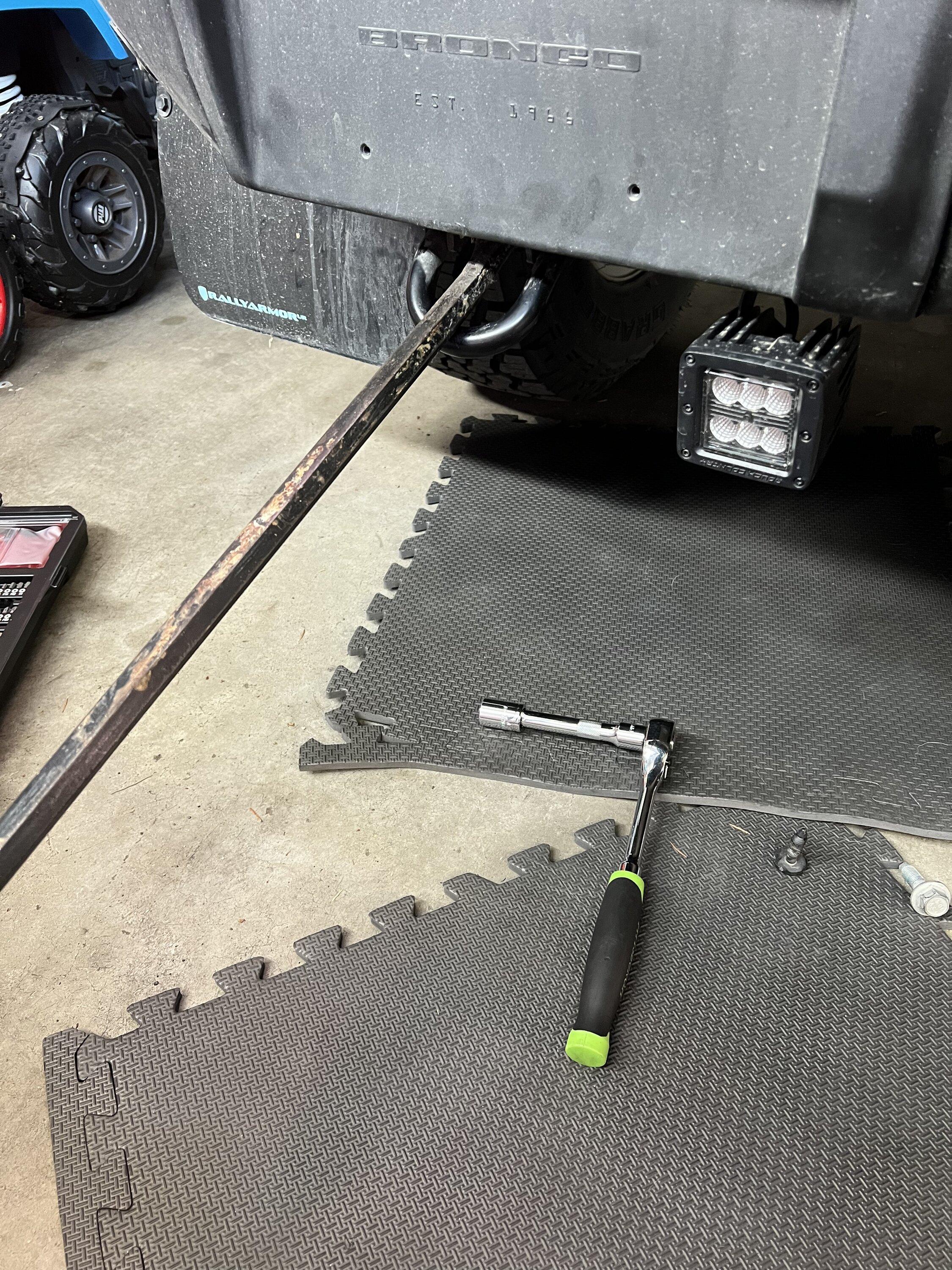

Seems like a lot of people are looking to put a factory tow hook on the rear passenger side of Broncos that only come with a rear drivers side tow hook. The Ford dealer parts department didn't have an easy time finding it, but they eventually did. Not cheap, though. $71 for the hook and $6 for the two bolts. I used my Ford points, so it wasn't as painful. Torque for bolts is 59 ft/lbs.
