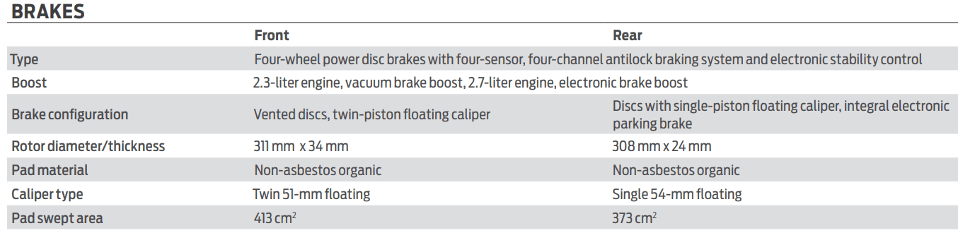

Hey all. Did a search but didn't see anything regarding this.
This is arising from a whole drama concerning my dealer trying to weasel out of doing work under my prepaid Ford Premium Maintenance plan... Anyhoo...
Does anyone have the Ford published specs for the brake rotors on the Bronco? Nominal thickness when new and minimum thickness?
Much Appreciated.

This is directly from PTS what I use on a daily basis here in the shop. Hope it helps
Perfect! So for non-Raptors
Fronts:
34mm Nominal - 32mm Discard
Rears:
24mm Nominal - 22mm Discard
