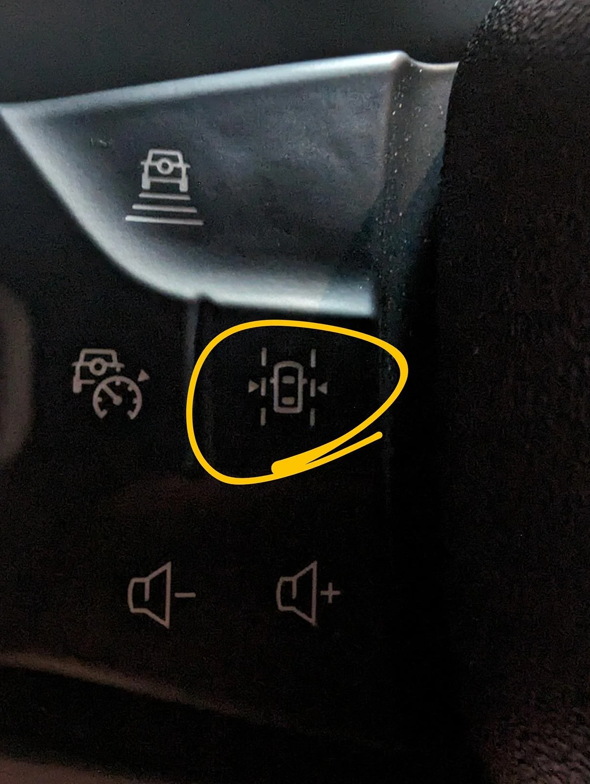

I've decided that THE most annoying of all the annoyances is: The stupid hands on the steering wheel nanny. Make her stop.
She has a mute button.
Ford Bronco Bronco Cheat Codes List 1000000857
It turns lane keep off as well.
Huh, didn't realize that would turn her off.....so then I have to choose. Thx for that info.

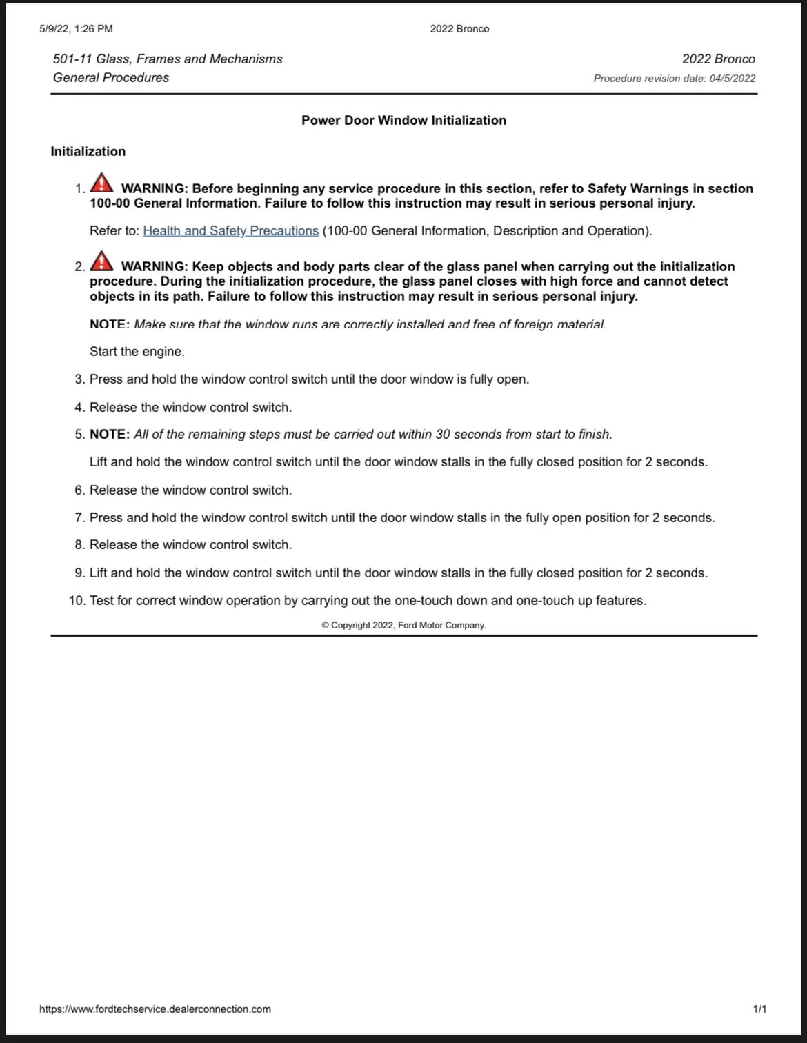

I've asked every time the window reset procedure gets posted, because even the workshop manual is vague about it...
"Press and hold the switch" -- am I pressing to the first detent (open/close) or the second detent (auto-open/auto-close)?

Fully depressed if I'm not mistaken - so second.

“Press and hold” = all the way until you can’t press any more
