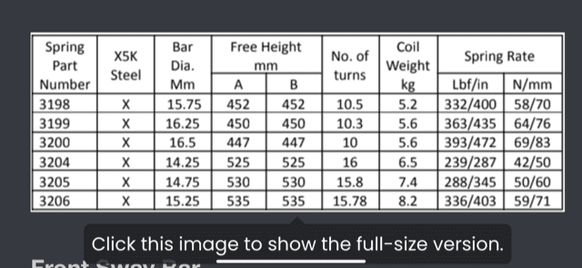

Here are some spring rates from @Snacktime bilstein 5100s thread. Some fairly soft springs.
Here are the specs comparing the Bilsteins/OME. The Bilstein 6112 fronts sit between the OME medium and heavy, and the rears match the medium OME springs.
Ok

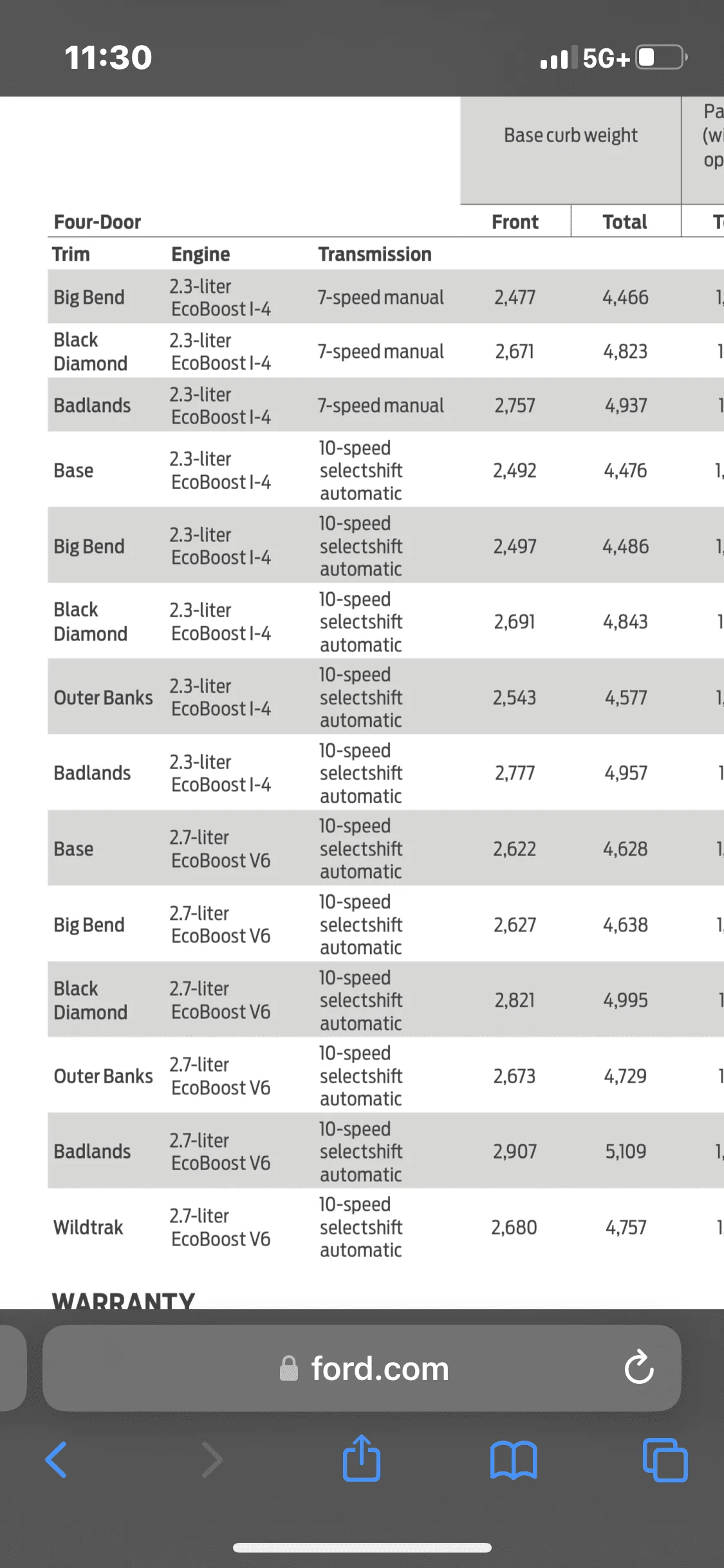

Some lessons learned. Thanks @Silver-Bolt for input. So I think it is a challenge to measure displacements on truck and estimate spring forces accurately. Weight distribution and CG are not really known. So load on a wheel is difficult to get. Gravity and an incline also have an effect. In the IFS, motion ratio can not be ignored in the front. Too many sources of error.
Perhaps the best way is to use the linear spring theory. K= G * d^4 / (8 * N * D^3) for a gut check, using this on OME data, d=15.75 mm=0.62”, N=10.5, G=11x10^6 psi, K=332, so coil diameter calculates as D=3.9. Table doesn’t list coil diameter so can’t calculate K directly. Table does list spring weight (5.2) kg, so coil diameter can also be calculated from weight as 4.0”. Very similar to 3.9” from spring theory. Fox coil diameter was reported as 3.6” for front. Ford springs have a fairly large diameter at about 5.5” and don’t sit as snuggly on the shock as OME or fox.
Seems that the spring theory works fairly well for the OME springs. So from earlier calculations, the Ford spring rates from my 4dr 2.3 OBX hitachis calculated as:
  • Front 350 lbs/in
  • Rear 225 for initial linear range
I now believe those are pretty good numbers. SAS springs are likely heavier to achieve additional lift and not affect either preload or usable extension travel.
IFS motion ratios. PIA… For bronco this seems to be close to 1.5 for the front. Close to 1:1 in the back. So if rear spring rate is 225 then a similar rate spring on front would need to be 225*1.5 or 340. The Bronco spring rates calculated above then seem fairly balanced on all four corners.

It would be super simple if I had factory springs to put in our spring rate machine. No guessing/speculating required. I will be adding a fair amount of weight to my Wildtrak when it arrives. ARB Summit bumper, winch, Metal-Tech rock rails, skid plates, and rear bumper with swingout tire carrier. I don't want a lift, I just want to handle the extra weight at the factory ride height.

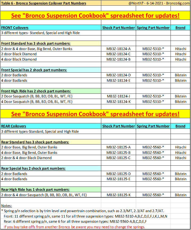

The unfortunate thing would be you need to test 11 different front springs and 6 different rear springs. :whistle:
All springs lengths should be the same for front, and again for rears. The heaviest spring rate would have to be from a 4-door First Edition as it had EVERY OPTION. Find someone with a 4-door FE and ask for their VIN so you can determine what spring P/N they have.
(I grabbed this VIN from BaT: 1FMEE5EP2MLA40056 )
Ford Bronco Bronco coilover spring specs? GhDVDXh

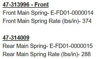

Reviving this thread back from the dead since I was looking for some stock spring rate numbers and noticed some errors.
Im surprised that you forgot to incorporate front motion ratio when estimating front spring rate by means of spring deflection.
Also the correct formula for wheel rate = spring rate x (motion ratio)^2.
So in the previous example, if the rear spring is 225lbs, assuming a 1:1 motion ratio, then the equal front spring would be 506lbs assuming a 1.5:1 MR.
indeed. Some poor assumptions that have already been highlighted in some of the earlier posts.
However the stock front springs are definitely lighter than 506 lbs/in. Especially the non-SAS flavors.
