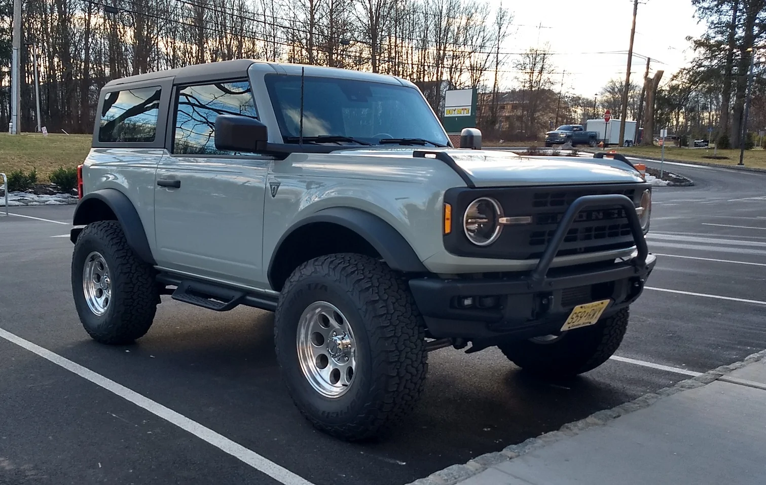

If you go higher than 3" over non Sas then you are looking at possible cv issues due to the angles. I went with the ProComp adjustable coilovers which I have set around 2" over Sas up front and 1" over Sas in the rear. Plenty of room for 37's and I was able to keep the stock UCA's and get aligned with the aftermarket wheels (17x9 -6 offset). The ProComp coilovers are really easy to adjust the height, you don't have to remove them and can just lift the frame to get some suspension sag and turn the collars. What are you ultimately looking to accomplish with the lift and what kind of ride quality are you looking for? The ProComps are firmer than stock but I really like the way they feel and handle turns on the road. Are you looking for lift and softer springs for a more comfortable ride?
Not really looking for the lift exactly, just need to clear 37s at full articulation. Going to be a lot of trails, so ideally something with an external reservoir and compression/rebound adjustment.
