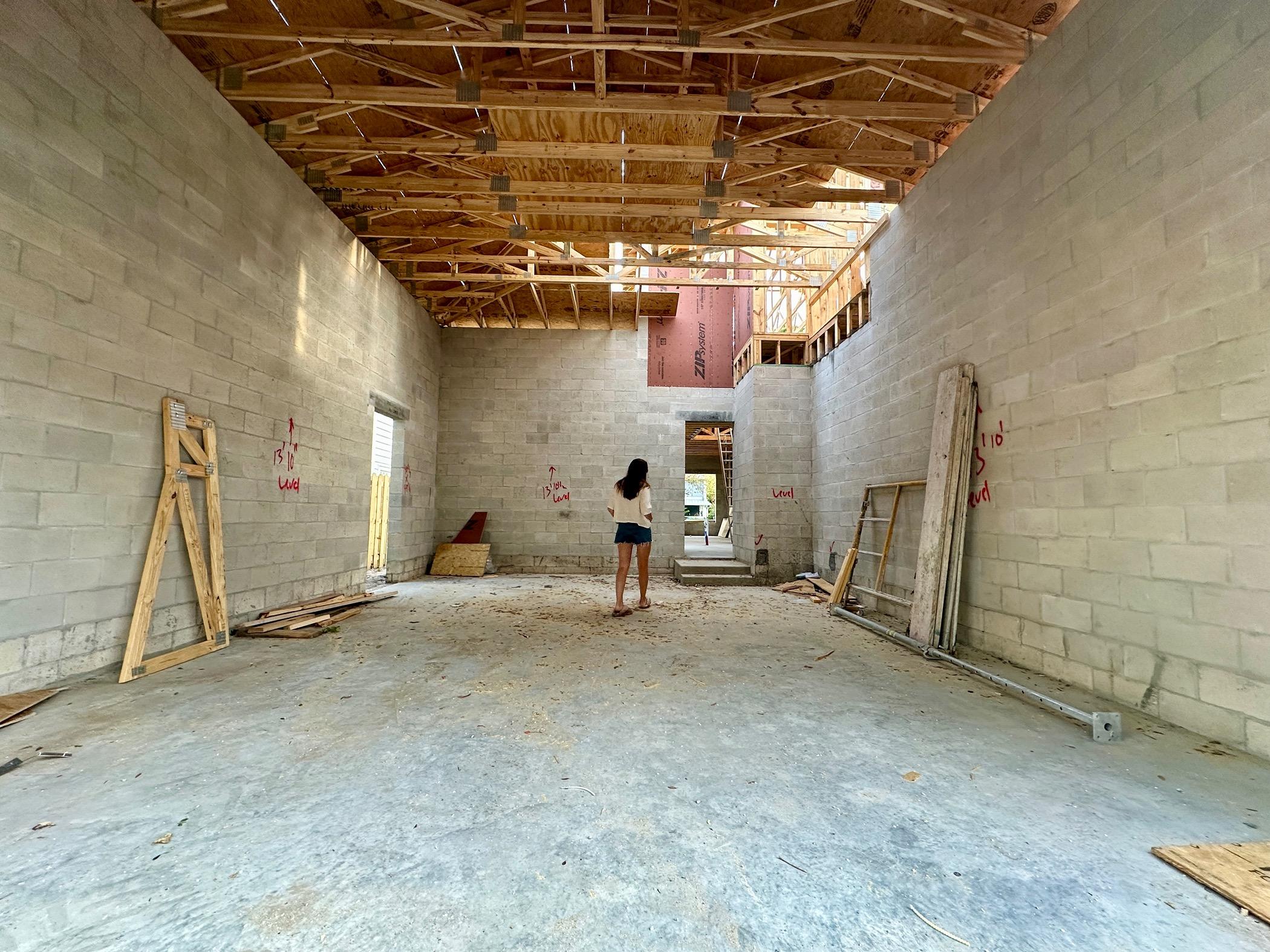

Appreciate the insight! The ceiling is just under 14' and the garage is about the same dimensions as yours (21x30)

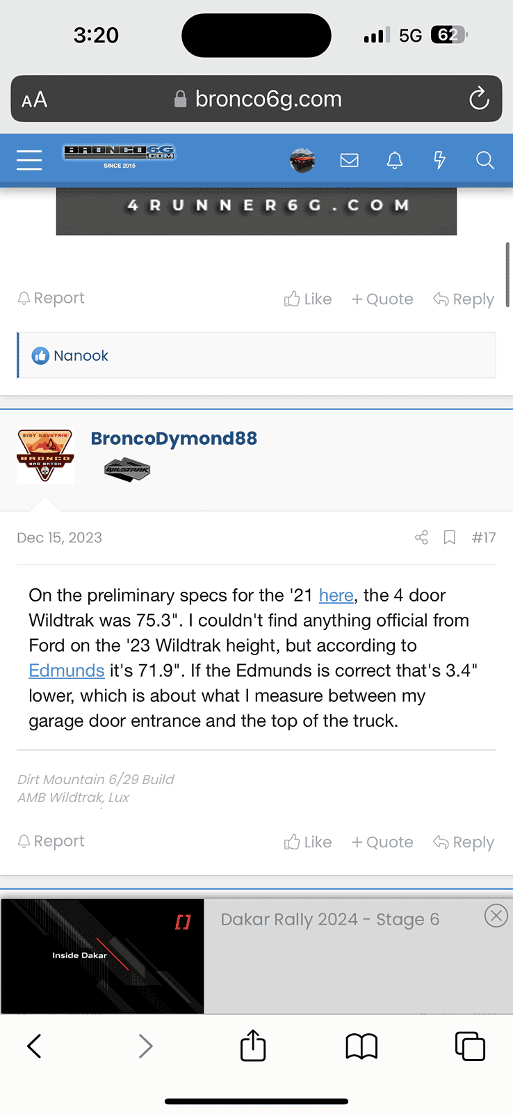

Great resource. Along similar lines, i currently have a Wildtrak soft top which is a little too high for my garage, by less than half an inch and I have to roll down my soft top in order to enter the garage. Now that i’ll be transitioning into hardtop I am wondering:
- does the oem soft top on Sasquatch tires sit higher that the oem MIC/ Anderson composite hardtop Sasquatch tires? If so by how much?
I could still take out the front 3 pieces to get into the garage but it would be great if the hardtop sat lower by about half an inch so i don’t have to.
I noticed on the hardtop prep kit that the brackets sit quite low beneath the hardtop, by almost an inch Which gives me hope.

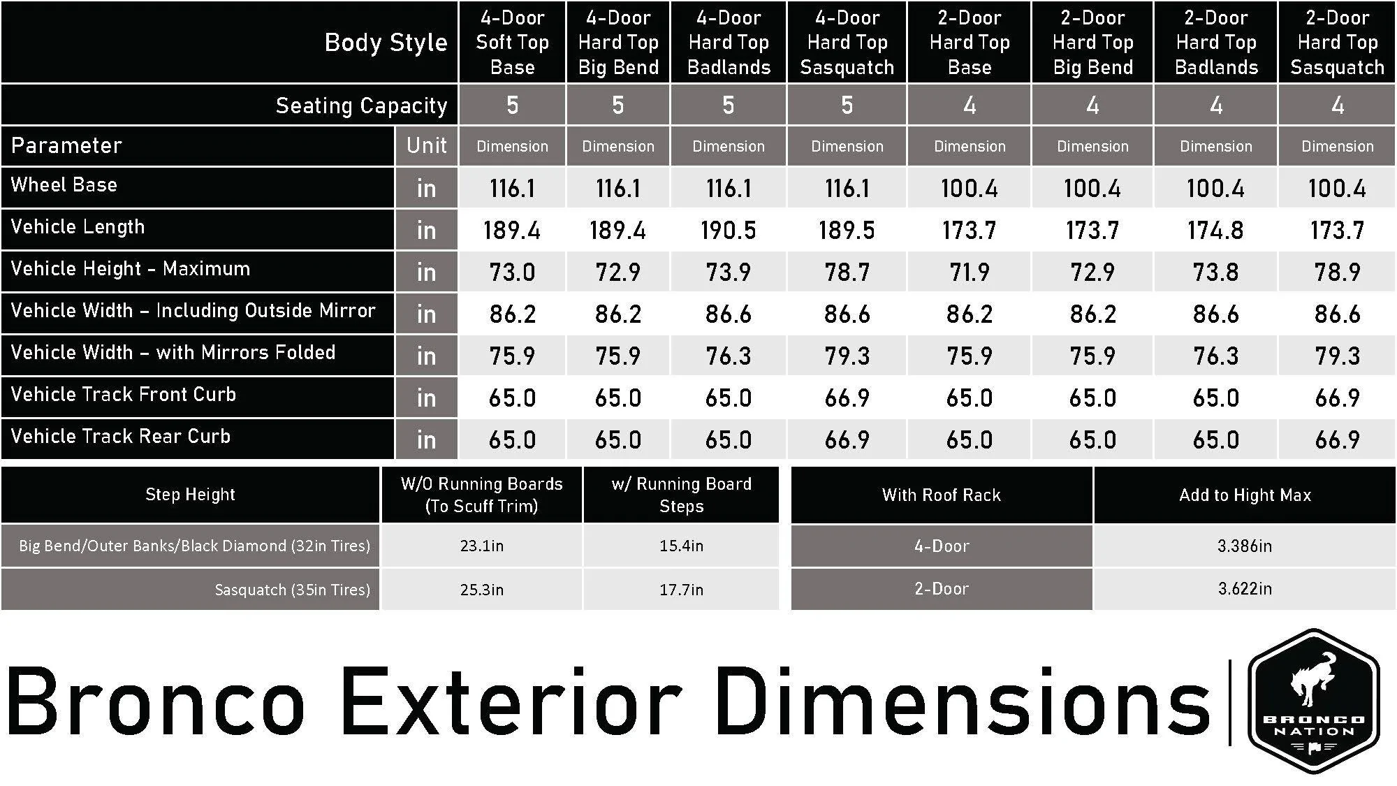

This is one of the charts I referenced. Although I'd take it with a grain of salt because the "max height" measurement for the 4 door Sas category lists 78.7.
From what I can tell, that is actually the height including a roof rack, despite them having an additional measurement to figure in the height with the roof rack.
I saw somewhere that an Everglades (basically a Sas with a roof rack) measured 78.7.
In your case, I'm comparing the 4 door soft top base to the 2 door soft top base and you'll see the tops do not make much of a difference.
But like I said, I'm not sure I really trust it hah.

Thank you for the info. Given how small the dimension is that i’m working with, i’m doing a bit of hair splitting to make sure i hit the bullseye, pardon the mixing of figurative expressions here.
I did do some digging and it seems to confirm what i suspected which is that the soft sits a little higher than the hardtop, everything else being equal.
It would make sense because the cloth of the soft top sits on a pretty high crossbar to keep it from collapsing in while the hardtop lays flat on the top bar and is held in place by the prep kit that is screwed directly on the frame.
