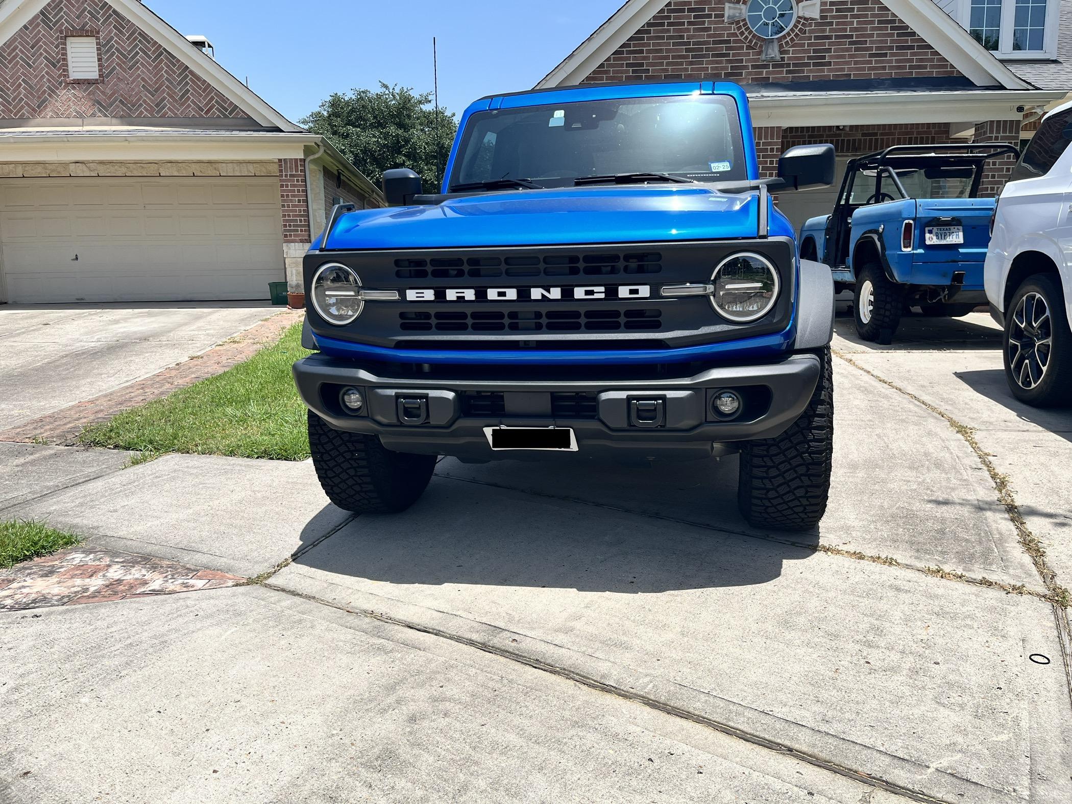

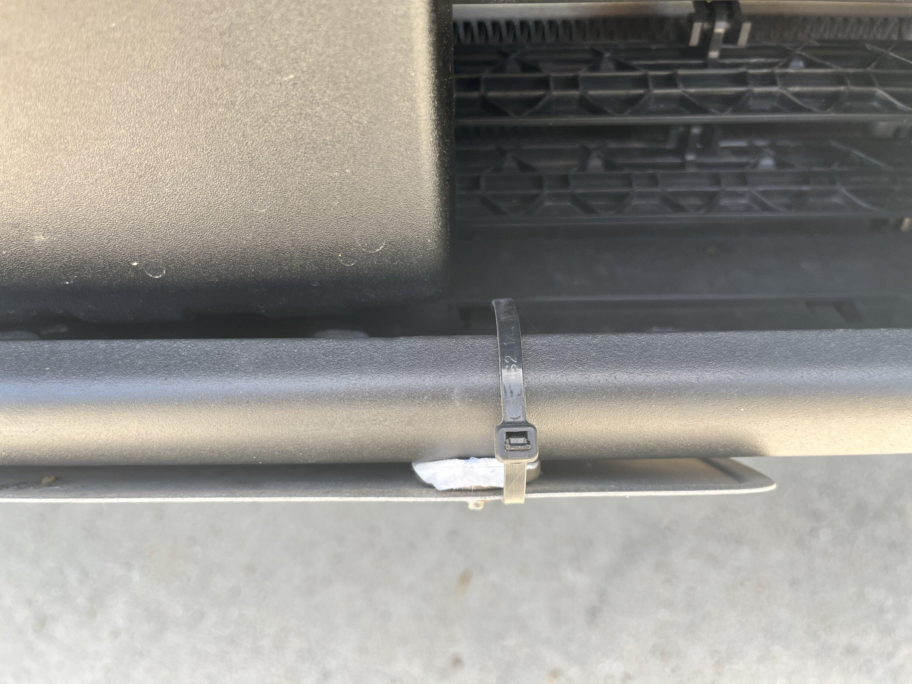

I didn't want anything bolted to my bumper.... so I used two 100lb magnets bolted to the top holes of the license plate and a couple zip ties to make sure it didn't slide around. I used a 2" round sticker pad thing (no idea where that came from, but it was in my garage and the right size) on the back of the magnet to make sure it wouldn't scratch anything.
The magnets I used have a hole in the middle. I used a small bolt/nut/washer to secure the plate to that. Been that way for about 3,000 miles without issue. The other bonus, it puts the plate flush against the bumper at the bumper angle (so angled down, won't snag on stuff).
