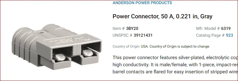

That connector looks good but I'm concerned about the silver contacts, however the connector looks similar to the Warn and Bulldog ones. Those do not list the contact type of finish. The safest bet is the standard boaters trick, always coat all your electrical connector pins and connections with dielectric grease, including 4 and 7 pin trailer light connectors or winch connectors. Otherwise, moisture will tarnish the contacts and you will lose electrical connection or reduce your amperage due to resistance.

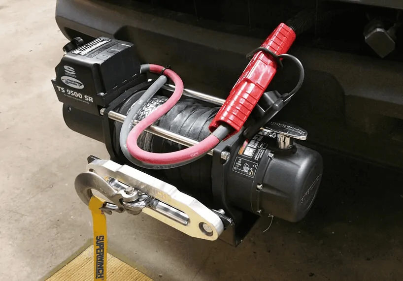

That's an ATV winch connector at only 50A. The ones you want for a winch are the Anderson 350A.

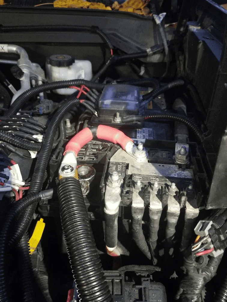

I rewired my Tigershark 9500 with 2/0AWG and ran that all the way to the battery as well as converting the battery terminal to 1/0AWG with a KnuKonceptz terminal adapter.

Ensuring as little current drop as possible with a 1/0AWG short run to a Knu Konceptz terminal converter.

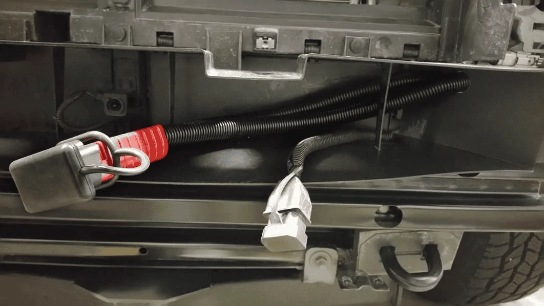

FINALLY - a sensible human. Now just put this connector on the front and back:
Did the 175 Anderson connectors. Modified a 1/0 AWG jumper cable set. It’s not permanently mounted at the front and rear, but the new plug under the hood is ready for the extension cable any time I need to connect a front or rear winch or inverter/deep cycle battery.
