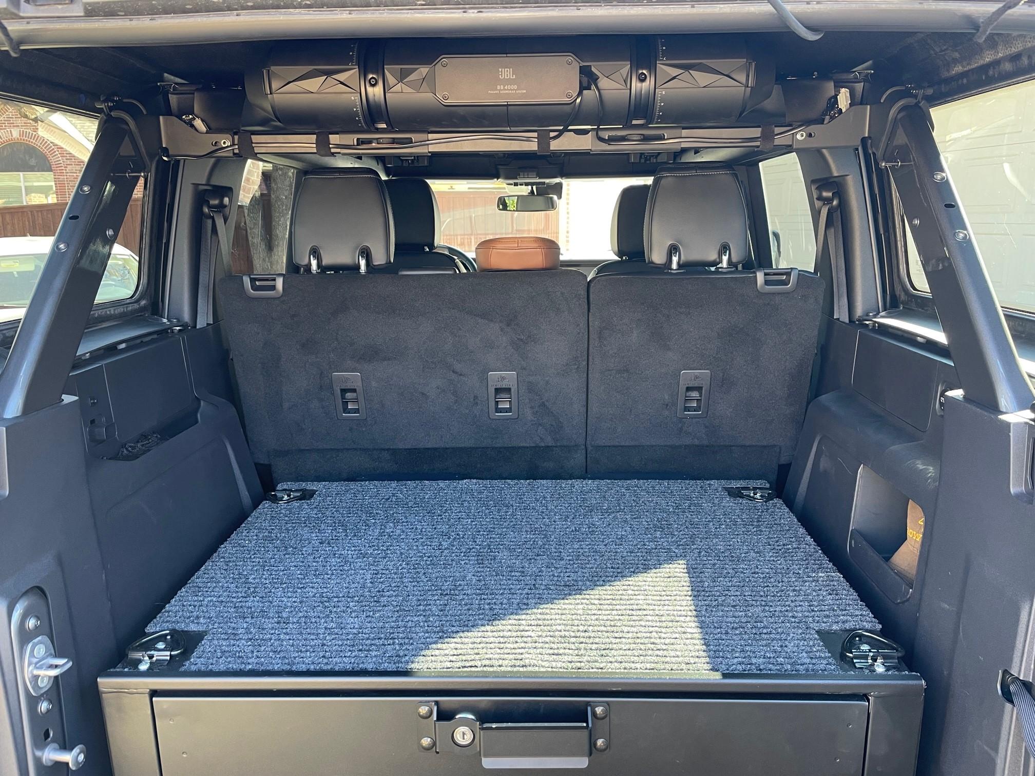

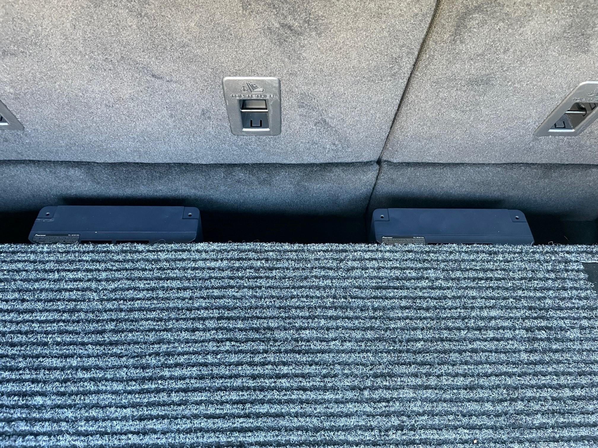

I have the Cargo Area Security Drawer accessory (which is fantastic by the way) so my sub placement was giving me trouble. BUT after long searches I found a powered sub (actually I used two) that fit nicely between the back of the rear seats and the back of the cargo drawer. That was a no man's land gap anyway. Since the cargo drawer is carpeted inside, and the subs are downward firing, the box creates an added resonance that these little subs would not otherwise have.
The subs are Pioneer TS-WX010A. They don't pull a lot of amps (designed for use in electric cars) so you can power them with the rear quarter panel accessory power in the back. I wired them to the sound bar. Great sound all around.
