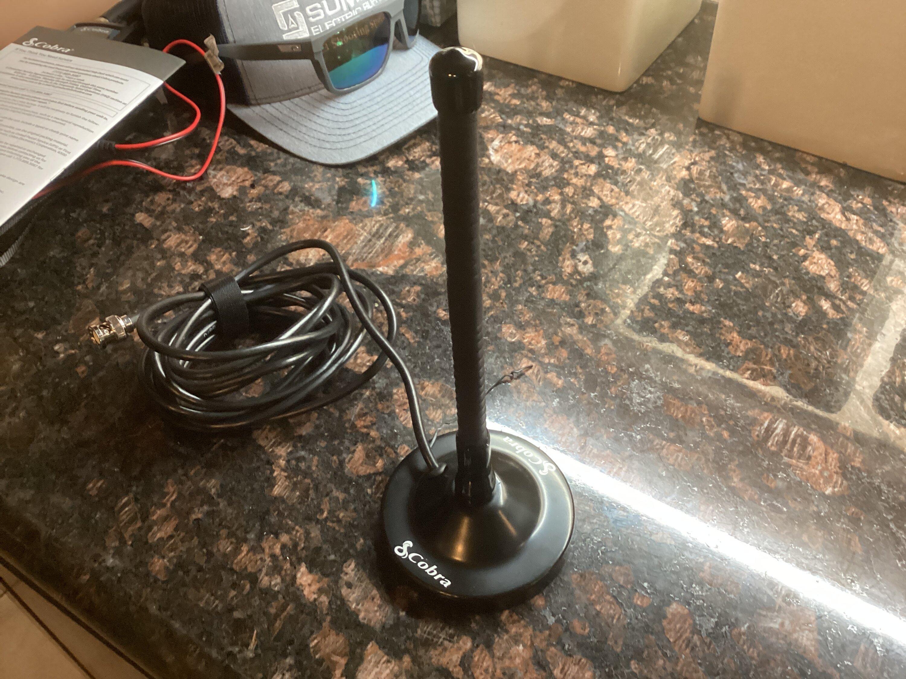

In a rush before going wheeling in the Lincoln National Forest this next week I purchased a Cobra CB radio that came with a magnetic base antenna. Dough! There are no carbon based horizontal metal surfaces on the new Broncs. Looking for ideas on antennas and mounting options. Hope you are doing well Doug!

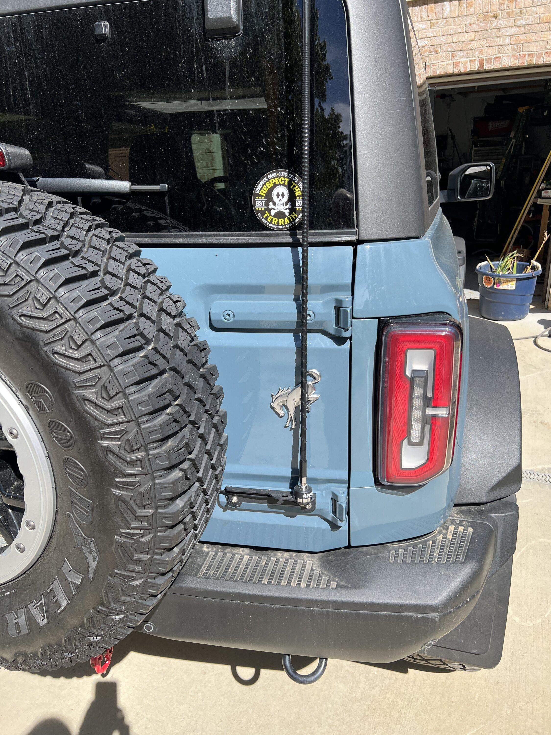

I Bought this mount off E-bay, a 3 foot Firestick, NMO cable to PL259 and an NMO to 3/8 24 Adaptor. Mount Adaptor Cable Firestick

No issues of that firestick whacking your tailgate?
No not in normal driving, when I was 4 wheeling I think it might have hit it, but it was a bit loose. After I tightened it on the NMO mount it didn't hit again.
