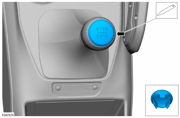

  1. Remove the gear shift knob lens.
    Use the General Equipment: Interior Trim Remover

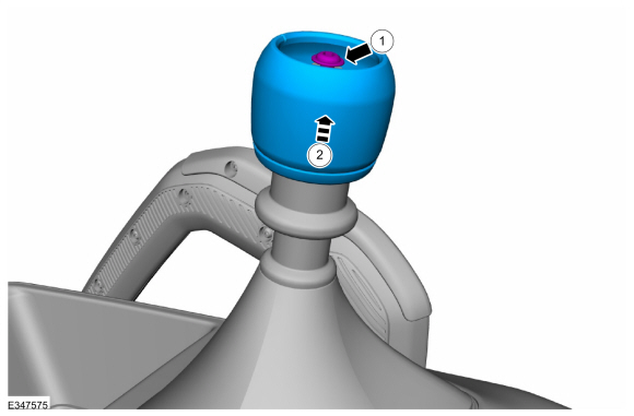

    1. Remove the gear shift knob screw,
      Torque: 53 lb.in (6 Nm)
    1. Remove the gear shift knob.

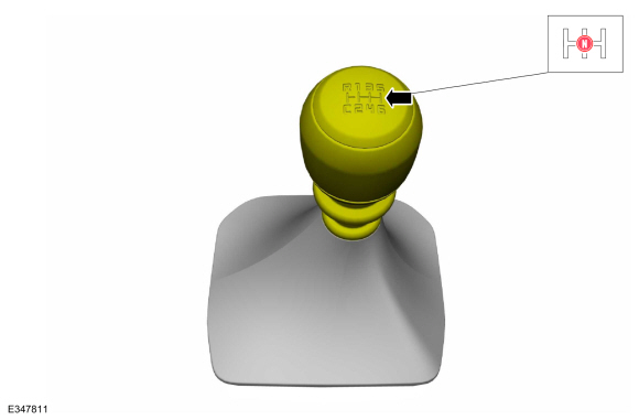

  1. Place the gearshift lever in NEUTRAL.

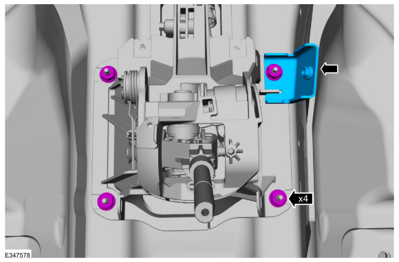

  1. Remove the gearshift lever retaining nuts and grab handle support bracket.

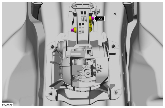

  1. Remove the gearshift cable bolts.

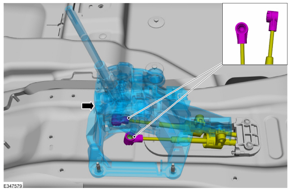

  1. Disconnect the gearshift cables and remove the gearshift lever assembly.

  1. Connect the gearshift cables and install the gearshift lever assembly.

  1. Install the gearshift cable bolts.
    Torque: 97 lb.in (11 Nm)

  1. Install the gearshift lever retaining nuts and grab handle support bracket.

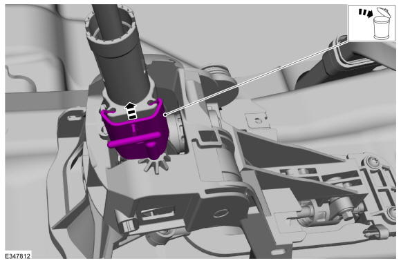

  1. NOTE: This step is only necessary when installing a new component.
    Remove the gearshift lever locking pin and discard.
