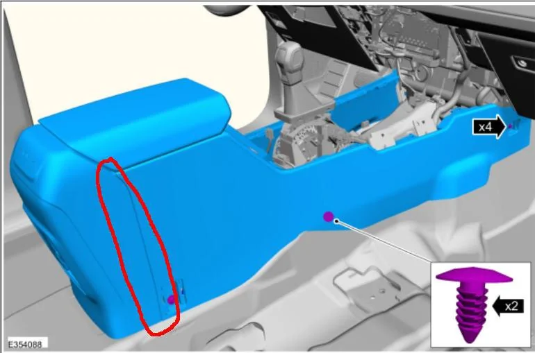

Does anyone know if the center console is two pieces and if the back end can be removed without removing the entire console?
It feels like two pieces where the red circle is.
I'm looking to add to rear heated seat switches to the back of the console.
If would be great to know if any has been able to remove the back portion of the console and how they did it.

Yes open the top and gently pull back on the rear piece. Use a pry tool and some painters tape to save the plastic
Thanks. Any pictures of the where the connection points are would be awesome. Thanks again.

I would, but i am on a business trip or i’d send you a quick video
Any change you would have some time to send some pics or a video on how to remove the back of the center console? I would really appreciate it!

I recall seeing a video talking about IAG cupholders that are coming soon where they just pulled this back piece off to open it up. I don't recall who did the video, but it was recently posted and not done by IAG. Got it. Here's the link. Check out around 3:12 into the video.
Thank You! That looks easy. Much appreciated.
