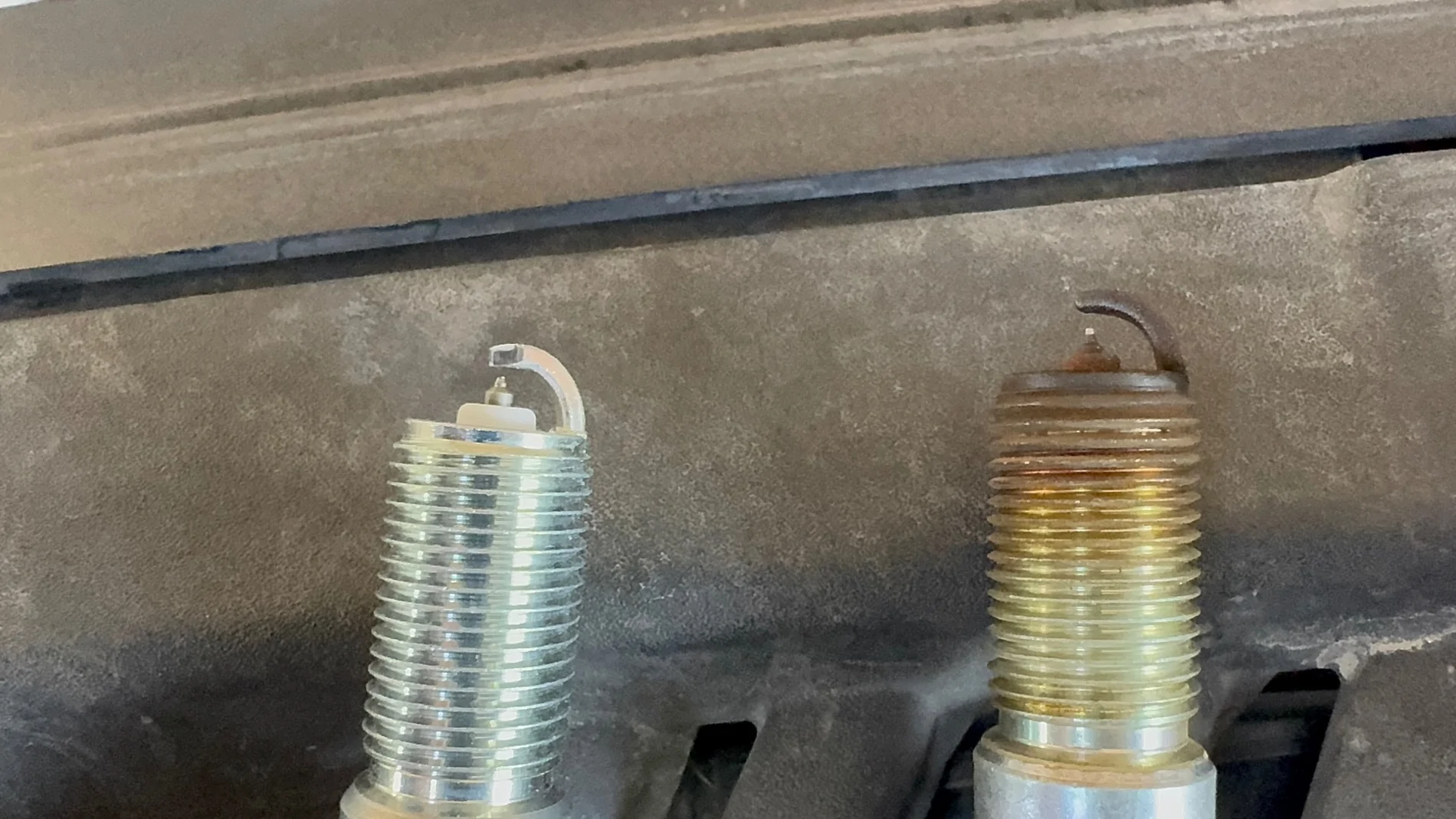

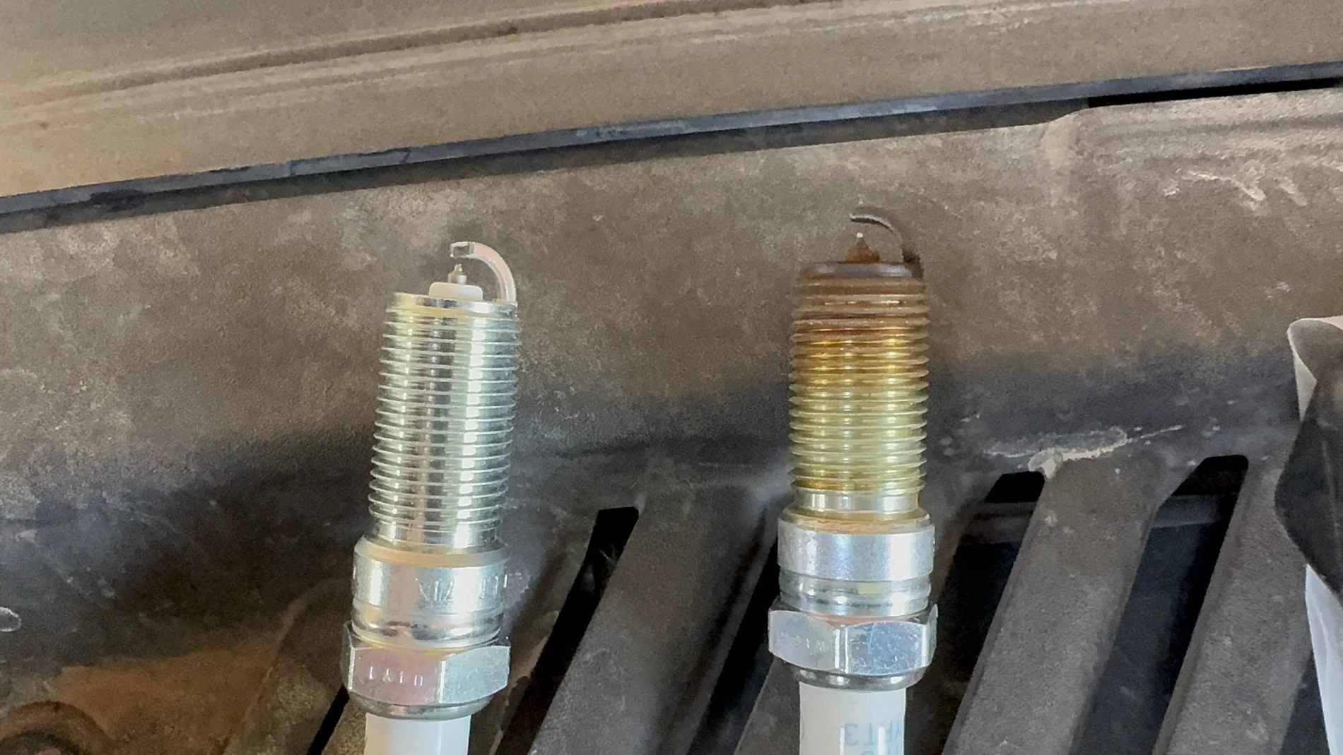

Recently changed mine (long overdue) and figured I’d share for this not familiar with doing this or just wanted to see what it entails.

How many miles did you have?

Old plugs look pretty damn good, looks like they could have lasted a lot more miles easily.
Yeah, its hard to know until you get them out, they had about 65-66k miles on them

I dunno, I did mine at 50 - the plugs didn't look bad, but definitely noticed a difference in idle smoothness and got a small MPG bump from it.
So.. I didn't ~need~ it, no misfires or anything, but it certainly didn't hurt anything. My plugs looked a bit worse than the OPs, but not awful or abnormal.
