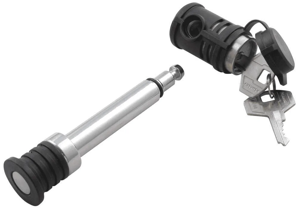

Only bad part is the locking hitch pin. My key faces the same direction as the pin so I'd have to remove the 7 way to unlock it. It's just one bolt though and the Bronco tool kit has the correct socket. If you're going with a locking hitch pin get one with a key that is 90* from the pin.

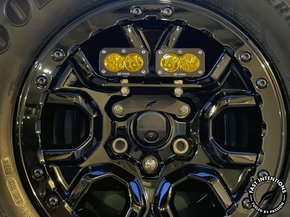

For actual "chase lights", you do not want them down low. The purpose for them is for the vehicles behind you to see you in the heavy dusty conditions. A hitch mounted version is nearly useless.
Agreed!

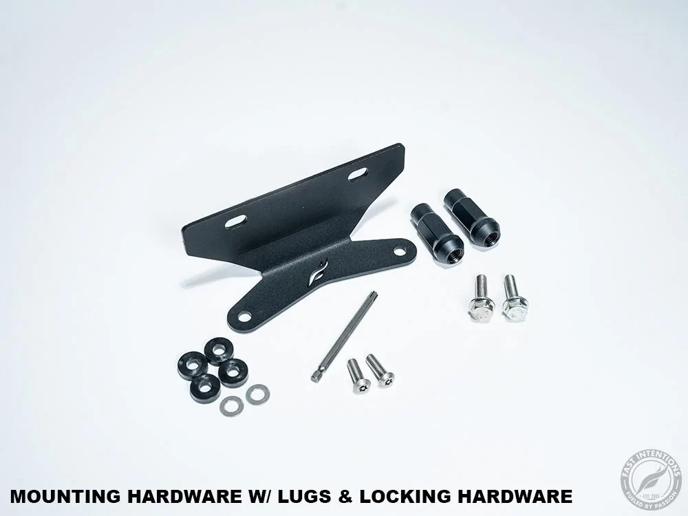

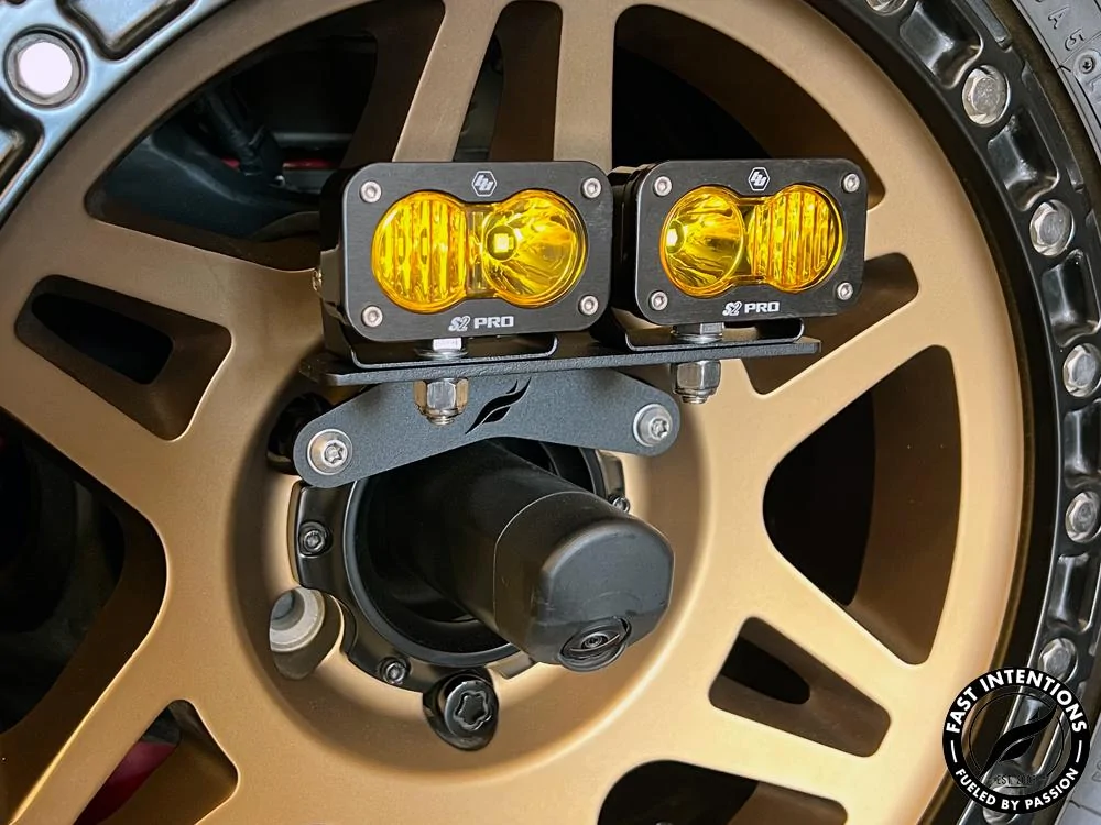

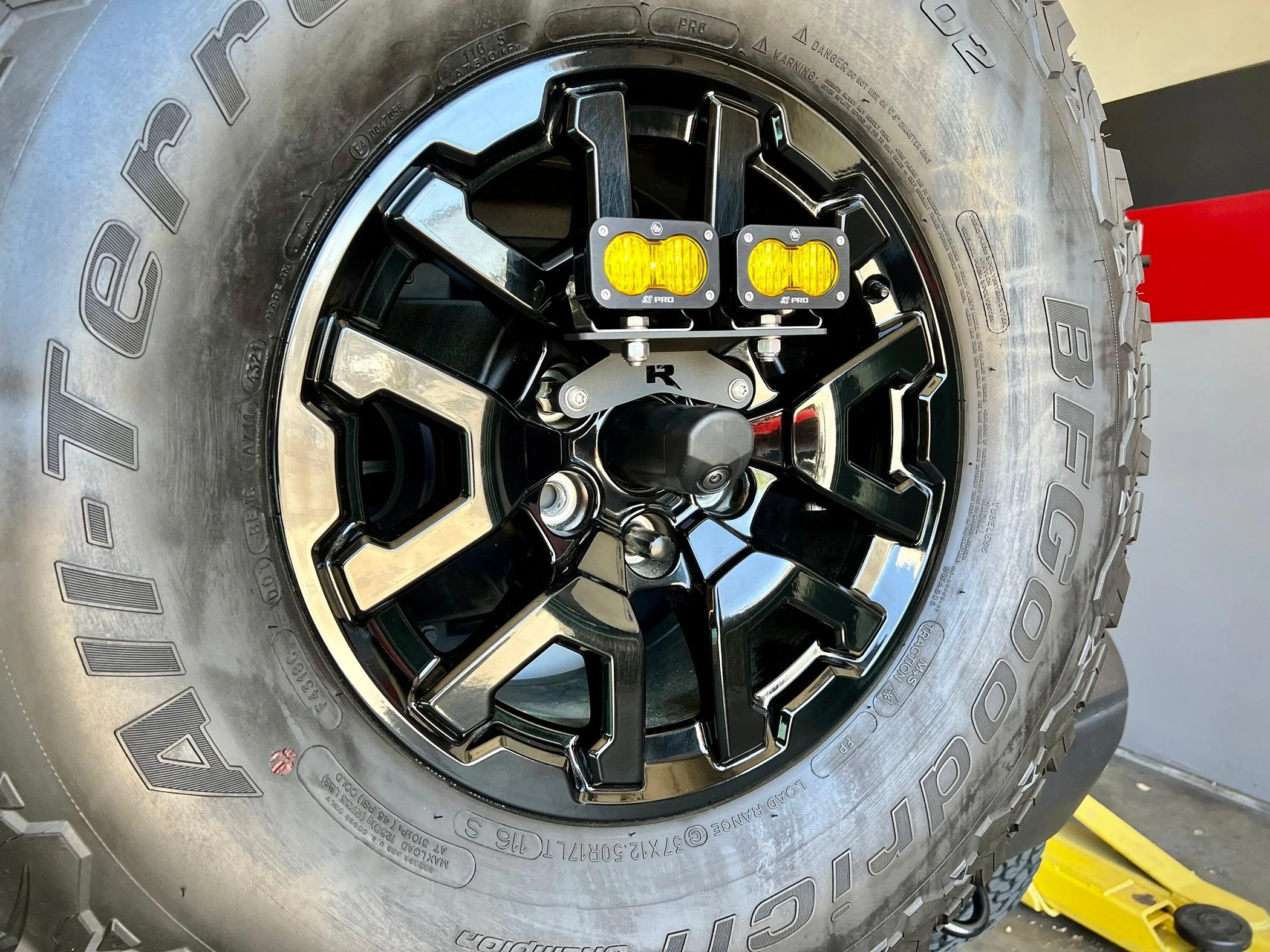

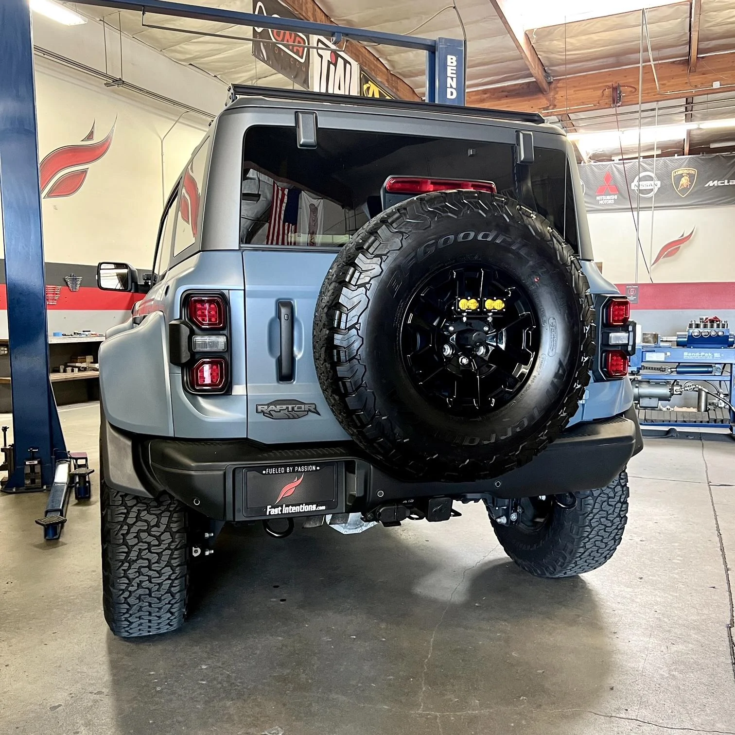

There’s a bracket made to mount them in the spare tire. I’m leaning towards this area when my bronco arrives
