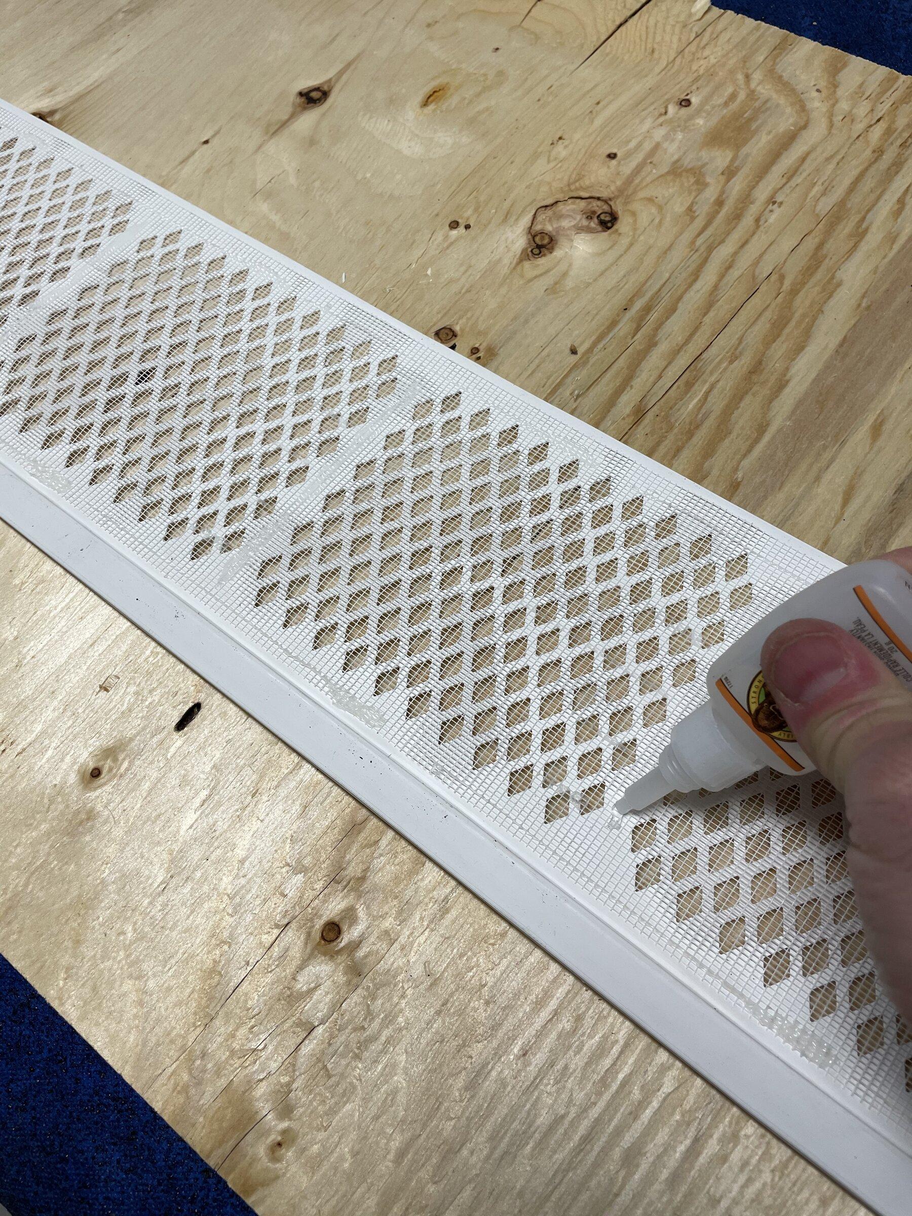

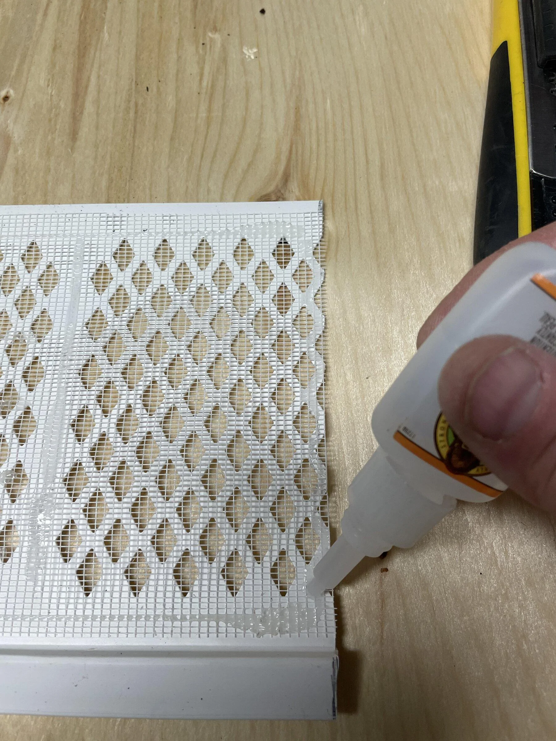

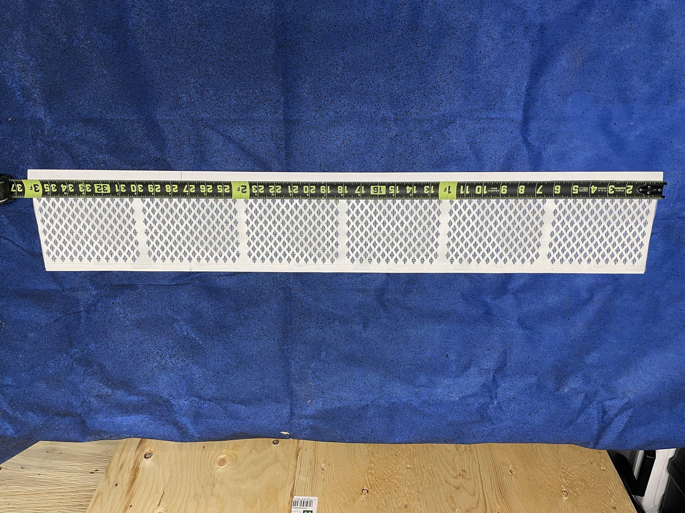

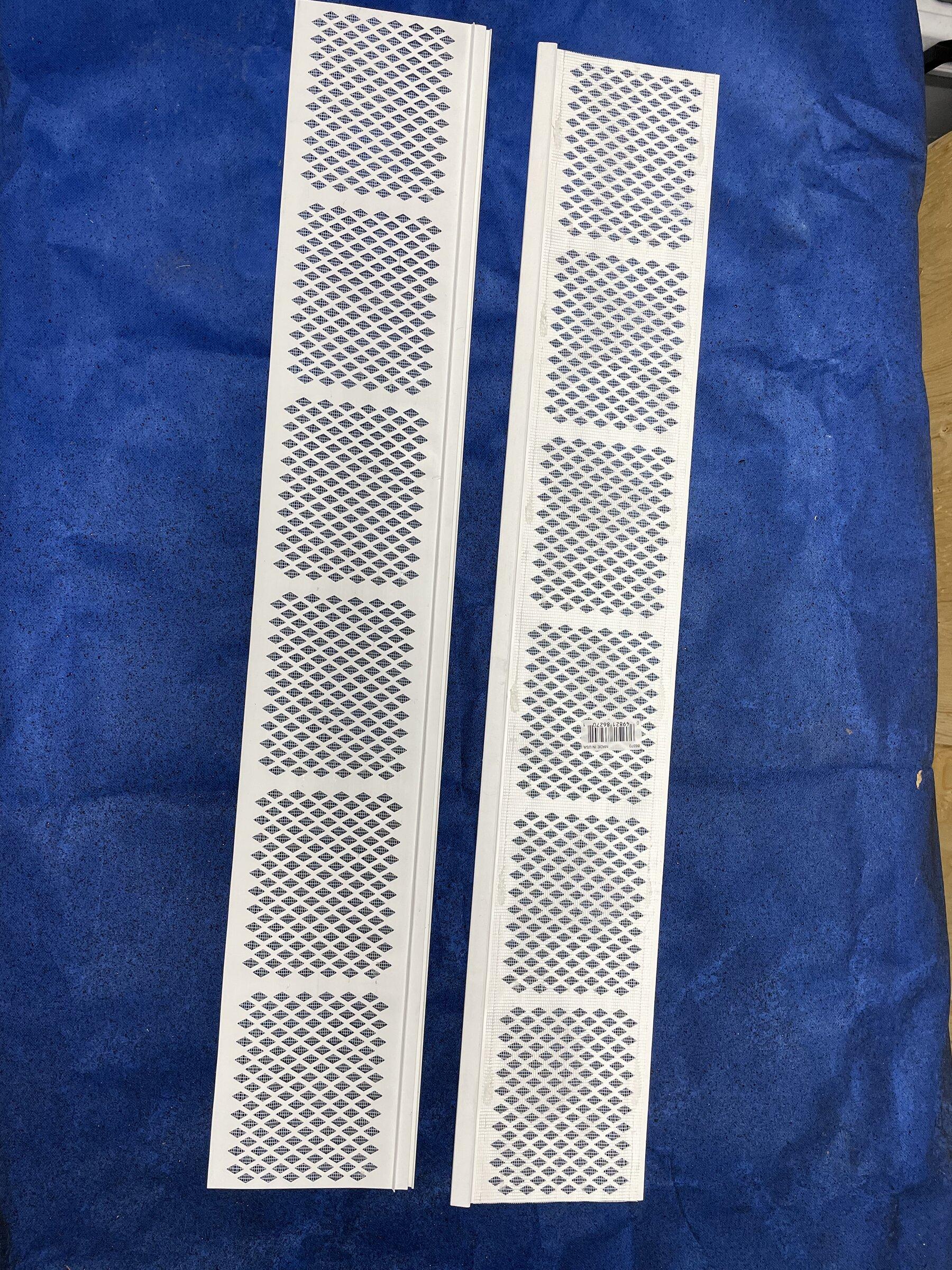

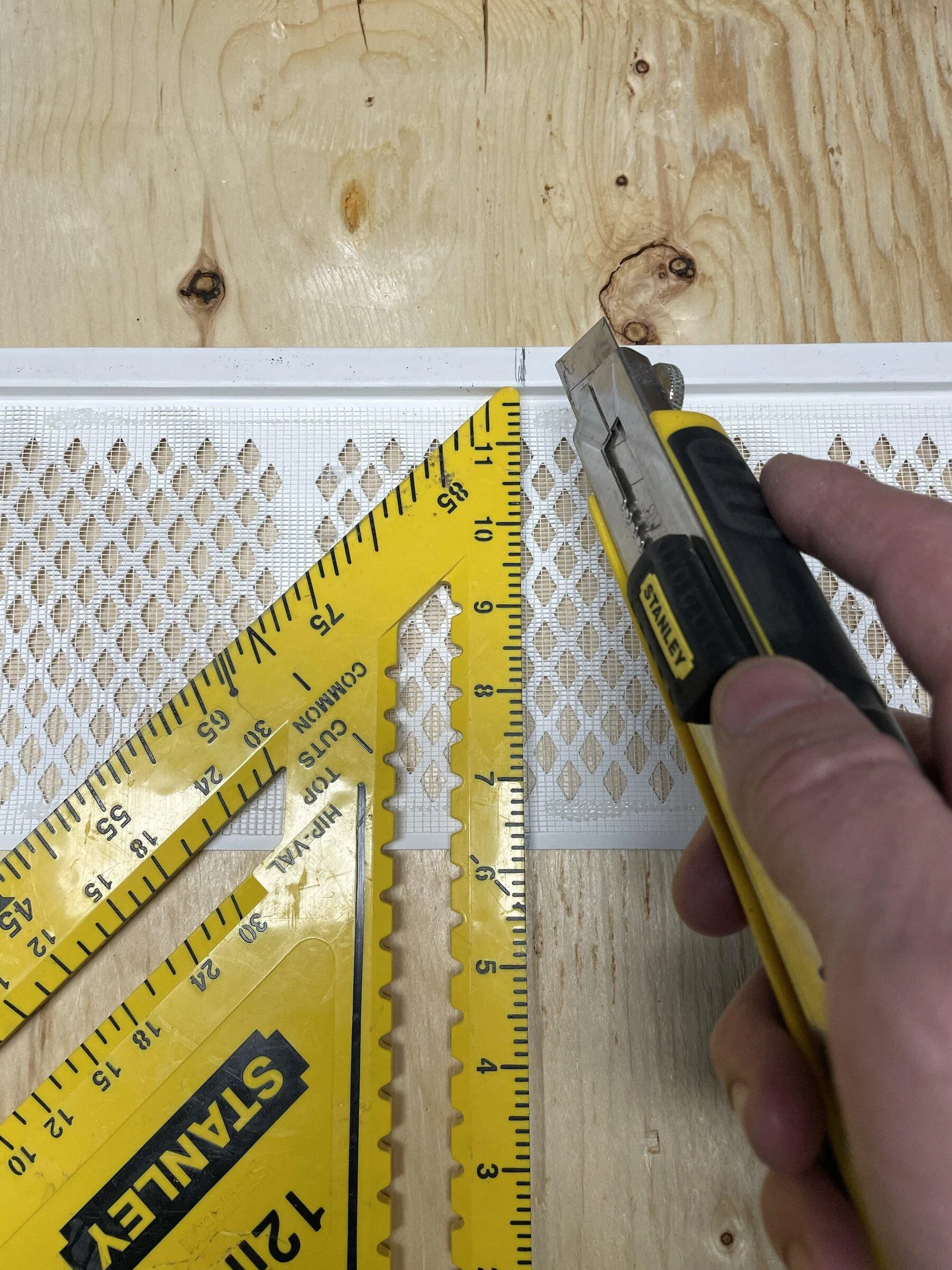

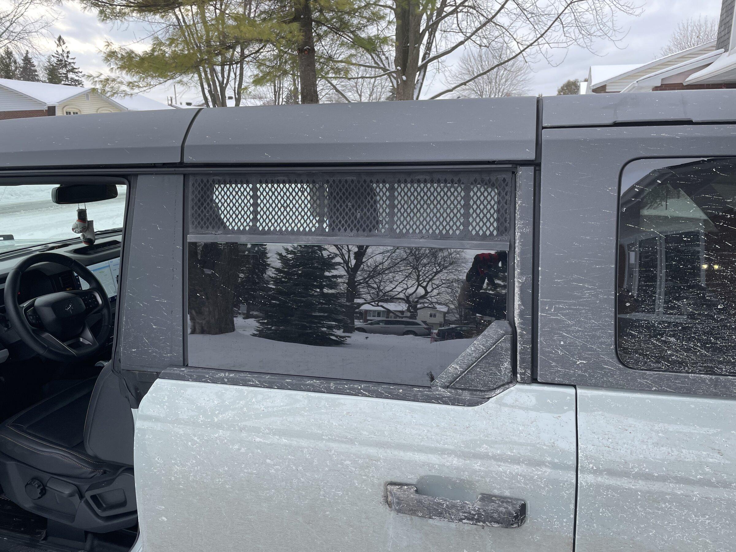

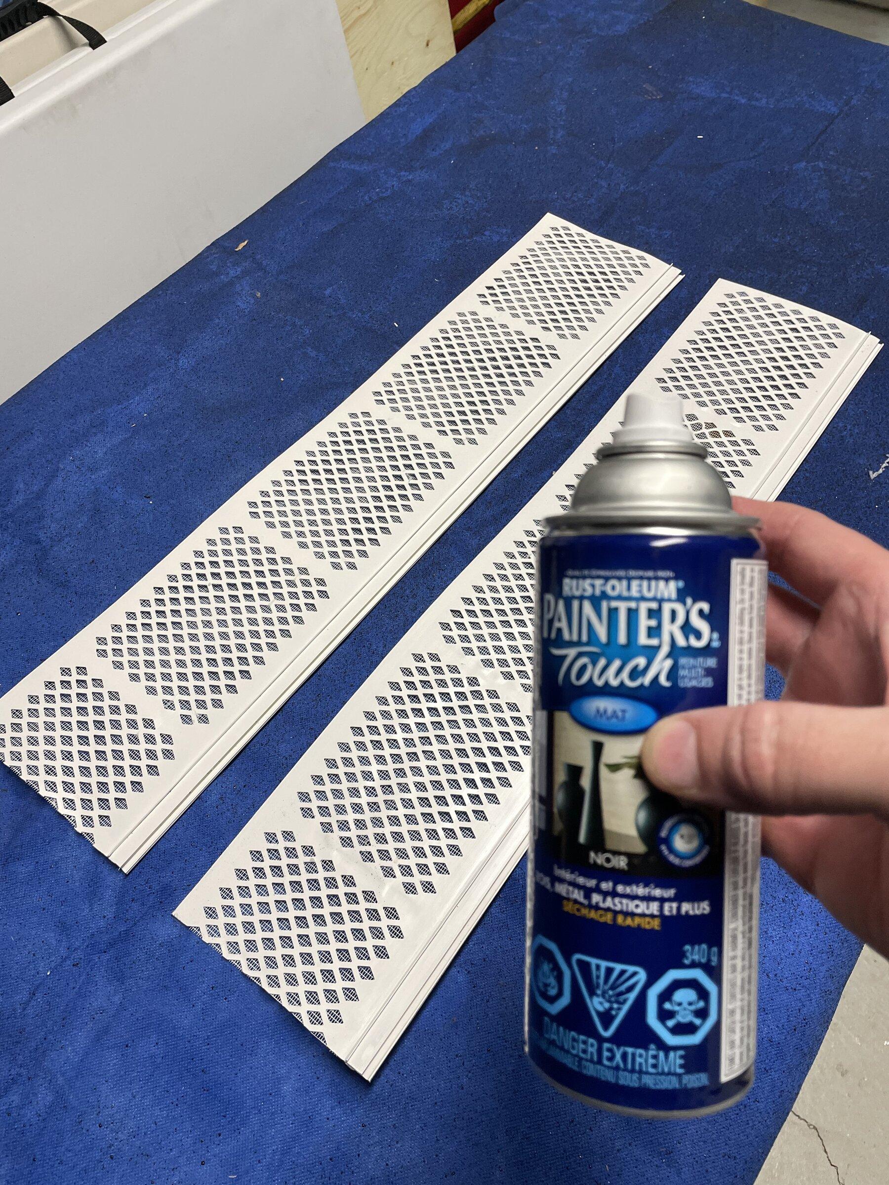

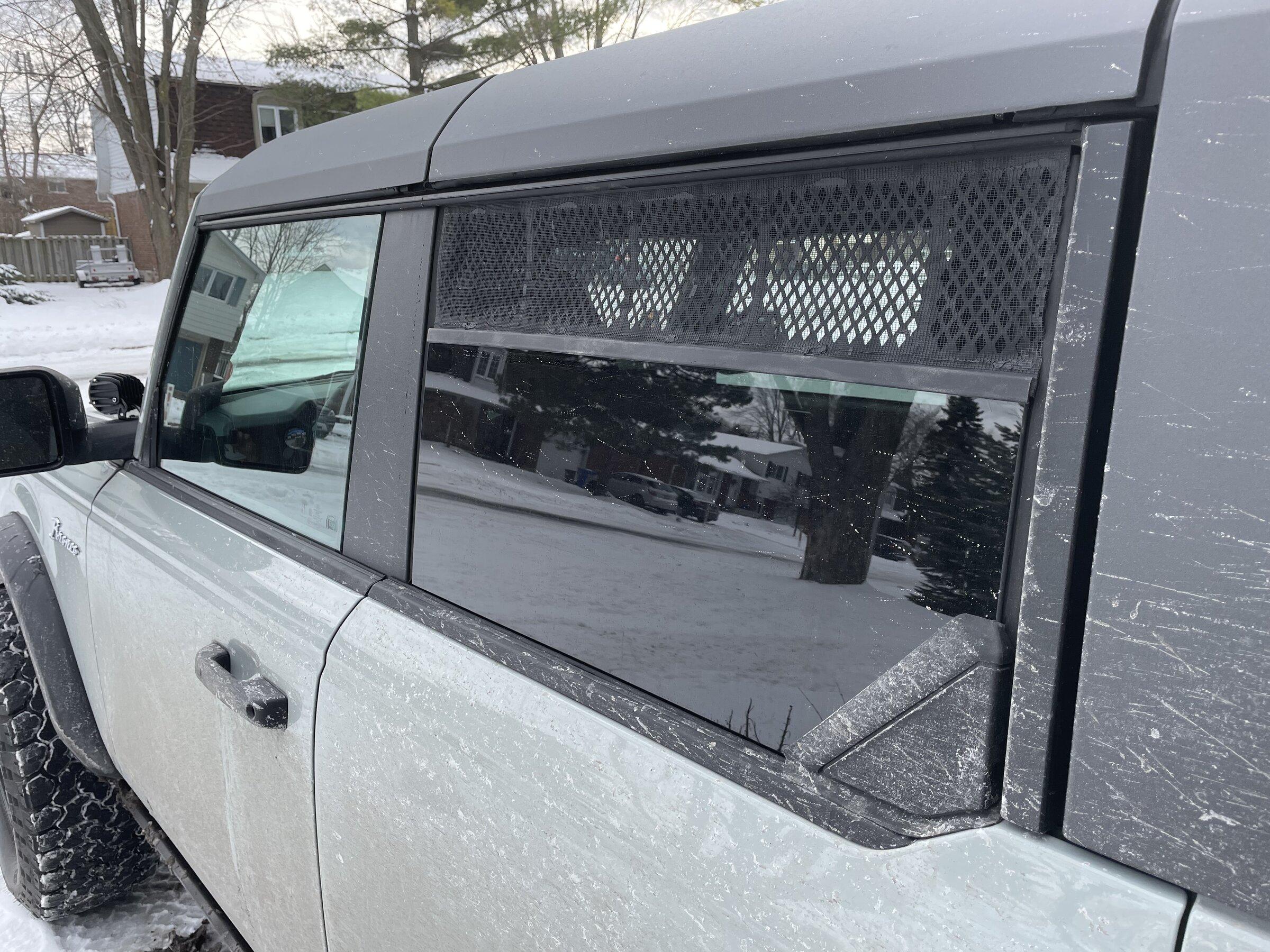

So I came across this solution recently on YouTube and decided to give it a try since the current options cost hundreds of dollars $$$. This option cost me about 5$ for both since I already had black spray paint and some Gorilla Glue.
I’m leaving on a 3 week road trip soon and wanted to have the flexibility of camping out in the Bronco as/if needed. I’m still putting my raised rear platform together but I’m waiting on some fabric and what not.
Anyhoodles….super simple project that should work great!
Warning! - I doubt this will suffice for no-see-ums (or however they’re spelled 😂😂😂) but one could easily upgrade the mesh that comes pre-installed.
These are gutter guards that are found at Home Depot (even in Canada) for under 2.50$ each. Pictures follow.

Well damn. I’m convinced there’s no original ideas left In this world. At least you’re able to make one that works just as well for a fraction of the cost. Nice work man.

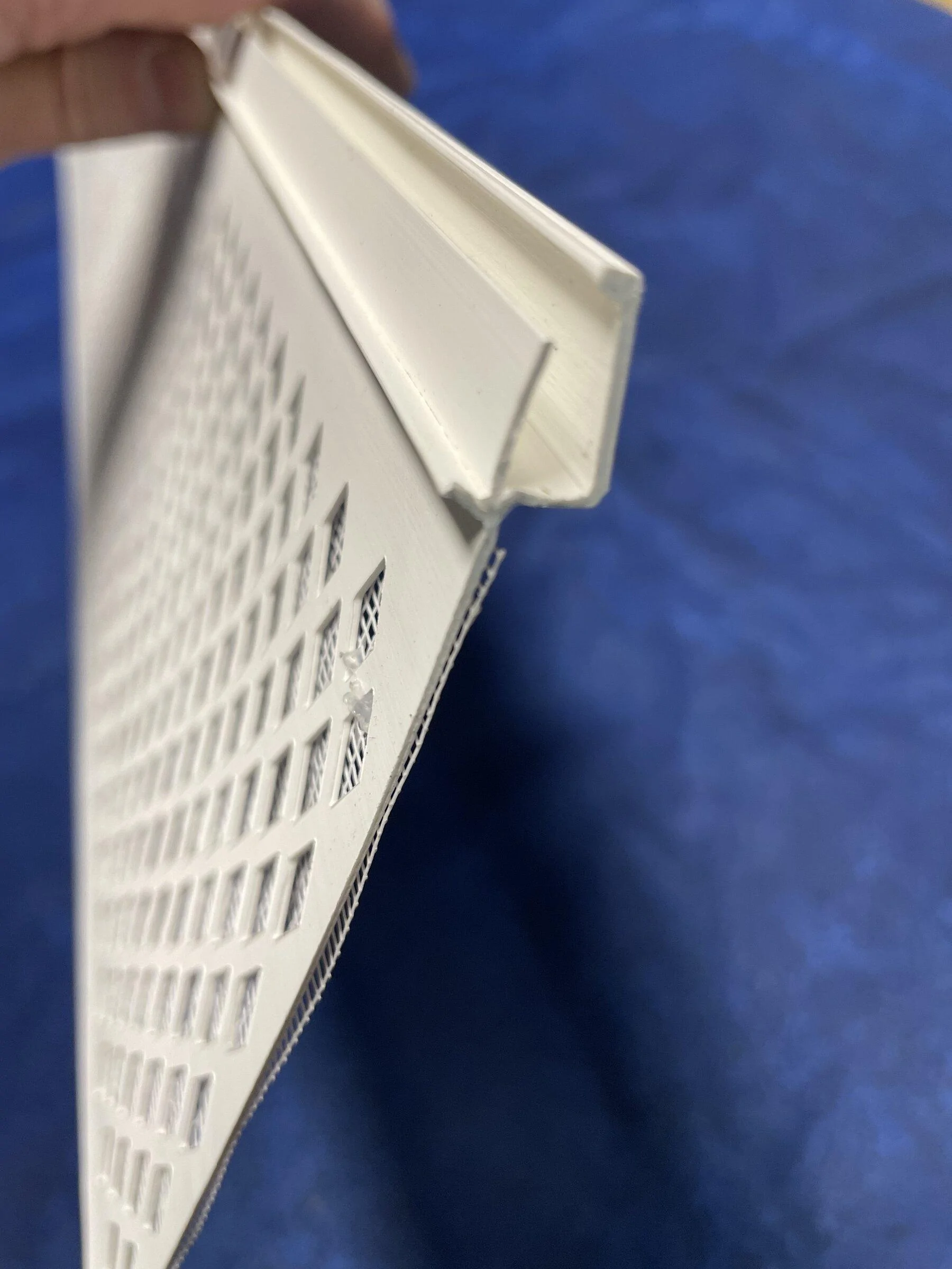

Thanks buddy! One unfortunate thing about the part I used is that the natural position (curve) of the gutter guard results in the mesh being on the outside. You could tear it off and reinstall it on the other side - or replace it with a higher quality mesh - and it would be a much cleaner end result. But for the number of times that I need to sleep in the Bronco - I couldn’t care less. 🤷‍♂️🤪

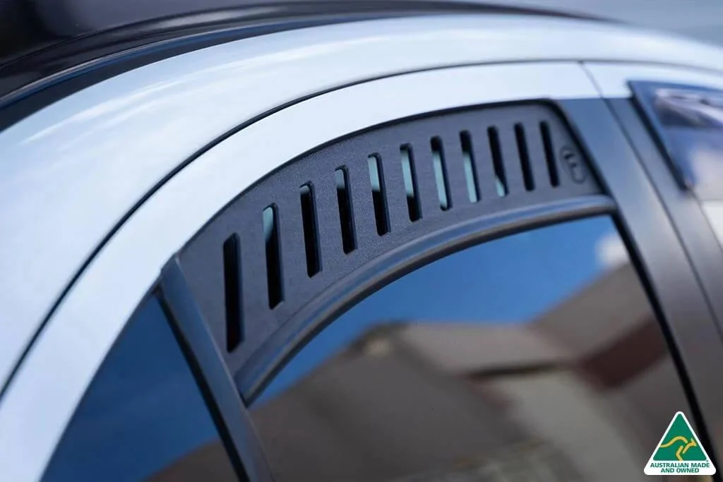

FWIW: we used to have these in our track cars as it greatly aided airflow in the cabin to have the rear windows open, but they still had to pass tech inspection. Having the front windows open was obnoxious with an open face helmet. Made from aluminum or carbon fiber typically though.

They definitely help if camping inside your rig. Without some windows being open the humidity level will suck. You’ll freeze more when it’s cold and sweat more when it’s hot. Good airflow helps with that. These with keep out mosquitoes as mentioned - but if you have no-see-ums in your area there’s no guarantee. You could double-up the mesh to help.
no need to change anything. They work. Be careful using any heat source for any reason near them - they’ll warp easily. I would imagine you could somehow add a bit of a coat-hanger frame around the perimeter (on the outside obviously) to give it better rigidity - but I don’t use them enough for it to matter.
