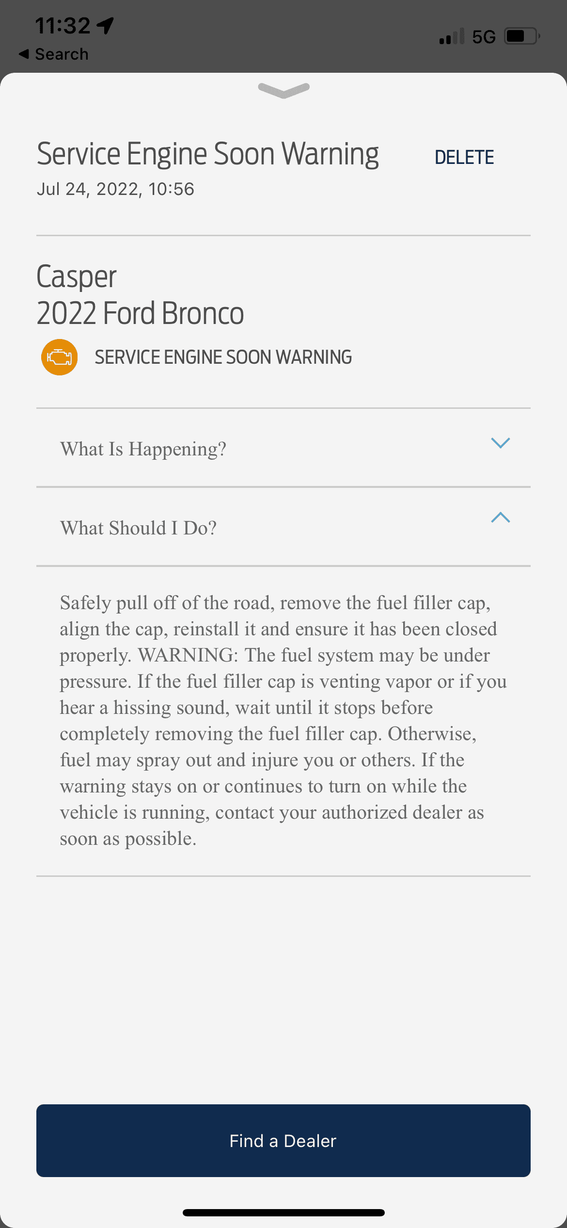

my check engine light came on today!!! i got my bronco less than a week ago! here’s what ford pass says.
anyone else have the same??? bringing it in tomorrow morning.
Same here. Awful! And check the fuel filler cap? There is none!! Ford has gone downhill. And the two closest dealers said they’ve no appointments for 3-5 weeks! Ford sucks.
Fuel filler cap, Lol. How does Ford not realize there is no fuel cap on the vehicle they made?
We’ve same issue. Now third time on 2022 bronco wildtrak. Going to start lemon law process. Awful quality control.
