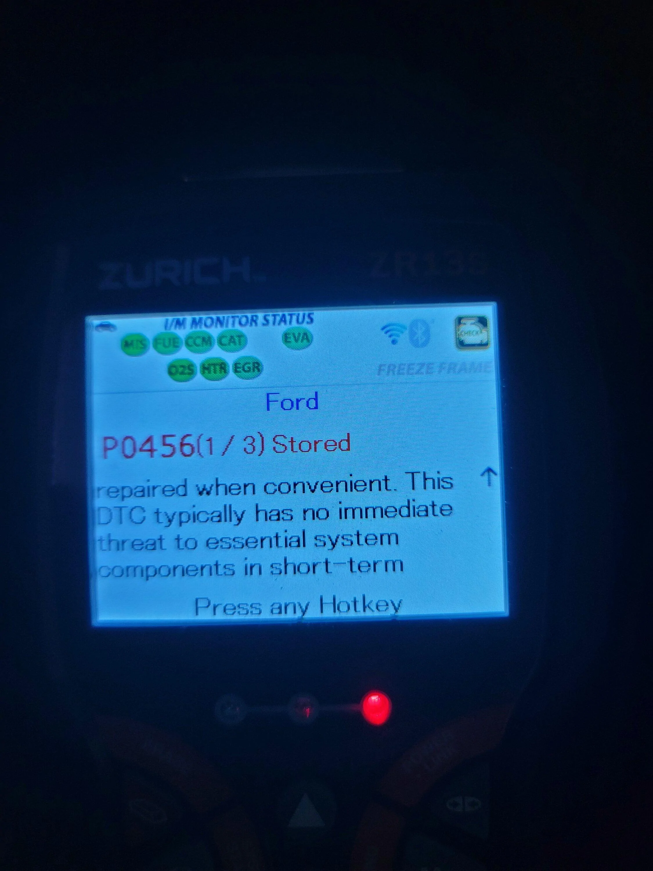

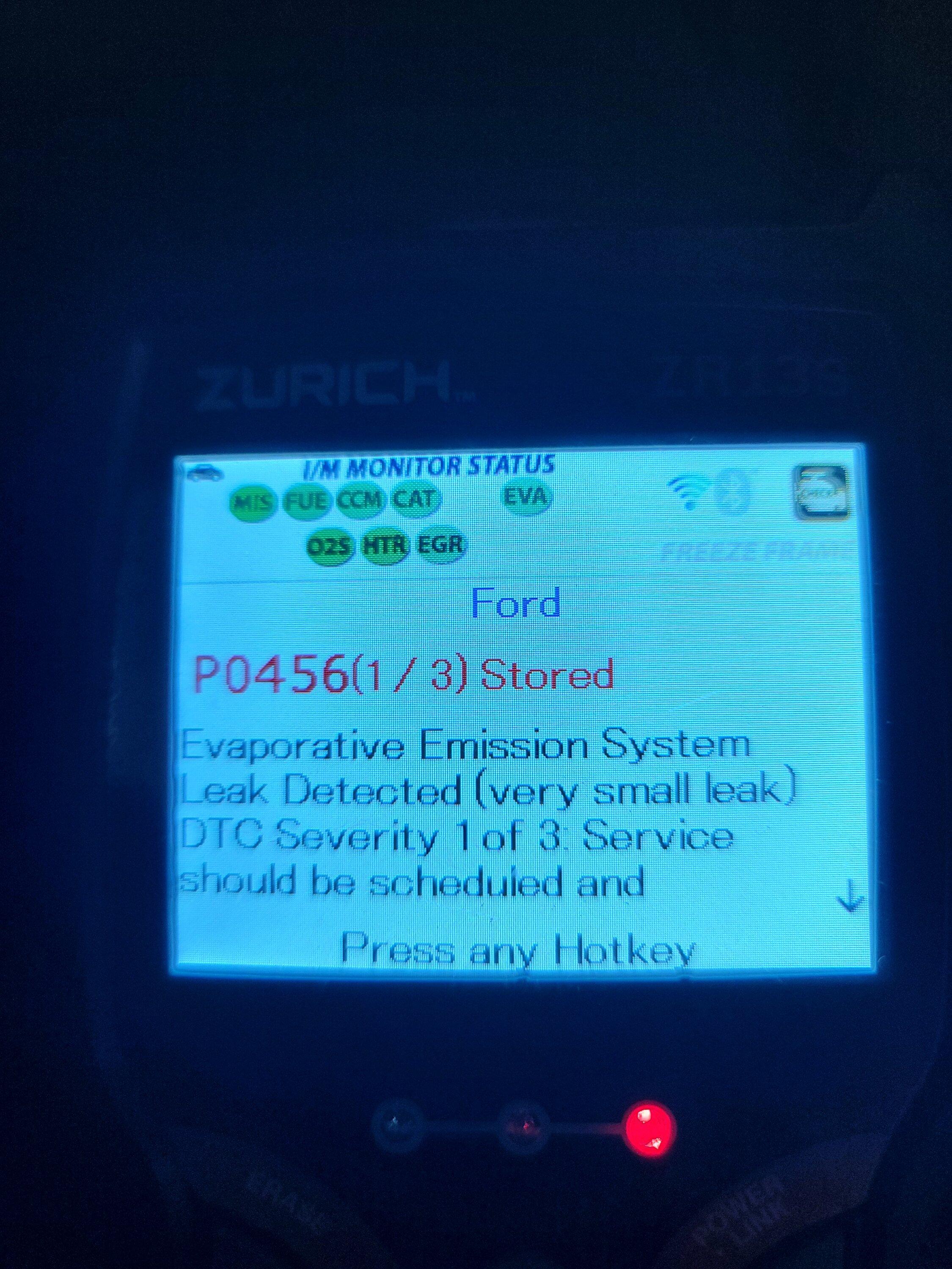

I have the same thing going on. My code reader showed a "P0456 Evaporative Emission System Leak Detected". I cleared it and it came back a couple of days later. I have a service scheduled on 8/2. I had to call around to a couple of dealers. The first dealer told me they were a month out on check engine light repairs!!??

my dealership told me they were 6 weeks booked for appointments & i said “i haven’t even had it for a week!!! you need to fix it today!” i took it there before they opened. the check engine light turned on yesterday when they were closed so i couldn’t make an appointment.

Mine did the same thing the other day.... My code reader showed a "P0456 Evaporative Emission System Leak Detected ... Hot in Texas right now... pushed the little flapper a couple of times on the fuel tank... cleared the code.... never came on again... that was 2 weeks ago...

I had the same P0456 code just come on on my 2013 Taurus SHO. I have a cheap Craftsman OBD reader.
The fix was getting a replacement Evap Purge valve for under the hood. Keep in mind that my car is 9 years old with 84k on the clock. Not sure why a one week old vehicle would dothis unless something popped loose. Good luck.
