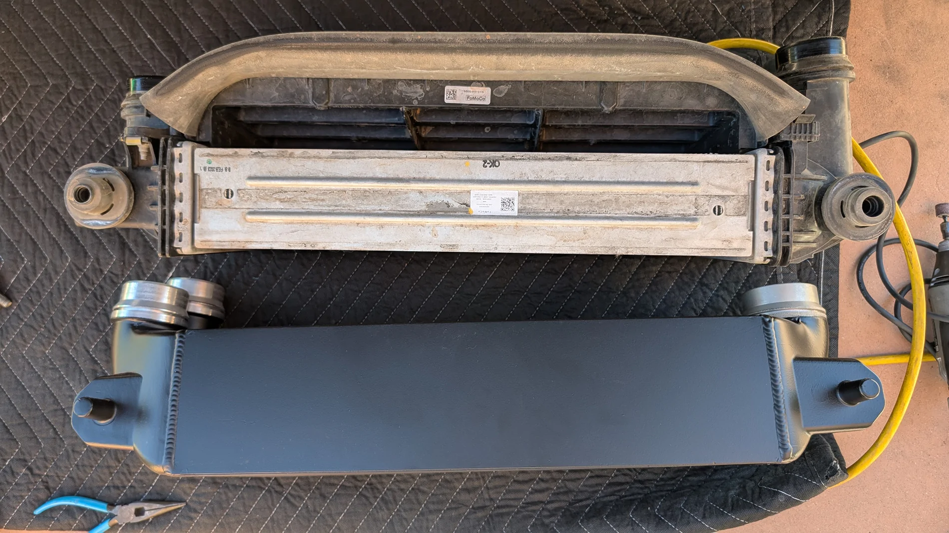

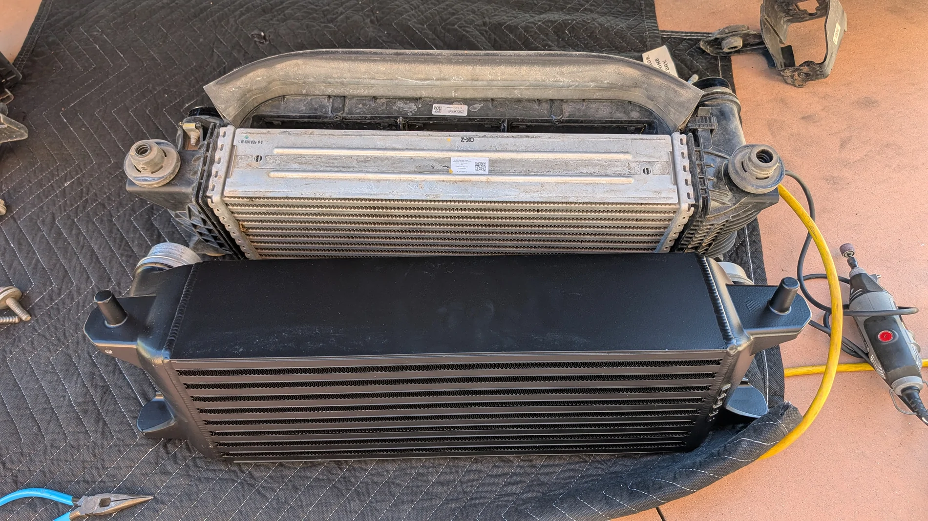

What are your thoughts on losing the rear intercooler cooling fins?
swamp2
swamp2
Dec 19, 2022
156
4,040
4,188
There is no loss of fins, the rear, non-motorized shutters are lost. The sheer size of the Cobb (a significant increase actually, largely it's depth) is obtained in part by not using the rear shutters. Obviously, looking at the cooling data, I'm not concerned.
Some of us were discussing the purpose of the motorized shutter system as it certainly adds cost and can't help performance, thus it's likely an emissions thing. Faster warm up, means less time with less complete combustion.

Yeah the rear shutters. I just installed the livernois unit and it doesn’t reuse them either.
the rear shutters close when stationary idling. The radiator fans draws vacuum from above, negative pressure behind the intercooler, the rear shutters close, and draws air from the front across the intercooler. Likely the front shutters are commanded open. Ultimately to avoid extreme heat soak at low mph, idle, crawling. When moving forward the pressure is no longer negative, rear shutters open.
So it does what the intercooler efans on the f150 raptor does. It’s a pretty slick design. Part of me is sad to have given that up.
To your point, the sheer size of the unit and data you’re showing may help overcome the loss even in that single use case. :beer:
