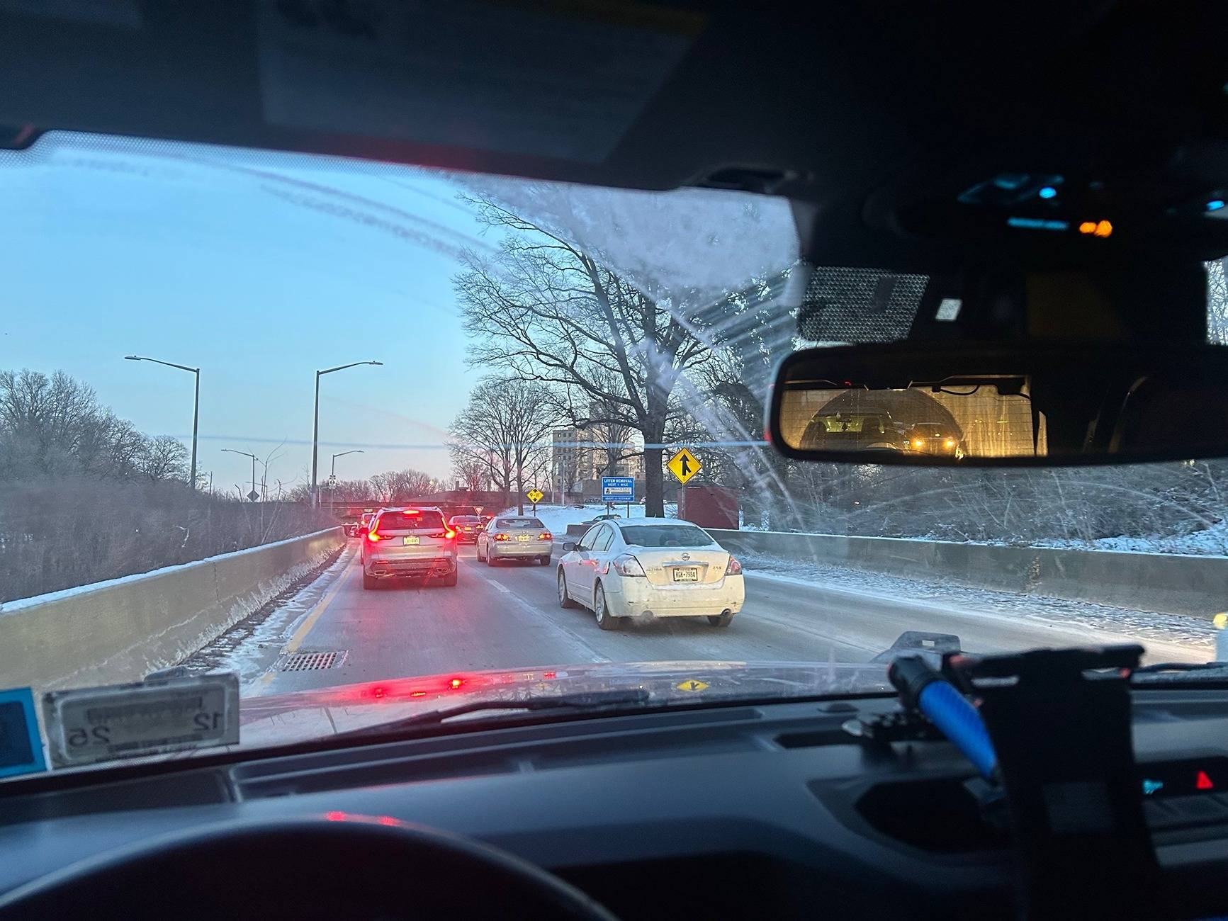

So I have no noticeable chips in my windshield, and also have a deflector installed. I go out to the garage this morning after 20 degree temperatures last night. I get in and have a foot long crack starting at the very top of the windshield and going straight down/slight angle. So my question is, I have read the threads about chipping Bronco windshields, but this one is new to me. Thoughts?
I am shocked to not see more crack issues. I was driving to mountain to go snowboarding and frozen 9 degree and trying to warm wipers with max defrost..... crack. My son said dad what is that line across the windshield? Just crazy and Ford tells me only insurance to replace. I had no chips or any stress on glass. Just cracked from drivers side full across to passenger A Pillar.
