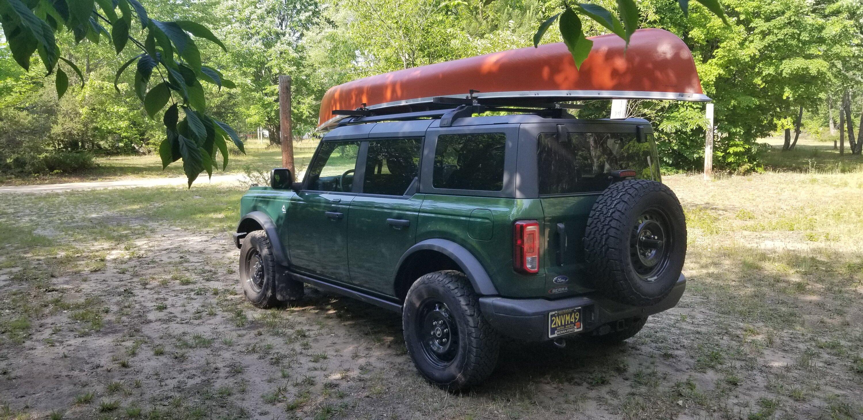

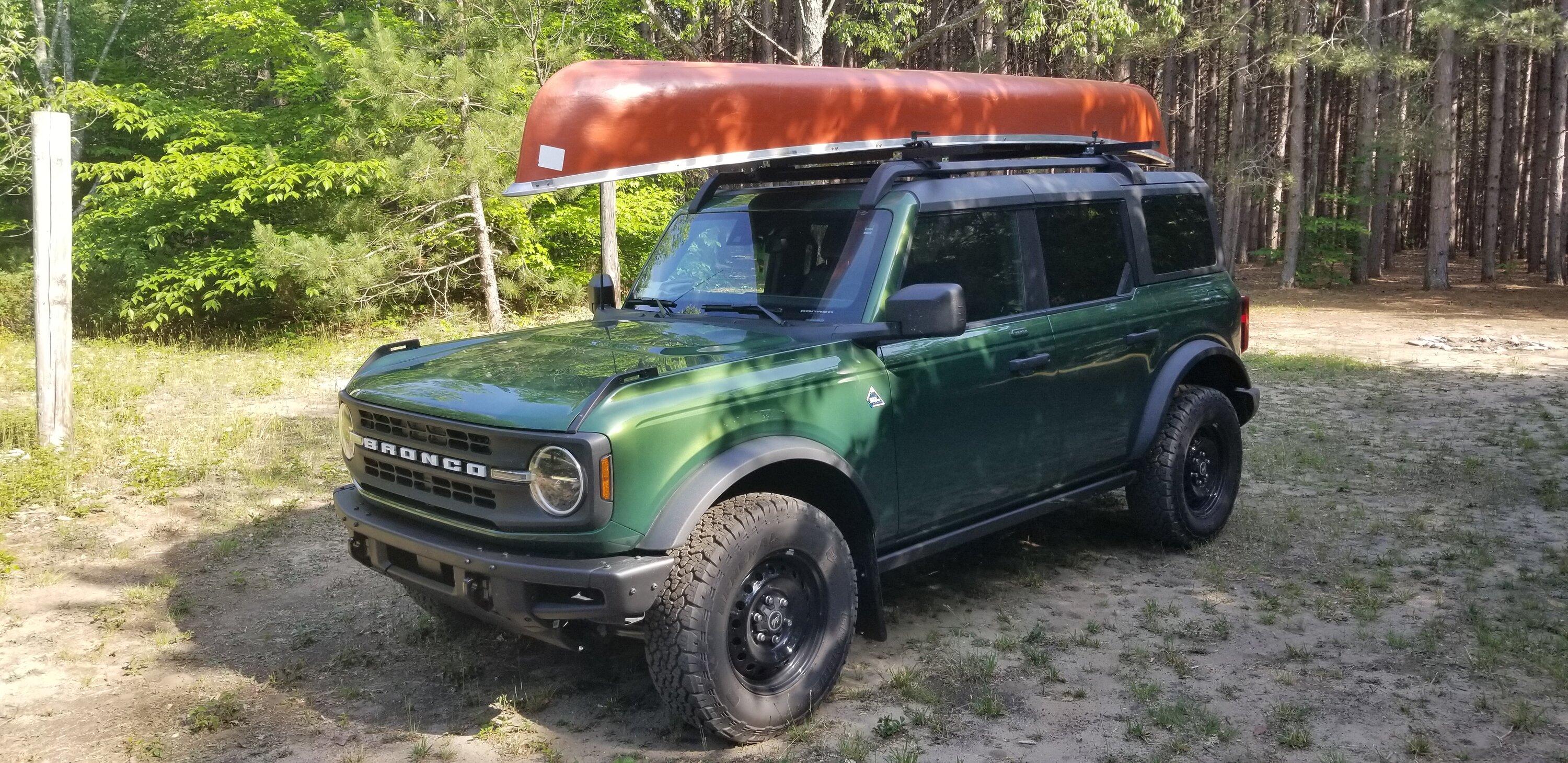

For over 30 years I've been reusing some simple clamping hardware that my father-in-law fabricated from steel plate and threaded rod moving it from rack to rack with vehicle changes. With the arrival of my BD Bronco last year I began envisioning the latest adaptation. Made of simple wood construction, I fabricated 4 mounting blocks that are coped to clamp around the profile of the factory cross bars and attached 2×4 cross bars to mount the hardware and accommodate the width of my canoe. The clamping hardware is removable, secured to the cross bars by the same 4 toggle bolts that secure the canoe via embedded square nuts. The best part, no straps or guy cabling required. Oh and saved me hundreds of $$ on premanufactured mounts and cross bars. This is no doubt the sturdiest version yet thanks to the factory rack mounting. I test piloted it over the July 4th weekend. It performed as expected - really well.

The gunwhales are aluminum and clamped down by 1/4" steel plate with an L shape lower plate with upturned leg. These are contoured to the profile of the canoe so even if the toggles came loose, and they never have, the profile of the canoe would not allow the canoe to come free. The toggle bolts are 3/8" dia. I have only transported this Coleman canoe so can't vouch for the performance of this method with other makes or models.

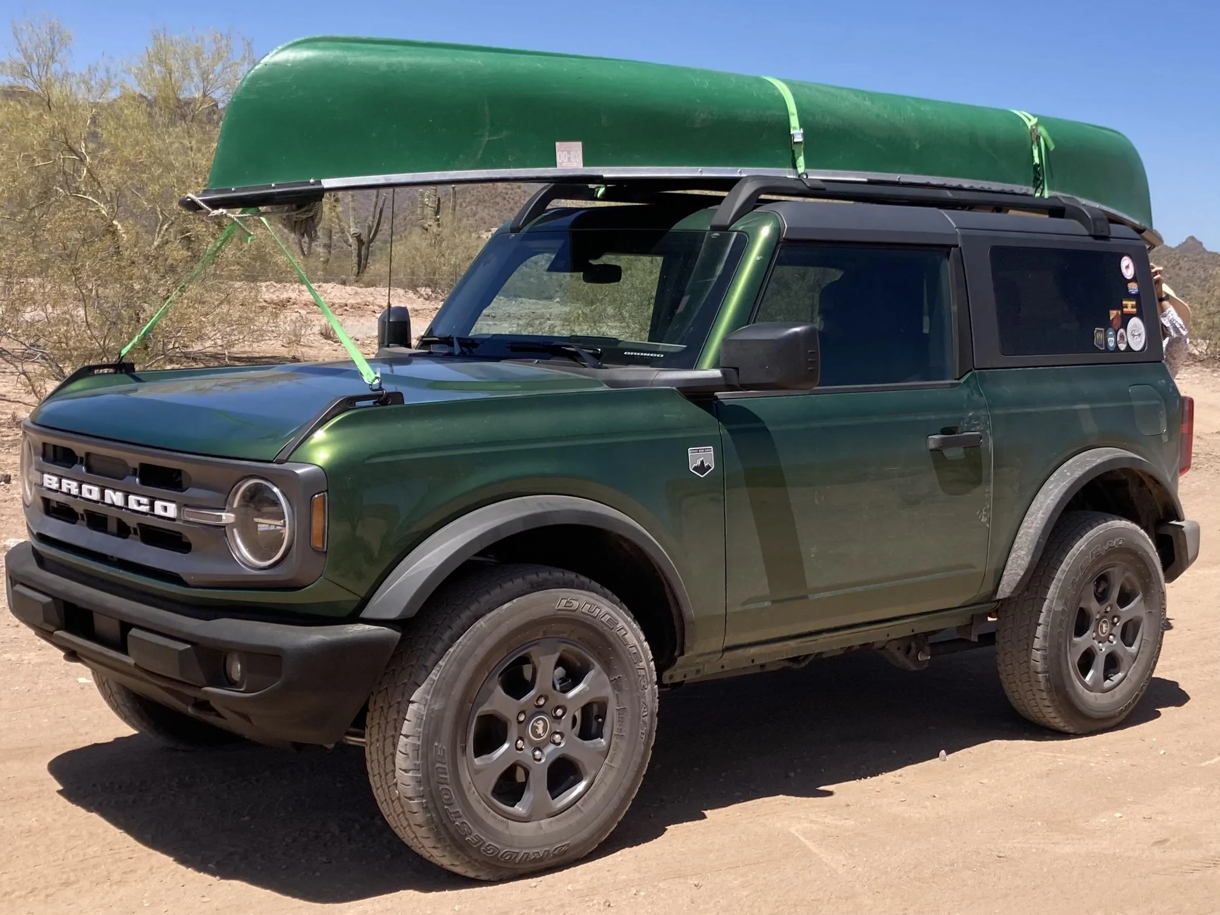

The standard rack with four tie down straps. 1 in the front, 1 on the back, and 2 across.

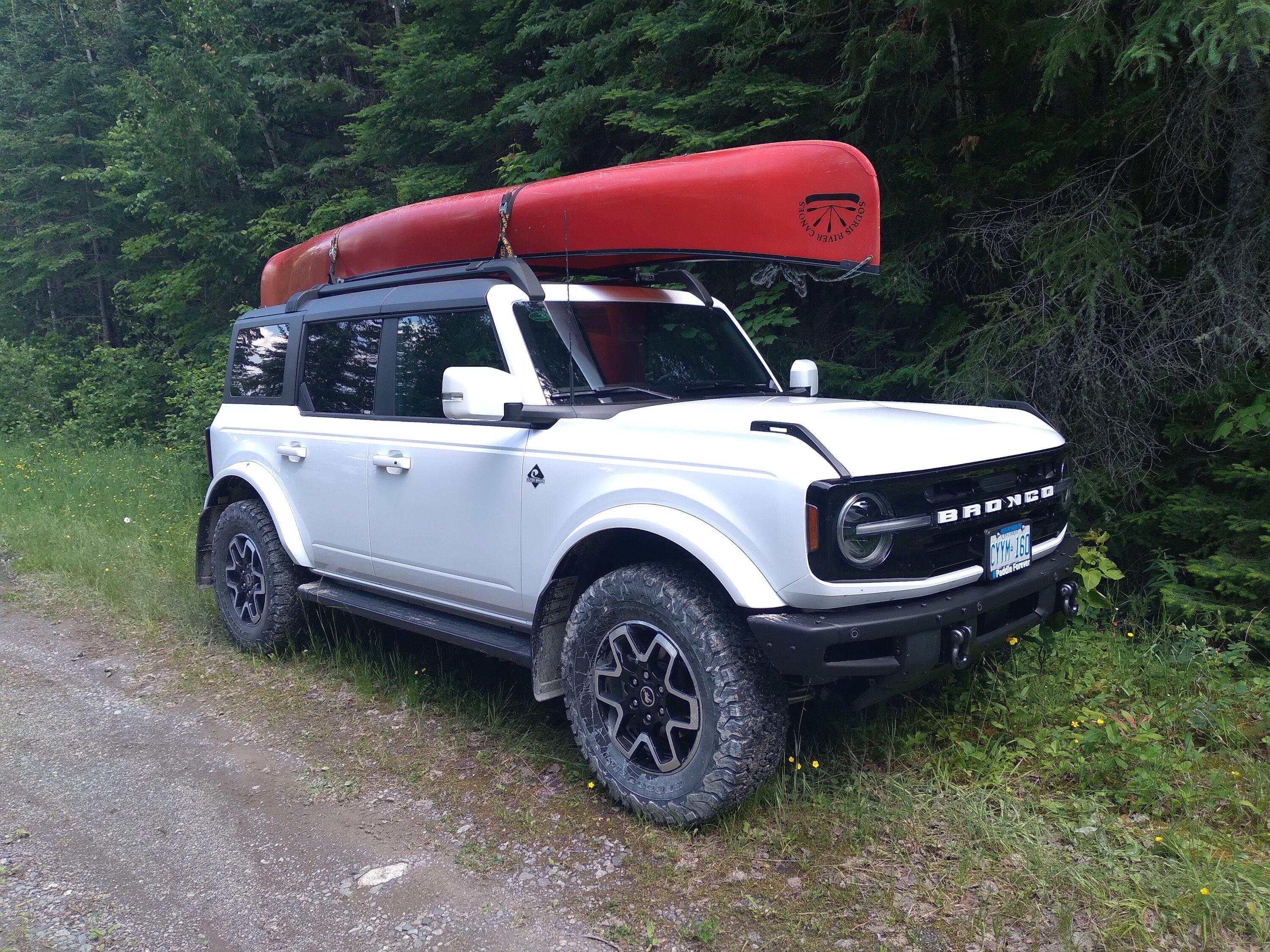

. The Thule's form nicely to the gunwale contours both back and front. They are also rubber padded. I moved the crossover rack to the very front which seems a better configuration for canoe carrying. Happy paddling.
