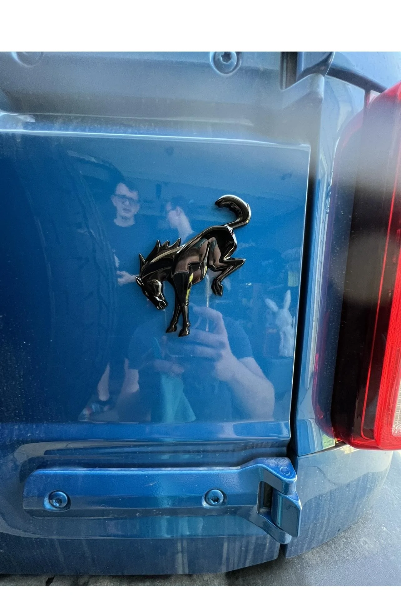

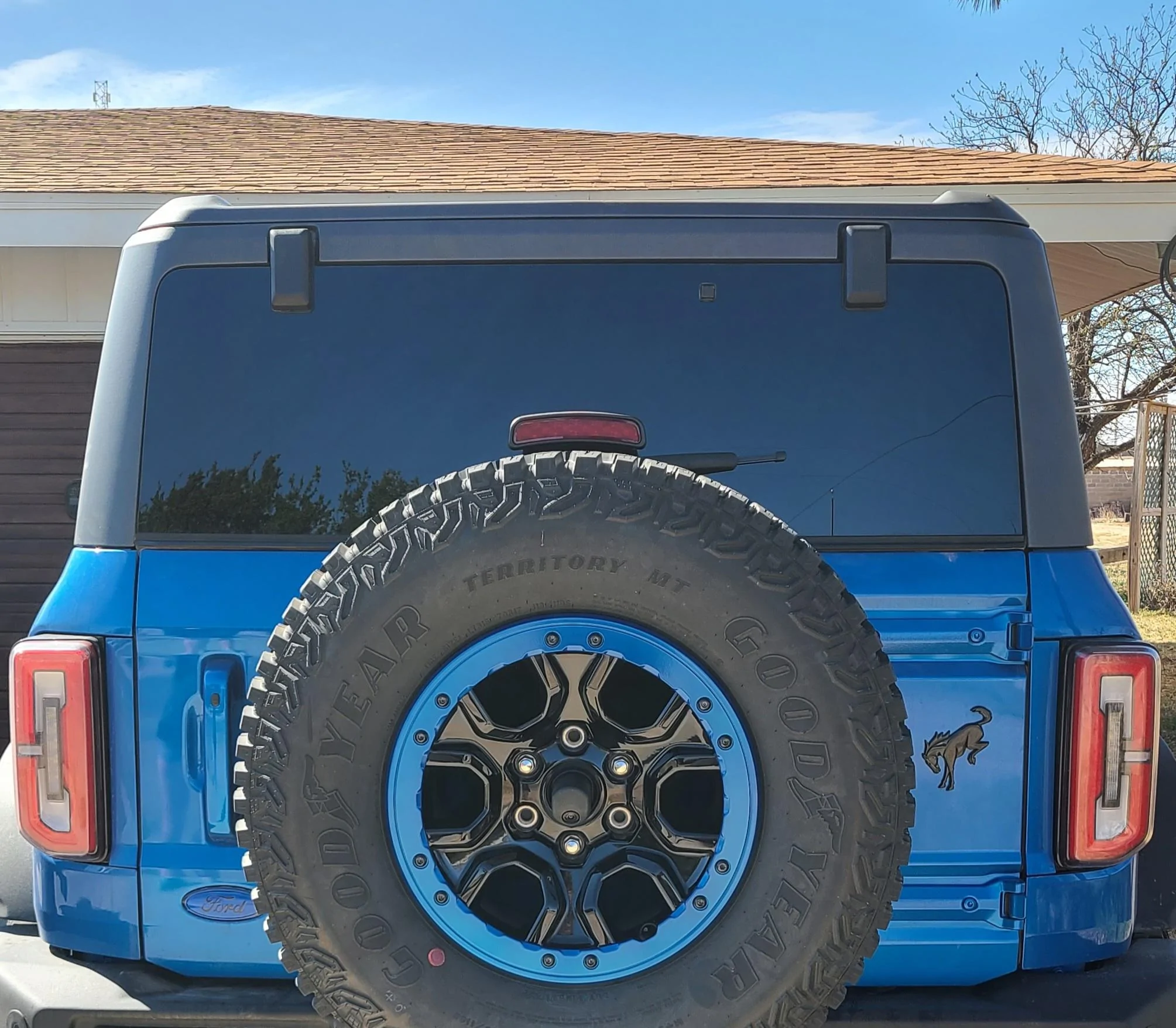

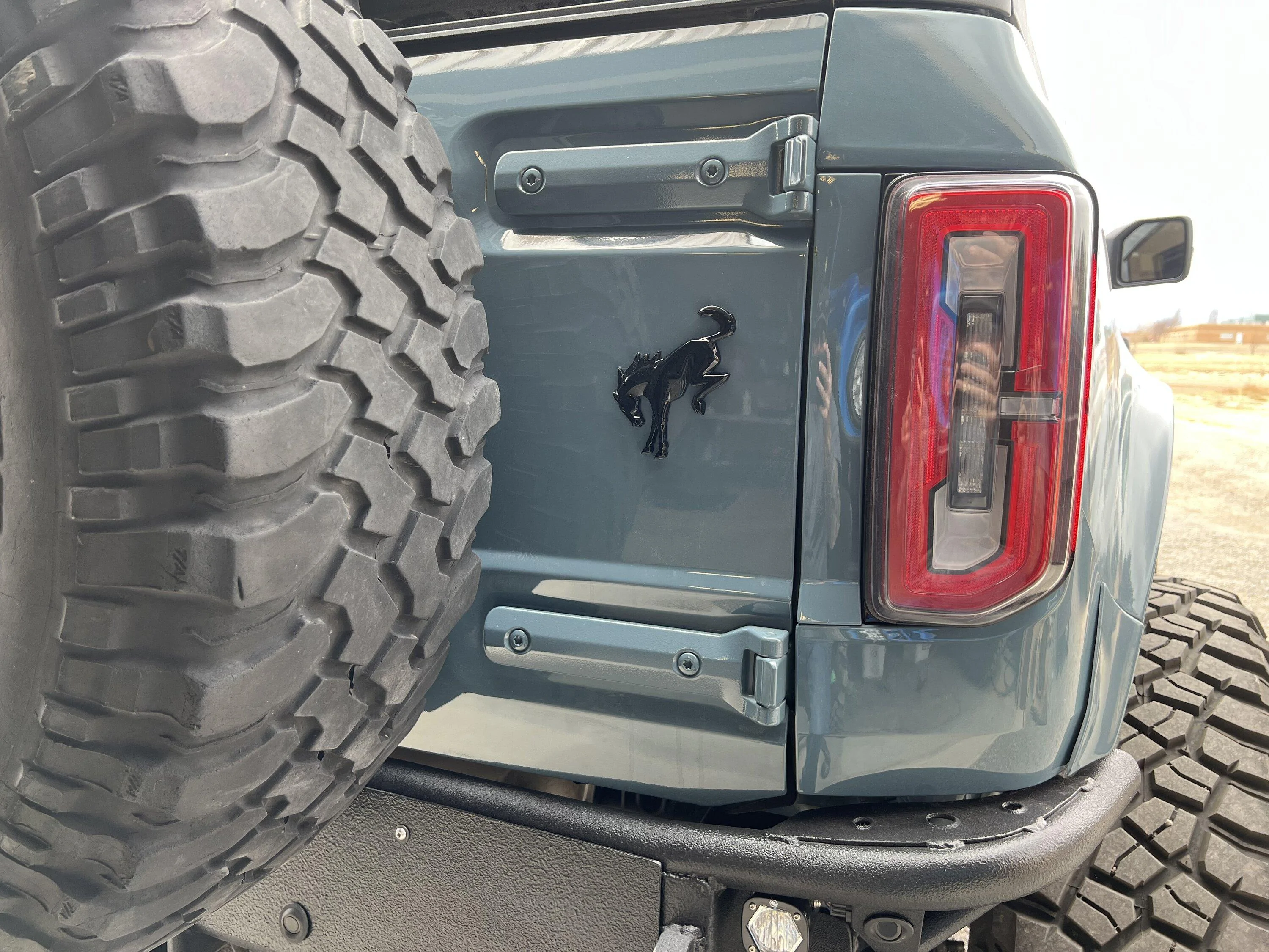

Swapped out my Chrome Bucking Bronco Rear Emblem for Ford OEM Gloss Black Bronco Emblem like Wildtraks have. Super easy process. If any one else is thinking about doing it, go for it.

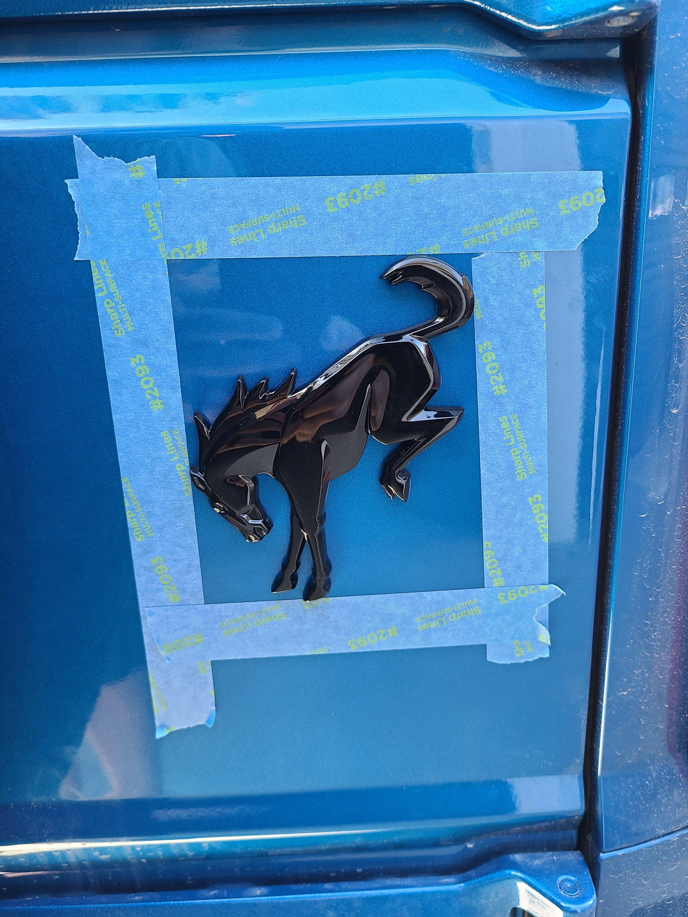

Step 1: Tape off chrome emblem with painters tape to ensure the new one will be in same location.

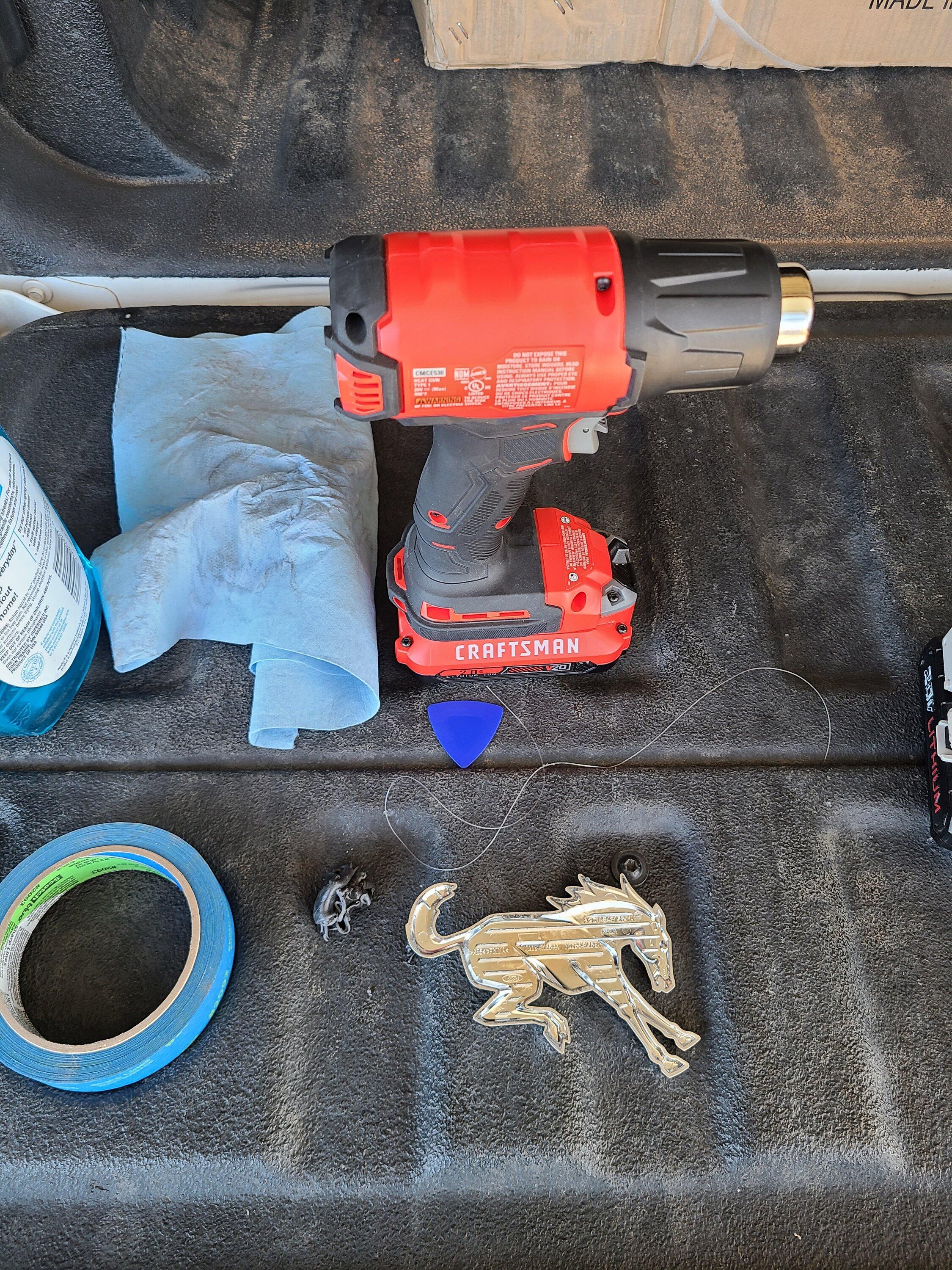

Step 2: Use heat gun on emblem for about 30 seconds to a minute until pretty warm to touch.
Step 3: Use fishing line to get behind old emblem and pry it off.
Step 4: Cleaned area of residue with thumb first to remove leftover 3M adhesive then use microfiber cloth and windex. Dry area with microfiber cloth.

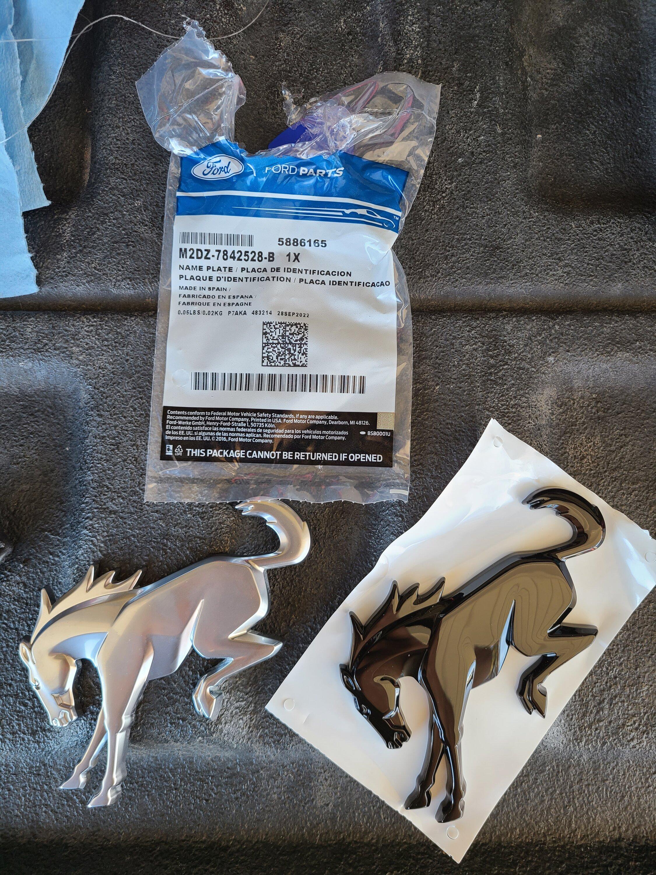

Step 5: Remove backing of new emblem and line up emblem inside painter's tape. Press down firmly on emblem to ensure adhesion.
Step 6: Remove painter's tape and admire new emblem.
Supplies: Heat gun (or hair dryer), fishing line (or dental floss), microfiber cloth and cleaner, OEM M2DZ-7842528-B Black Bucking Bronco Tailgate Emblem for 2021-2023 Ford Bronco https://a.co/d/2zIIc5s

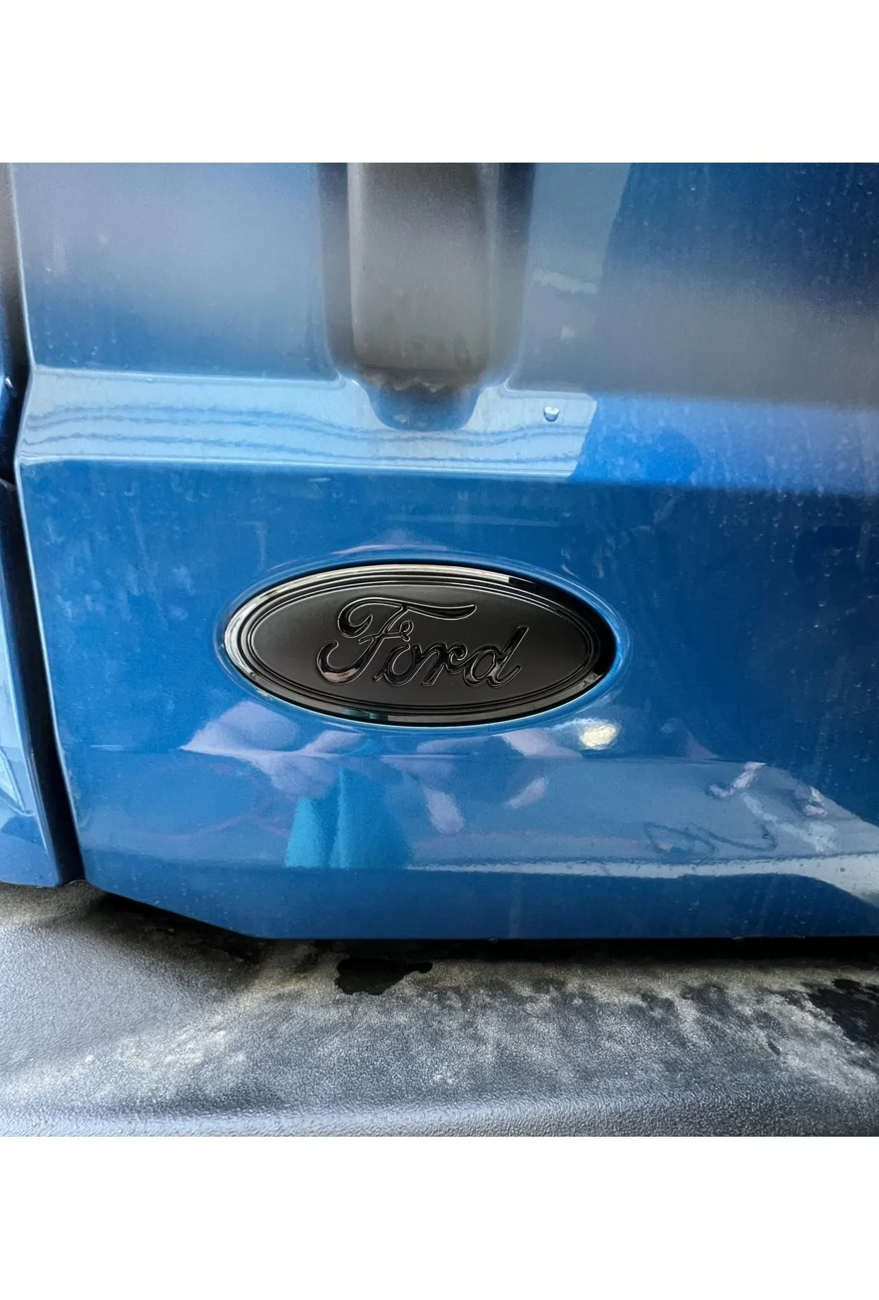

This will be helpful for others looking to do the same thing. I swapped out the silver Bronco emblem for a black as well. And also swapped out the Ford emblem with an all black replacement from Etsy.

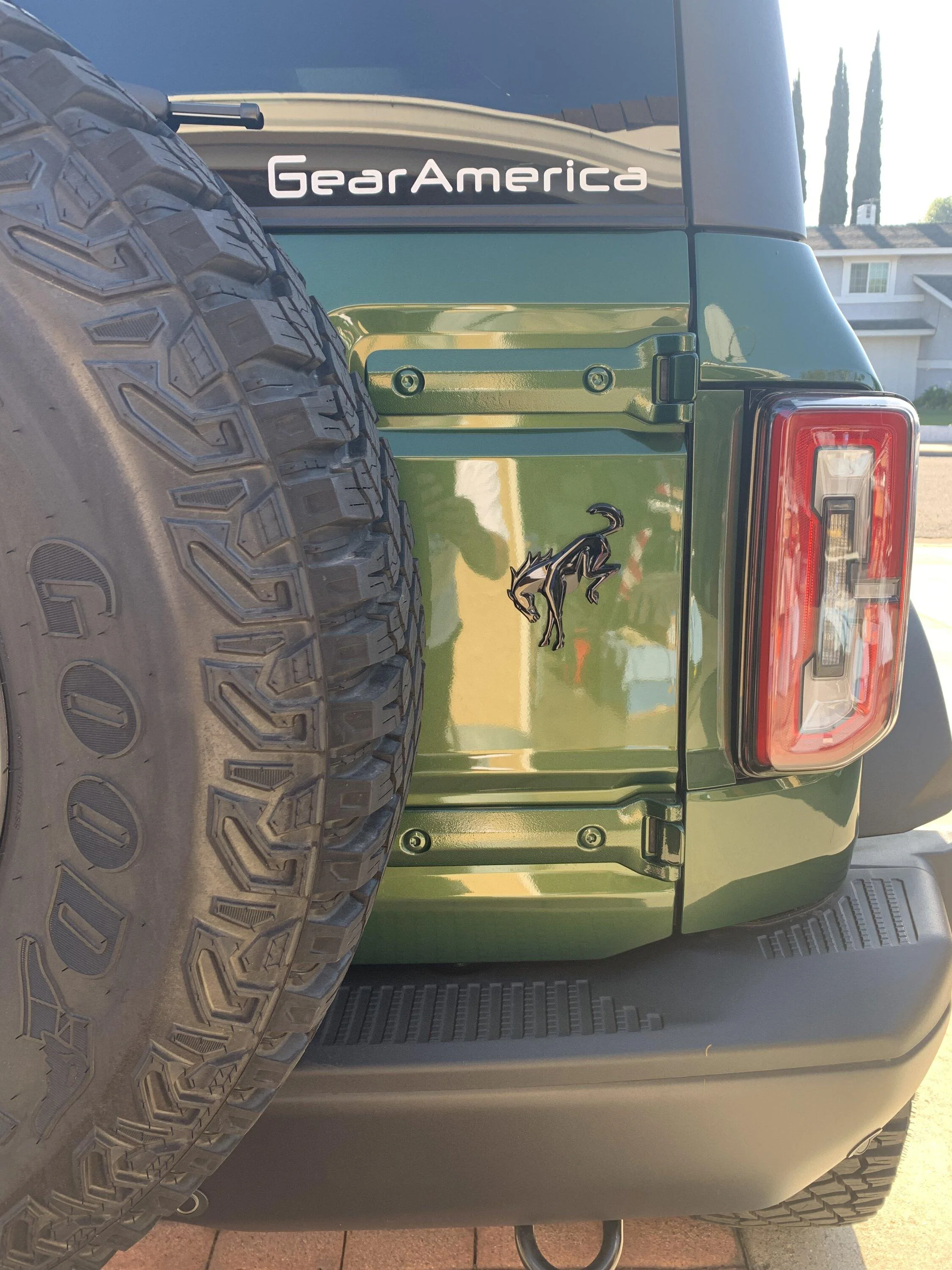

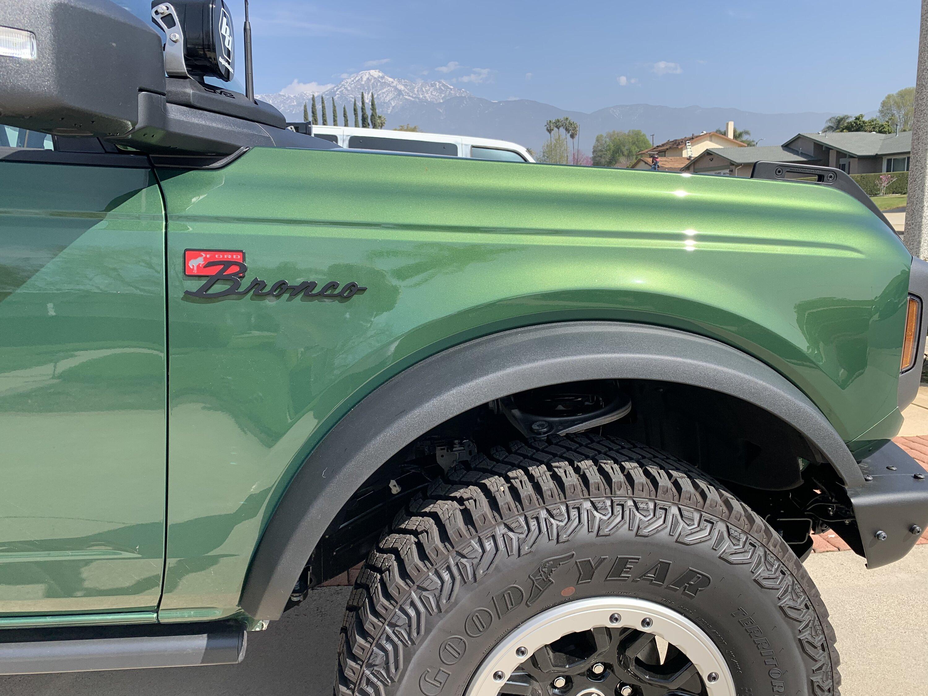

I added the black Bronco when I added the Black Script on the fenders.
