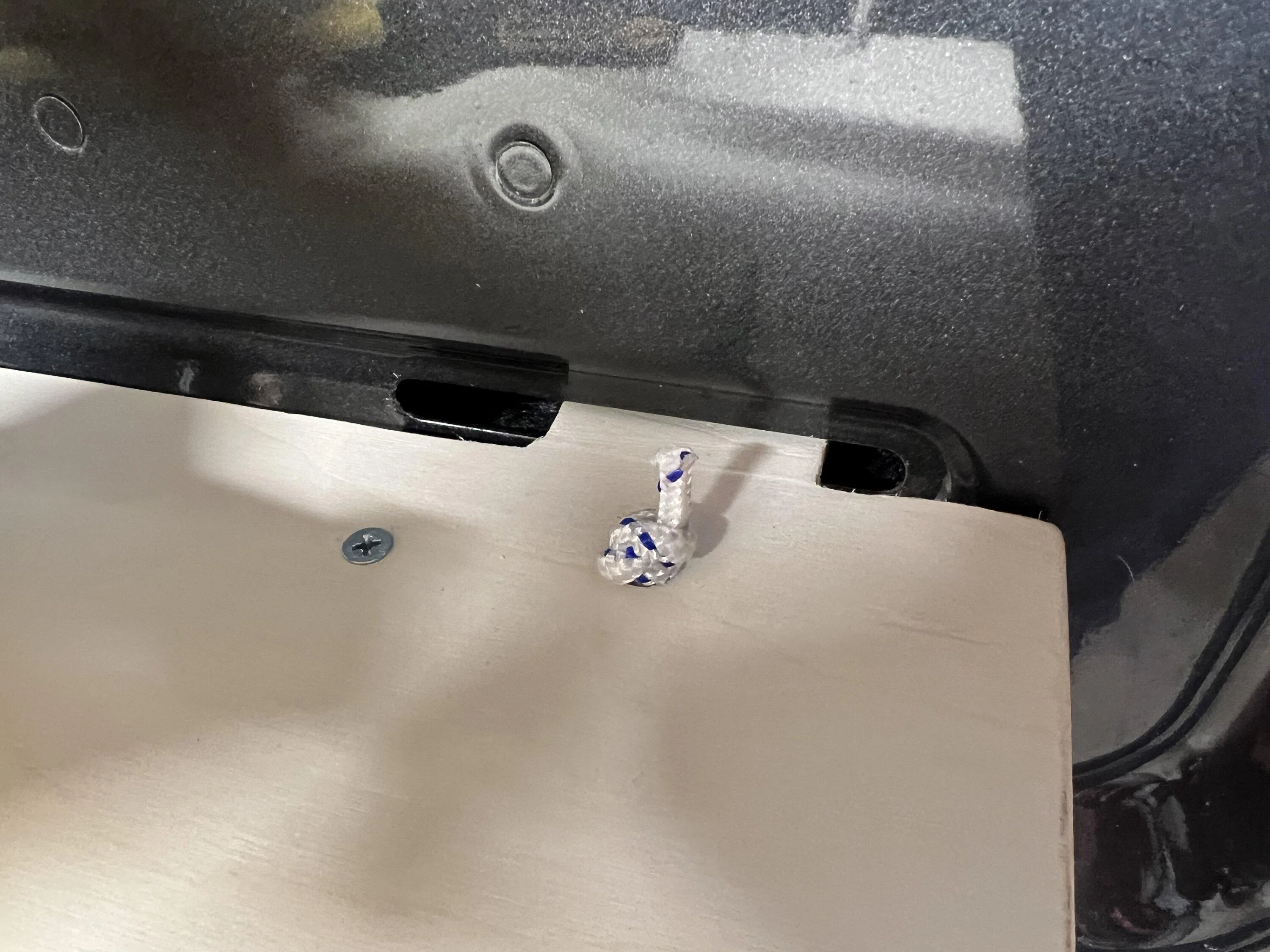

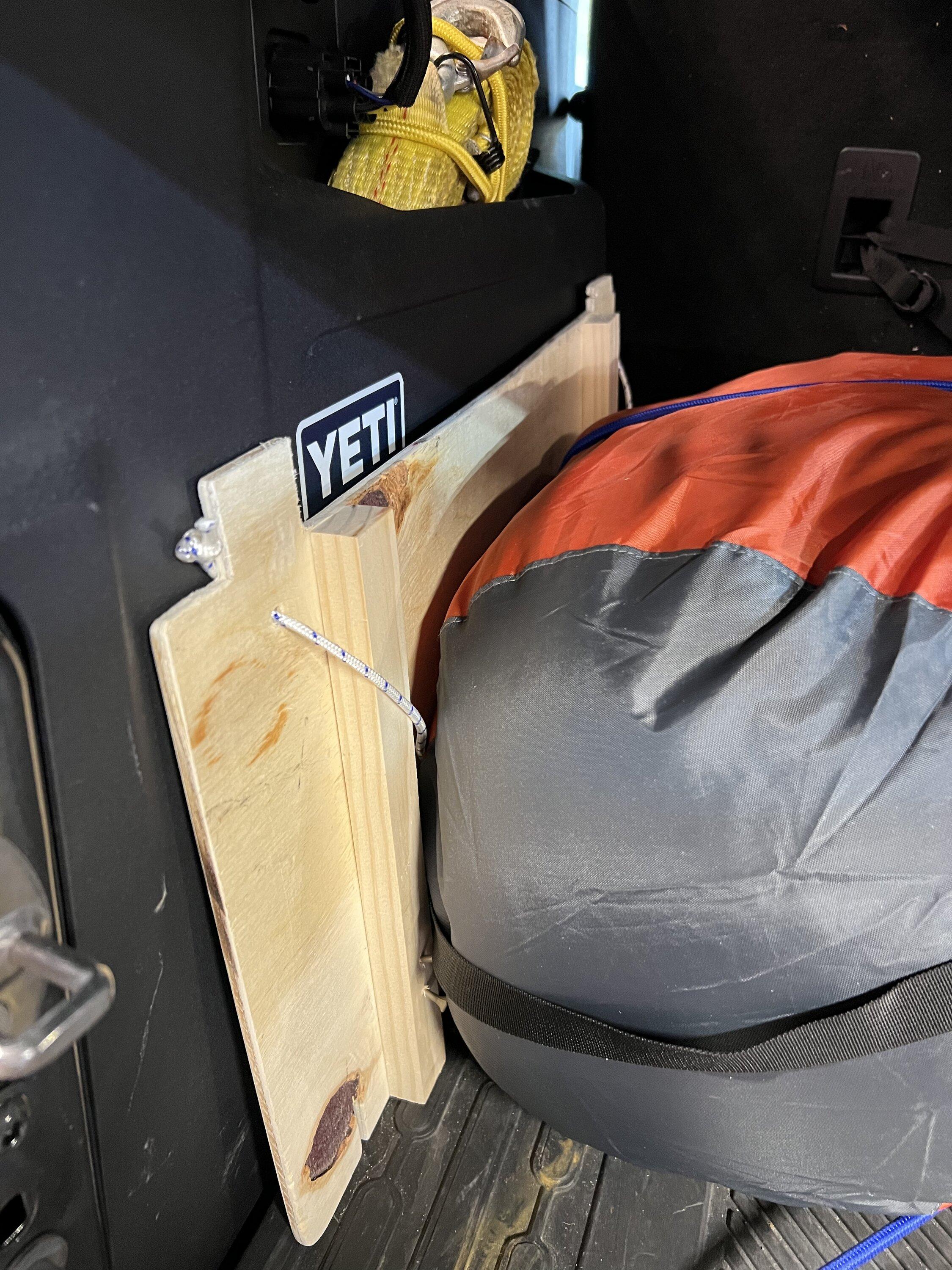

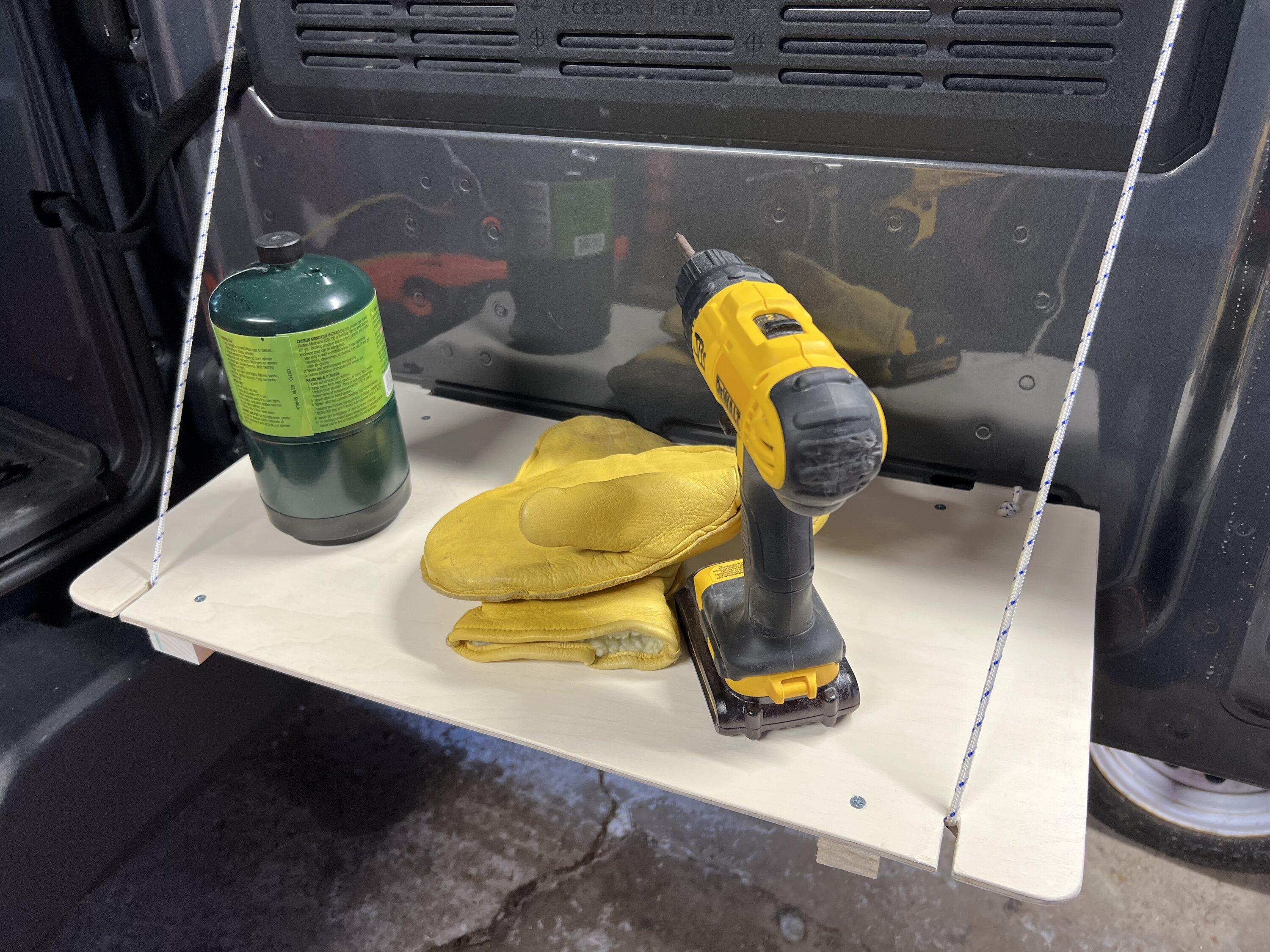

Wanted a place set beer and snacks at the ski hill parking lot. Didn’t want to dish out for a factory tailgate table.
Simple and cheap build!

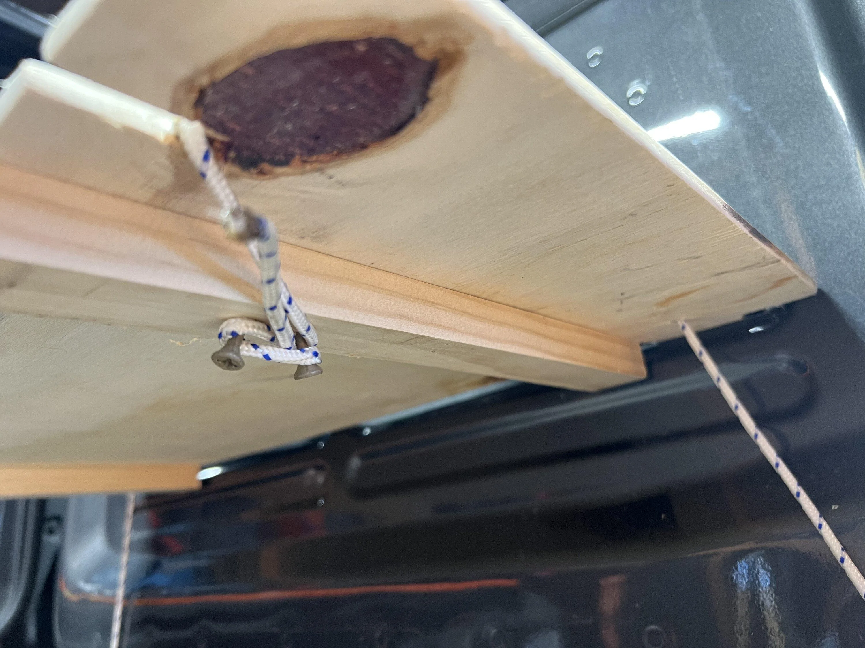

Ford Bronco DIY Tailgate table 38D3740E-CCF8-42F4-A668-DF60A447EEC2
The key is the cleats on the underside so I can adjust tension as the rope stretches over time. Very easy to set up and take down. Each rope wraps around the tailgate. Takes up minimal space in the trunk!

After looking at this and reading about the build, I think you failed. I don't see said beverage on it so it didn't happen(-;
Now that is a great idea if you aren't needing to hold a lot of weight.

Who’s to say it wasn’t in my other hand!?
and yes it’ll be great for what I need. Probably wouldn’t put a full toolbox on it
