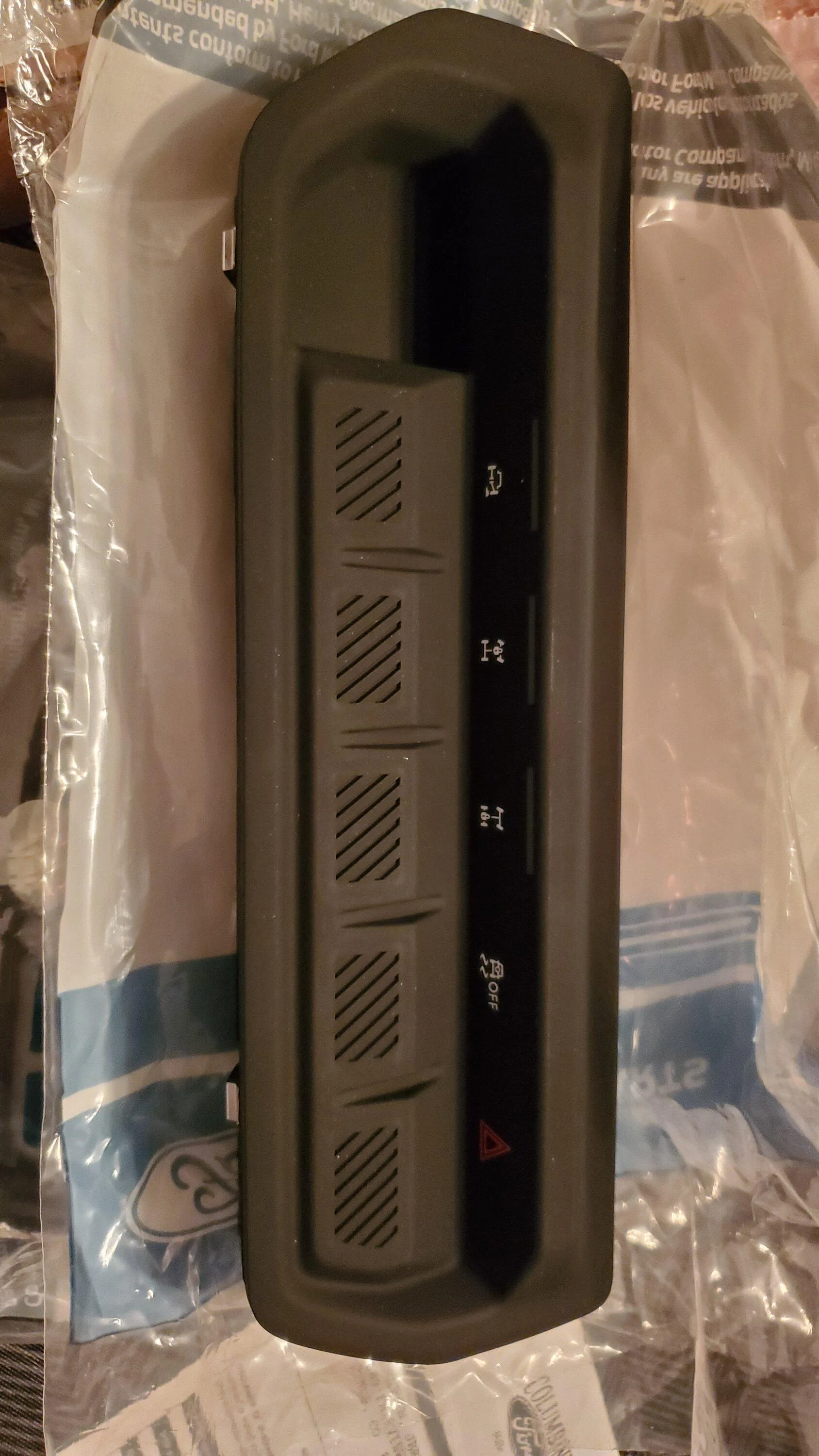

Anyone who has a Base, BB, or BD with Sasquatch package and manual transmission, is your hero switch front locker, rear locker, TCS, and hazard? I just bought the hero switch and used a Big Bend with Sasquatch package, manual and the switch also has the swaybar disconnect.
I would like to just have the 4 buttons. Does it exist?

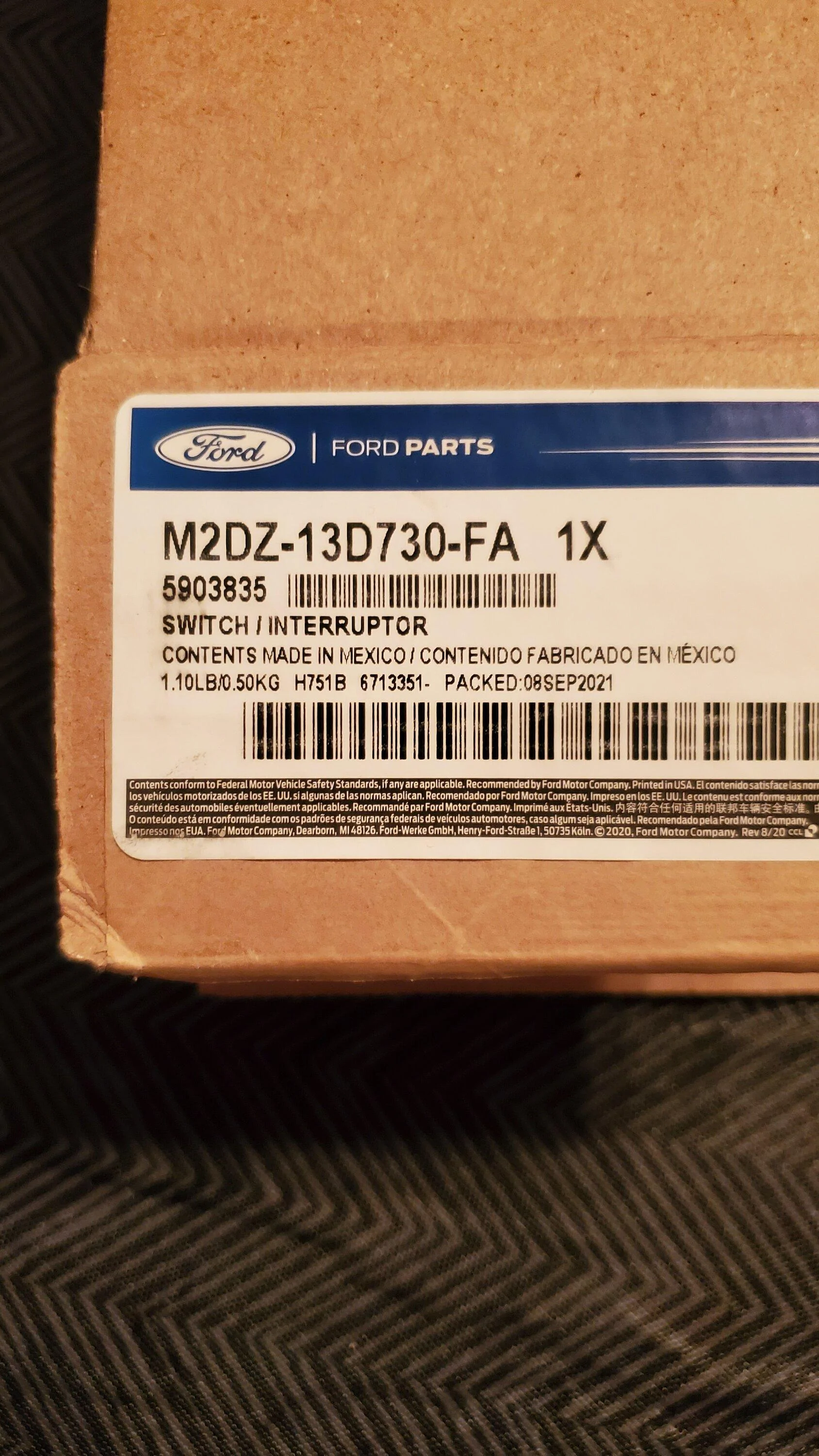

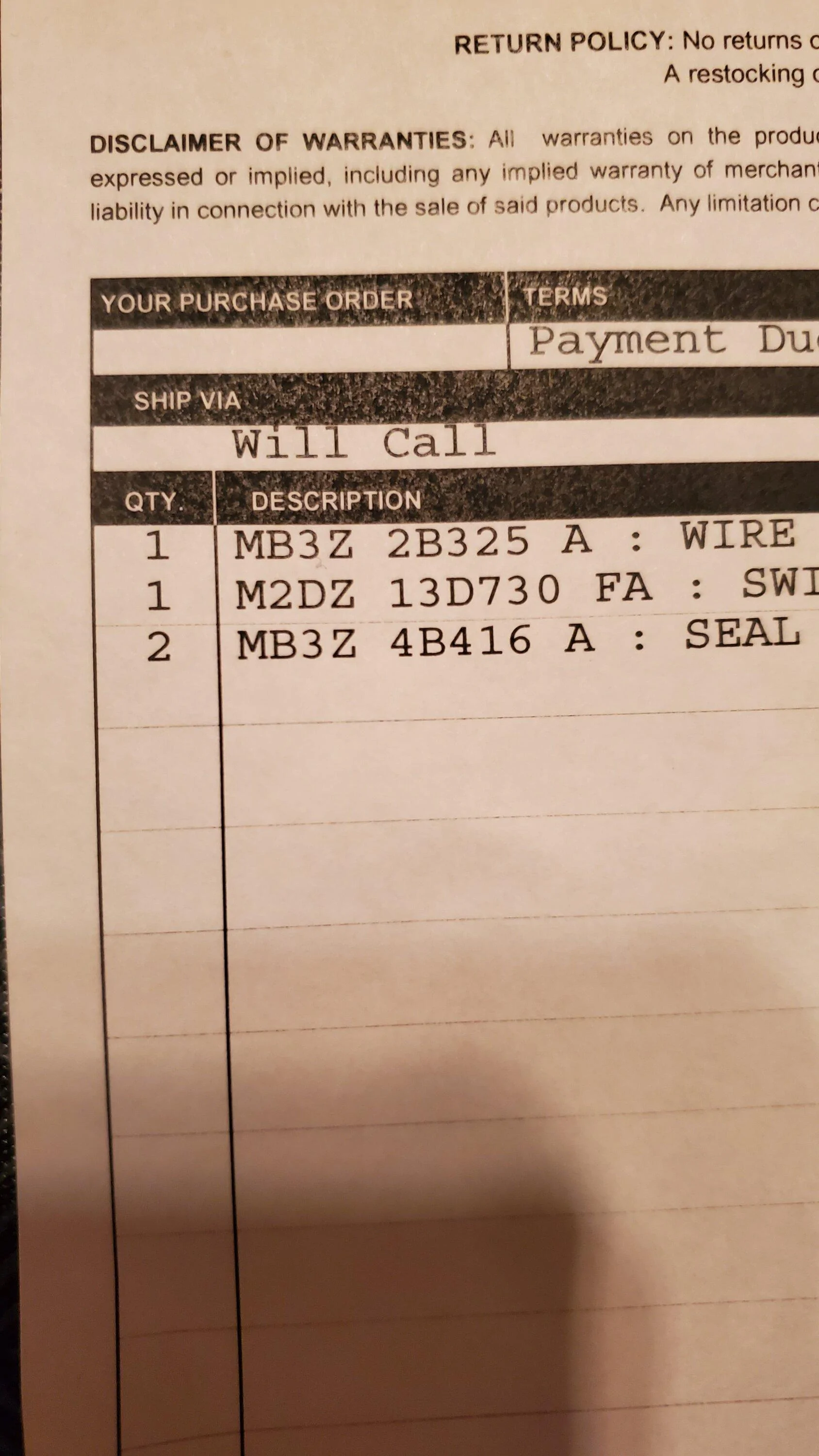

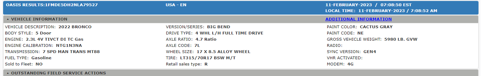

So they did get me the right part but not? Is that VIN truly a Big Bend with Sasquatch? If yes, did the wrong part get put into the right box?

Yes, those 4 buttons
Yes it exists
Ford Bronco Does It Exist - Hero Switch 20230210_235402

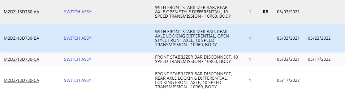

Ford Bronco Does It Exist - Hero Switch 1676117373987

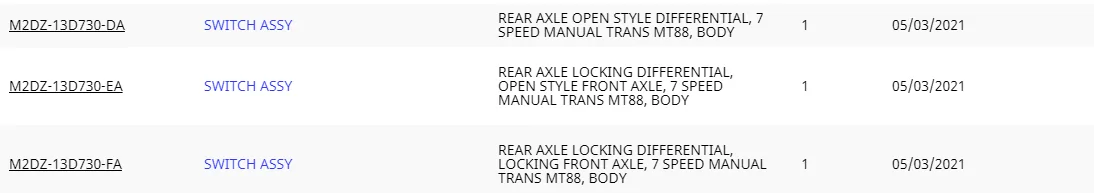

The part you got is what indexed to that VIN
Here are all the possible 7sp choices.
Ford Bronco Does It Exist - Hero Switch 1676118187916
-EA
Ford Bronco Does It Exist - Hero Switch 1676118280759
-DA
Ford Bronco Does It Exist - Hero Switch 1676118310219
-BA Auto trans.
Ford Bronco Does It Exist - Hero Switch 1676118429428
-EA
-DA
-BA Auto trans.
Only Badlands and First Edition gets swaybar disconnect, correct?
orion
orion
Jeremy
Nov 23, 2020
812
1,634
17' F-250, 17' Explorer
I believe that is correct.
So why is Ford saying this Hero Switch with Swaybar Disconnect goes to this Big Bend with Sasquatch?
Do you know what part number I need to order for front locker, rear locker, TCS, hazard only hero switch?

I think the vin you are using is wrong
