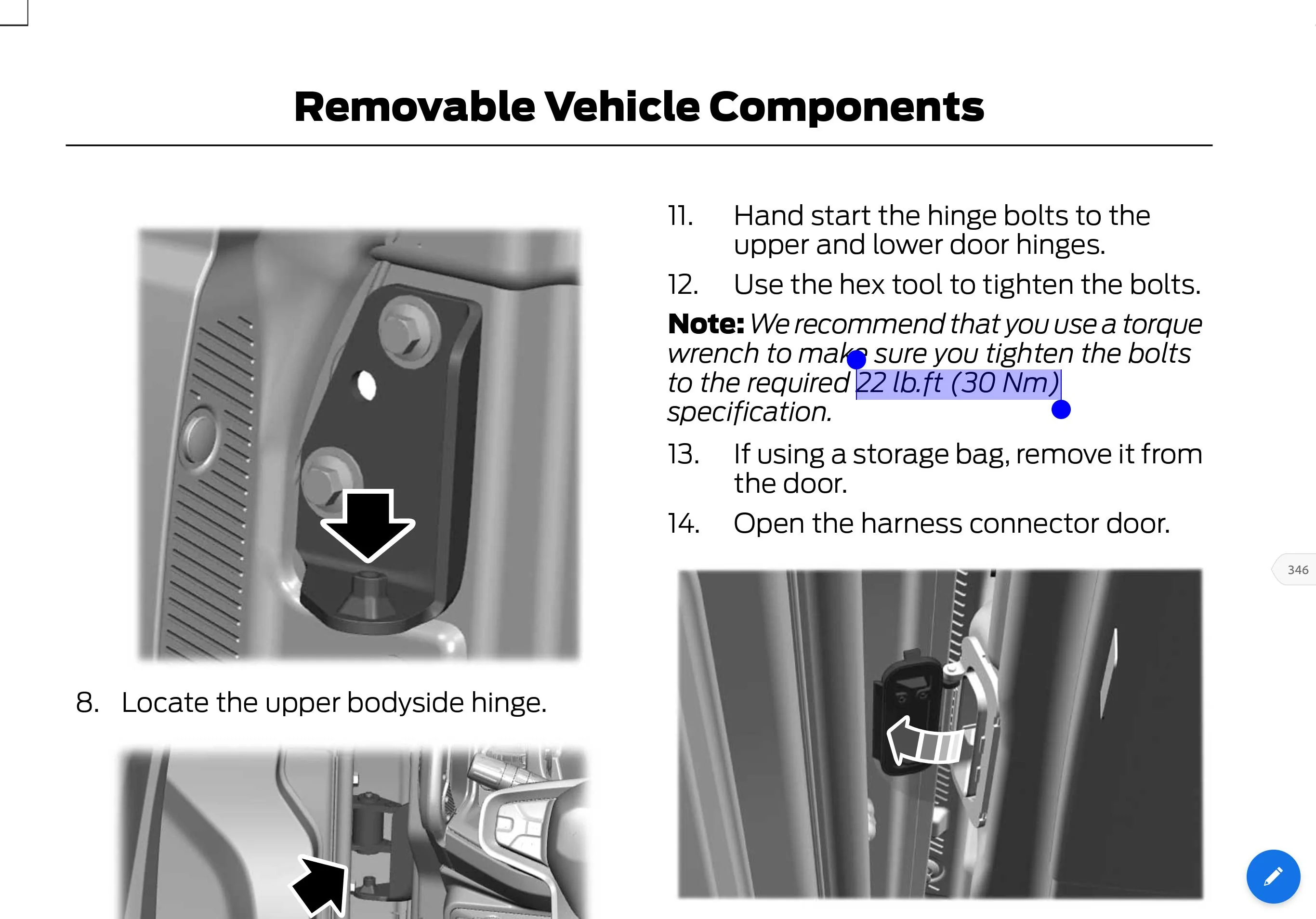

I've had the Bronco for a year and have cycled the doors off and back on at least 6 times. Last week I took them off for the first time in about 3-4 months and on all four doors the bottom bolt was barely finger tight. The upper bolts were all perfectly snug. I use the socket wrench from the supplied tool kit every time.
Has anyone else noticed the door bolts working themselves loose?
The obvious answer is probably that I didn't tighten them enough, but this hasn't happened any of the other times. Also if there were a tendency for them to work loose in one direction (like only when my kids slam the doors) I would expect it to be something like the lower bolts on the driver side and upper bolts on the passenger side since the slams would be coming from different directions.
I addressed this on another thread. Hope this helps...
If you tighten the bolts to the recommended torque of 22 ft-lbs (30 Nm), they won’t back out. That seems a little tighter than you might intuitively expect if doing it purely by feel, but it is not so tight that it will cause the bolts to plastically deform or break. A torque wrench is your friend here, and even if you don’t like using one routinely, you should do it at least once to help mentally calibrate your own intuitive feel.
