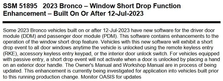

No. There’s an SSM Ford release a while ago saying they were working on doing this, but they haven’t announced that they actually have done it yet. Since this is the first time we’ve seen it on something other than a 2023, I suspect they will release some type of information about it very soon.

Quote from SSM 51895: " . . . short drop event will not activate when a door is unlocked by placing a hand on an exterior door handle".
That's disappointing. That's how we unlock our door before we open it. What's the rationale?
I’d rather it drop when my hand goes behind the handle than having to push the unlock button on the fob as well. Maybe some year!
