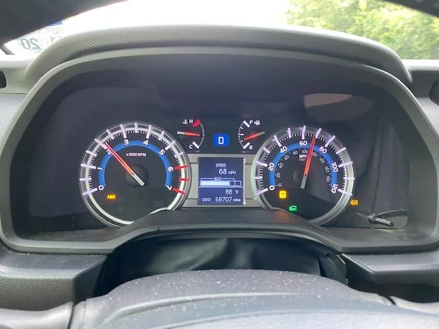

This is what I get for spouting my mouth off about how reliable my truck has been..... I should’ve known. This happened on the way home today. Don’t know what the issue is but just thought it was funny after I said I’ve had no issues.
I know what you mean. I've been on here spouting off about that awesome Toyota 4Runner reliability and then this happened. :LOL: Turned out to be a faulty Brake Light Switch.
