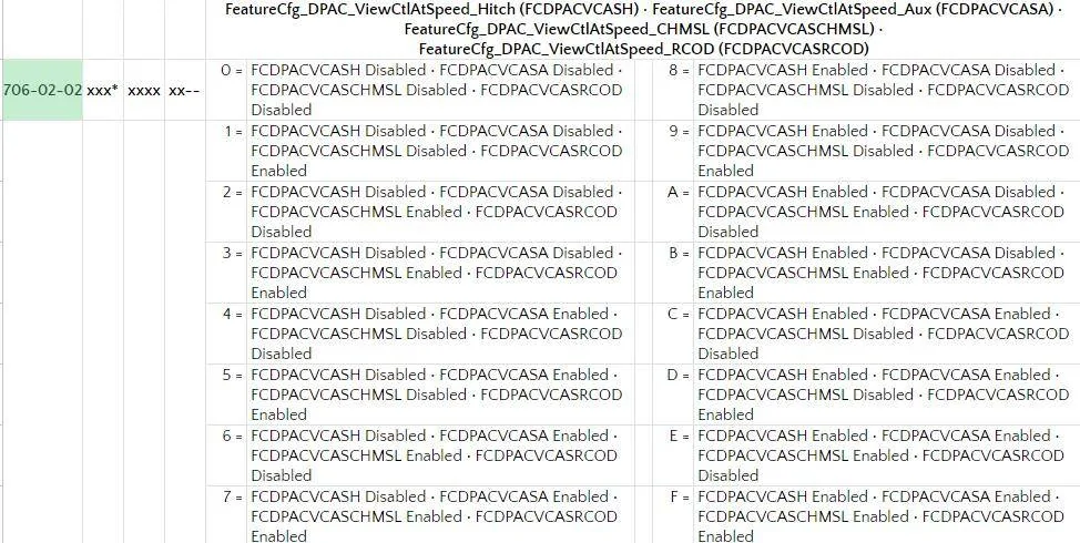

Correct; the config within the IPMA to enable this does not seem to be enabled on the Broncos. After checking the a/b data off of 3 Broncos, none of them show an F in the xxxX xxxx xx-- location:
Ford Bronco Enable backup camera when driving? 1727452259327-pb
Ford Bronco Enable backup camera when driving? 1727452398268-k7
Ford Bronco Enable backup camera when driving? 1727452455879-6k
Changing that value to an F will enable all available camera views at speed:
Ford Bronco Enable backup camera when driving? 1727452655622-nz
Granted, the clip above is for the F150, but I still think it should work for you guys. There was an OTA sent out to F150's a while back ago that wiped the config that allowed cameras in motion to work. Ford added a guided routine to FDRS for dealers to flash the correct config back to fix the issue, and all it did was change whatever value was there to an F and problem solved.
I'll give it a shot this weekend and see if I can get it to work.

I've seen your posts and you seem to be quite knowledgeable, but jic you or anyone tries this, remember to go to the wrench icon in FORScan and reboot the IPMA after you write the config so the change goes into effect.

Yea, I can see how this looks foreign af, but it's VERY easy to do and making this change and rebooting the module would take take 1-2 minutes to do. If you want to do it, I'd be happy to walk you through it.
