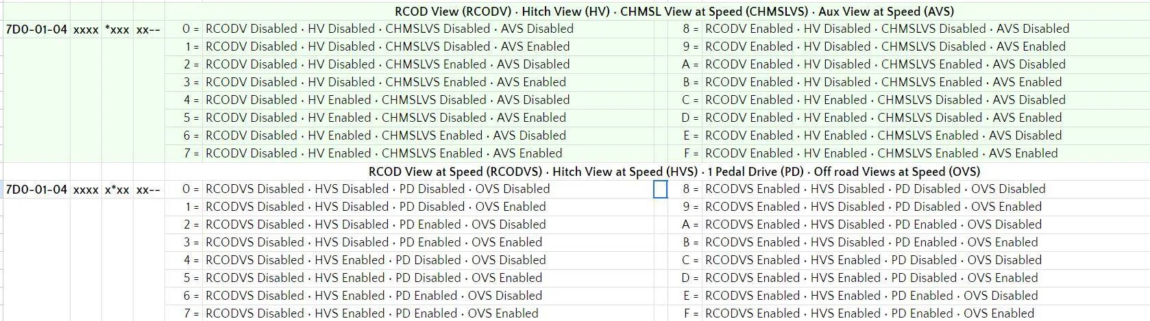

I found something else that seems relevant to this. There are settings in the APIM that pertain to enabling different camera views. I pulled the VIN of a random Bronco that has rear camera only and in these two values, it shows a 04. So, RCOD is disabled with the 0 and only hitch view at speed is enabled with the 4.
In this vehicle, I would change the 0 to an 8 to enable ROCDV, and I would change the 4 to an 8 to disable HVS and enable ROCDV at speed instead. So:
7D0-01-04
xxxx 88xx xx--
I think this also works for trucks with the 360 cams, too. However, if the Bronco has off-road views at speed, then instead of 88, I would do 89 to enable RCODV in one value, and RCODV at speed and OVS with the other to see if that displays. Or just do 88 and you sacrifice off-road cameras at speed for just reverse camera at speed. Again: Just document whatever is there before you change anything so you can revert back if needed.

@Ducati1098 did you get a chance to try these changes yet (to IPMA 706-02-02 and 7D0-01-04) ? I was about to, but realized my FORScan license has expired.

I got FORScan working again with a new temp license. Just to wrap up this thread I tried the suggestions from above:
  • change the IPMA 706-02-02 to xxxF.xxxx.xx--, as well as
  • change the APIM 7D0-01-04 to xxxx.89xx.xx-- (also tried 88xx).
  • I rebooted both modules after the changes were made.
No luck. Camera views (front, overhead, side) still shut off above ~7mph, and rearview camera is not selectable at any speed unless in Reverse gear. 😞 Oh well.
