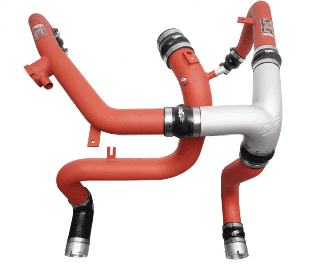

What are charge pipes?
If you look at your engine, they are the upper pipes that run from the throttle body, and turbo systems.

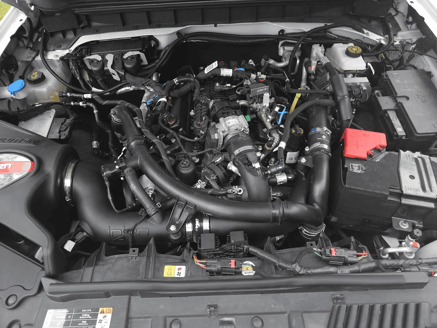

Below, the top picture are the charge pipes I ordered. the part with the silver split goes to our turbos, and comes from the right side of the intercooler. The single pipe comes from the throttle body and goes to the left side of the intercooler. Looking at my current engine, you can see where these will go. They offer a larger diameter, which will flow better, which will help with turbo lag.
Coupled with the InjenCAI system I have installed, this will give more power to the system overall by the entire system breathing better and flowing more air.
