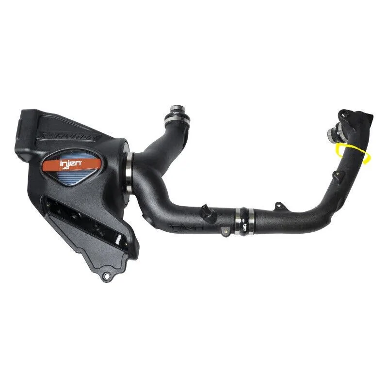

Can anyone with the Injen intake measure the outside diameter of the driver's side tube where I have it circled in yellow. I think it's around 3" but I wanted to verify. I think the stock tube is 2.25". Thanks.
I have the Injen, the section you circled is 3.18

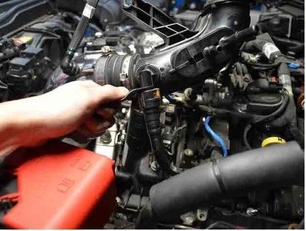

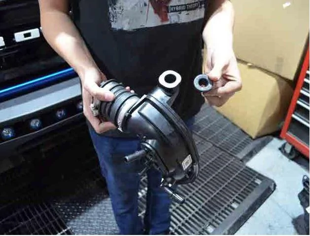

Here's a picture of the elbow that connects to the driver's side turbo. This is from the Injen installation guide and it has been disconnected and they are showing how to remove the ccv line which is the end that goes on the turbo. The stock elbow has a 90 degree fitting for the ccv but the Injen has a straight fitting so I wonder if that allows too much flow. It doesn't look overly restricting and it even looks smoother than the rubber bend near the airbox. The K&N, AFE, Mishimoto all leave this elbow in place but run a new tube all the way to it.

One of the reasons I purchased the Injen was because of how their system removed restrictions the stock system and other systems had. I wonder as well with the 23 models if the change in the sensor is registering to much air? Could that be an issue? The 21 and 22 may have a different sensor, and it compensates for the increased flow perhaps?
Since I have installed the system, I have not had a single code.
