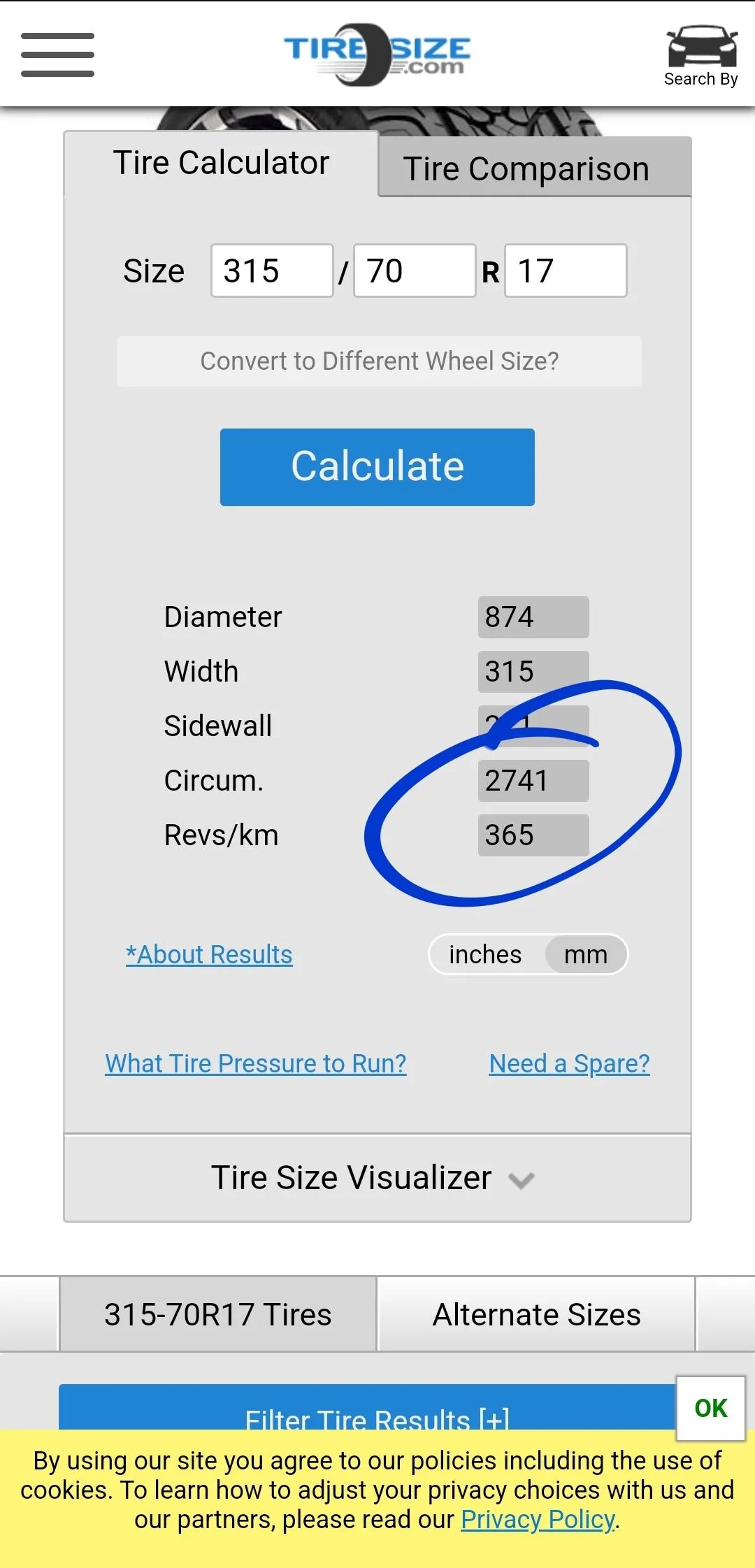

2653mm is the stock Squatch number....
Speedo reads 102Km when I'm actually doing 100km
2% difference...
Not sure if I have to go bigger or smaller.
-2% is 2600mm
+2% is 2706mm

On factory 285s my speedo read 60 and I'd be going 58. Now on 315s I'm going 61 when it says 60. I chose to leave the factory number alone, which was 2525. That sounds waaay too low based on all these calcs that show 26xx or even 27xx.

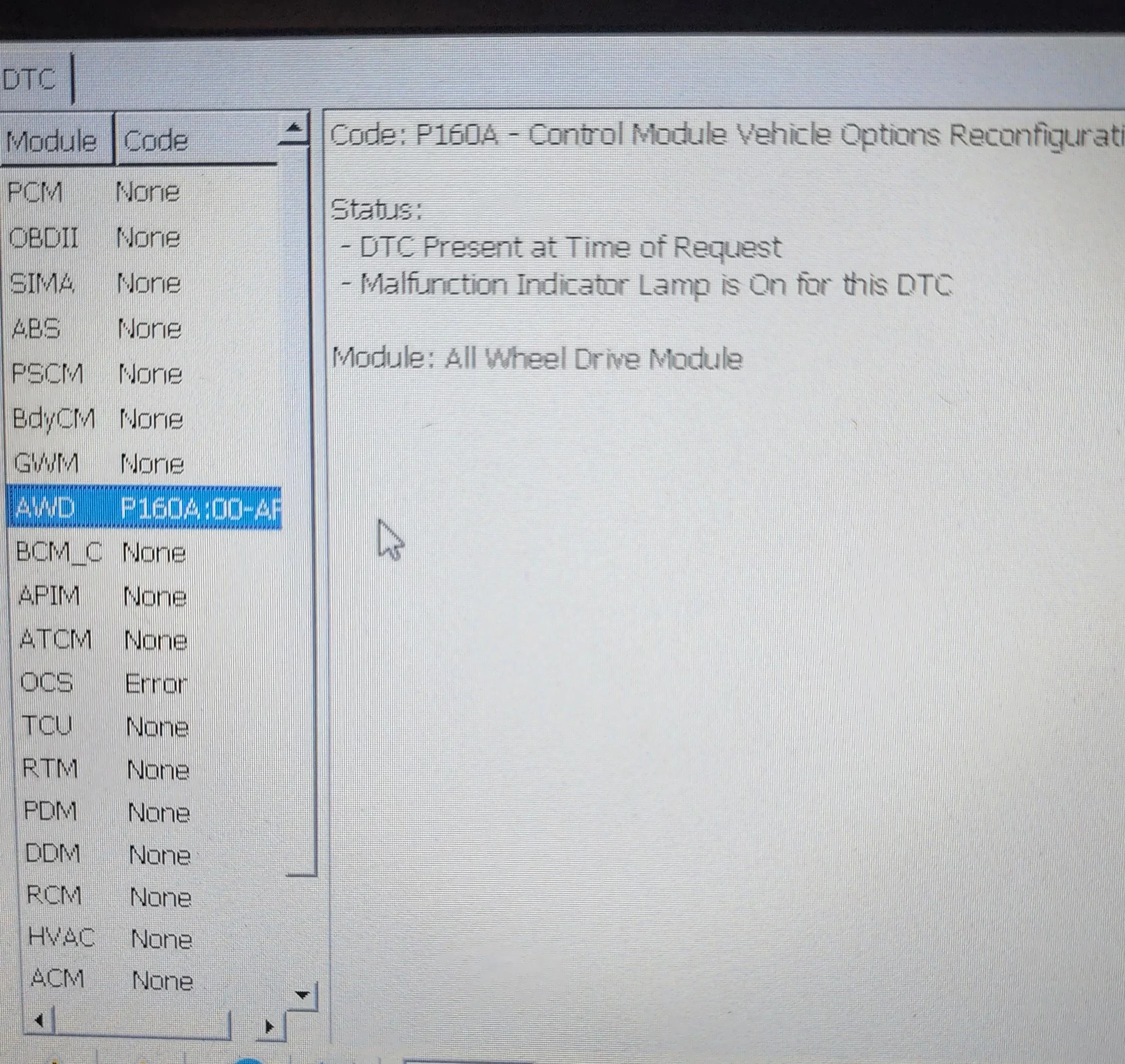

I have a DTC I can't clear..
Could not find AWD relearn... Only reset.
I did the PCM reset adaptations and reset AWD, but still have error
