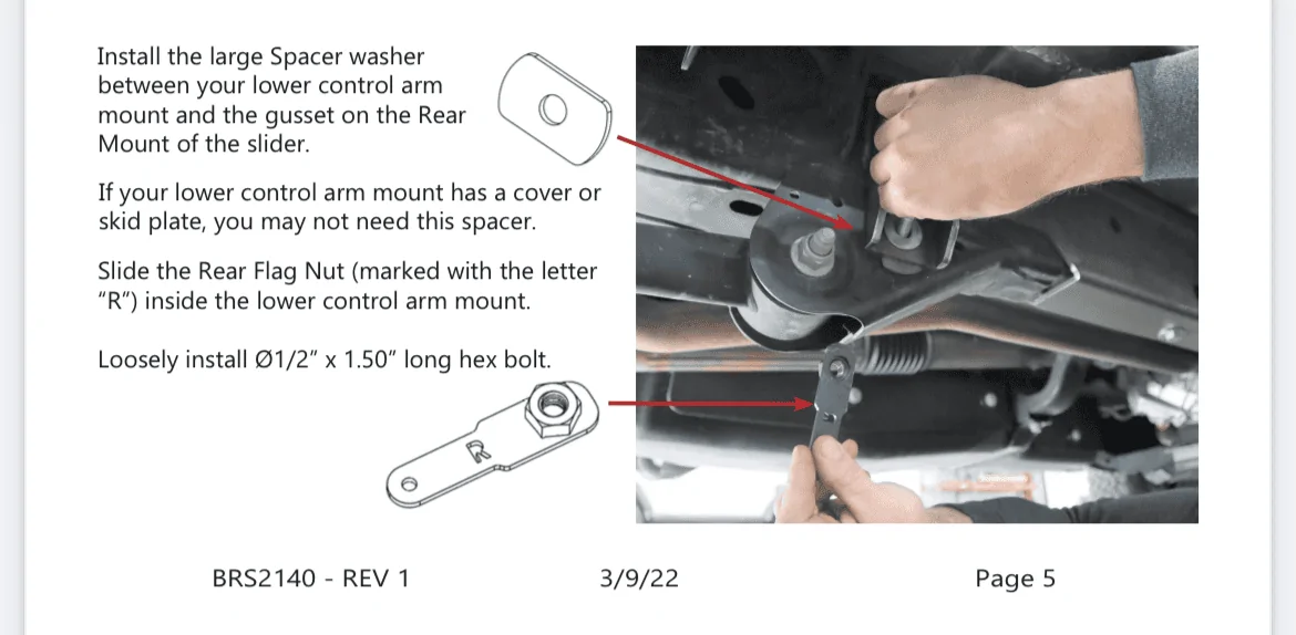

LoD’s install instructions include the use of a spacer around the trailing arm mounts and recommend not using the spacer if you have trailing arm skids. Are you concerned that won’t work? Spacer too small compared to typical trailing arm skids?
No concerns with fitting a skid under however there were several ledge pivots where I would have hung up on the channel protruding out and away vertically from the arm mount. Certainly something that can easily be cut off but also an easy redesign of the mounting point.
