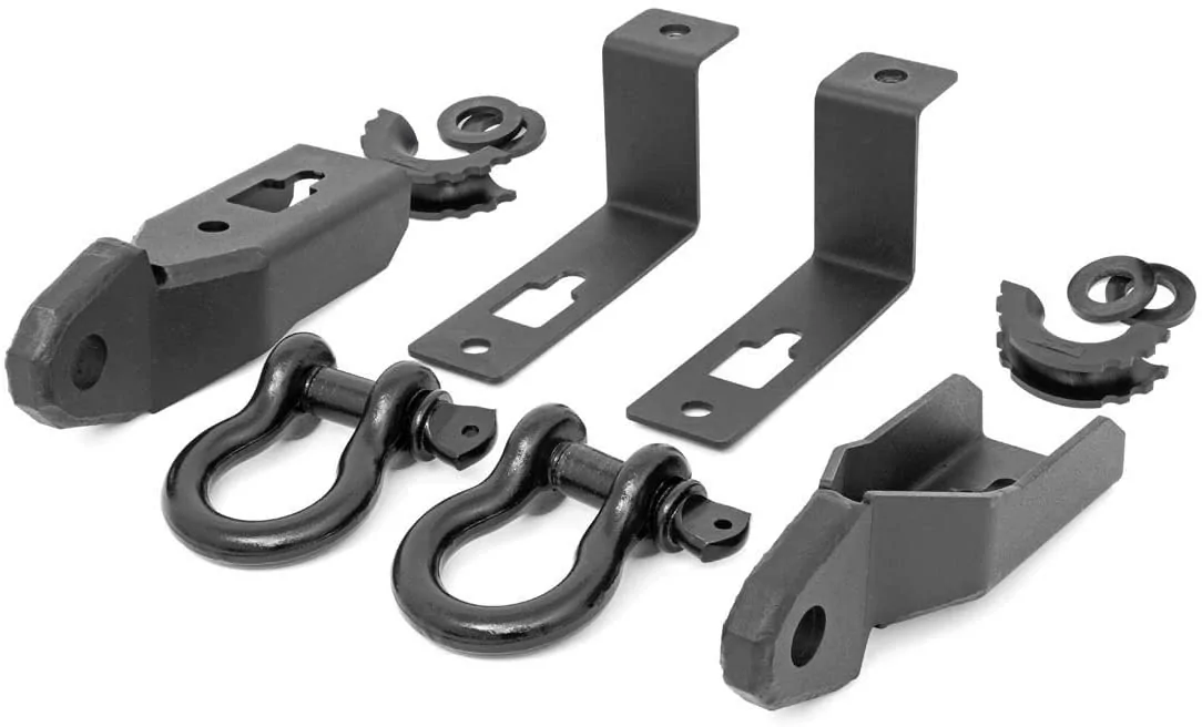

It kinda depends on your tow bar preference. The front tow loops on models without D-ring style can be replaced with D rings using a rough country adapter. Then you can get adapters for your towbar to fit the D ring mount. If you like the full BlueOx or Roadmaster system you will require a base plate.

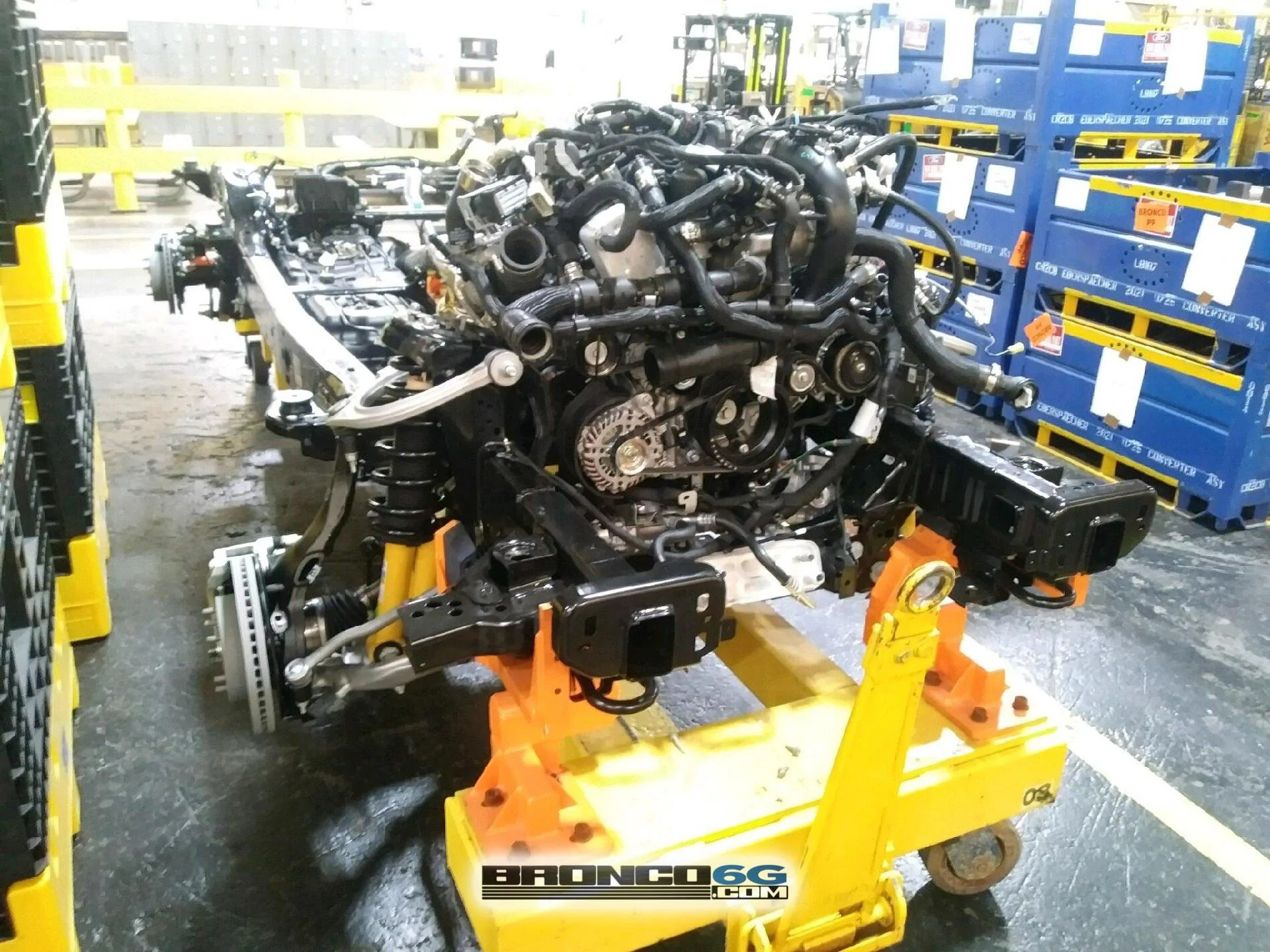

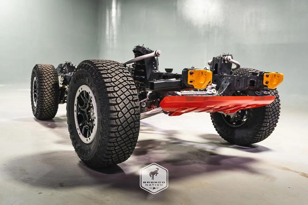

Trims with the modular bumper have the ends of the frame rails exposed in the front and these shackle points accessible. They are colore yellow in this pic:
Ford Bronco Flat towing 8903B1D9-3892-4392-A6B9-827FFD0ED6EF
Ford Bronco Flat towing 1615261504456

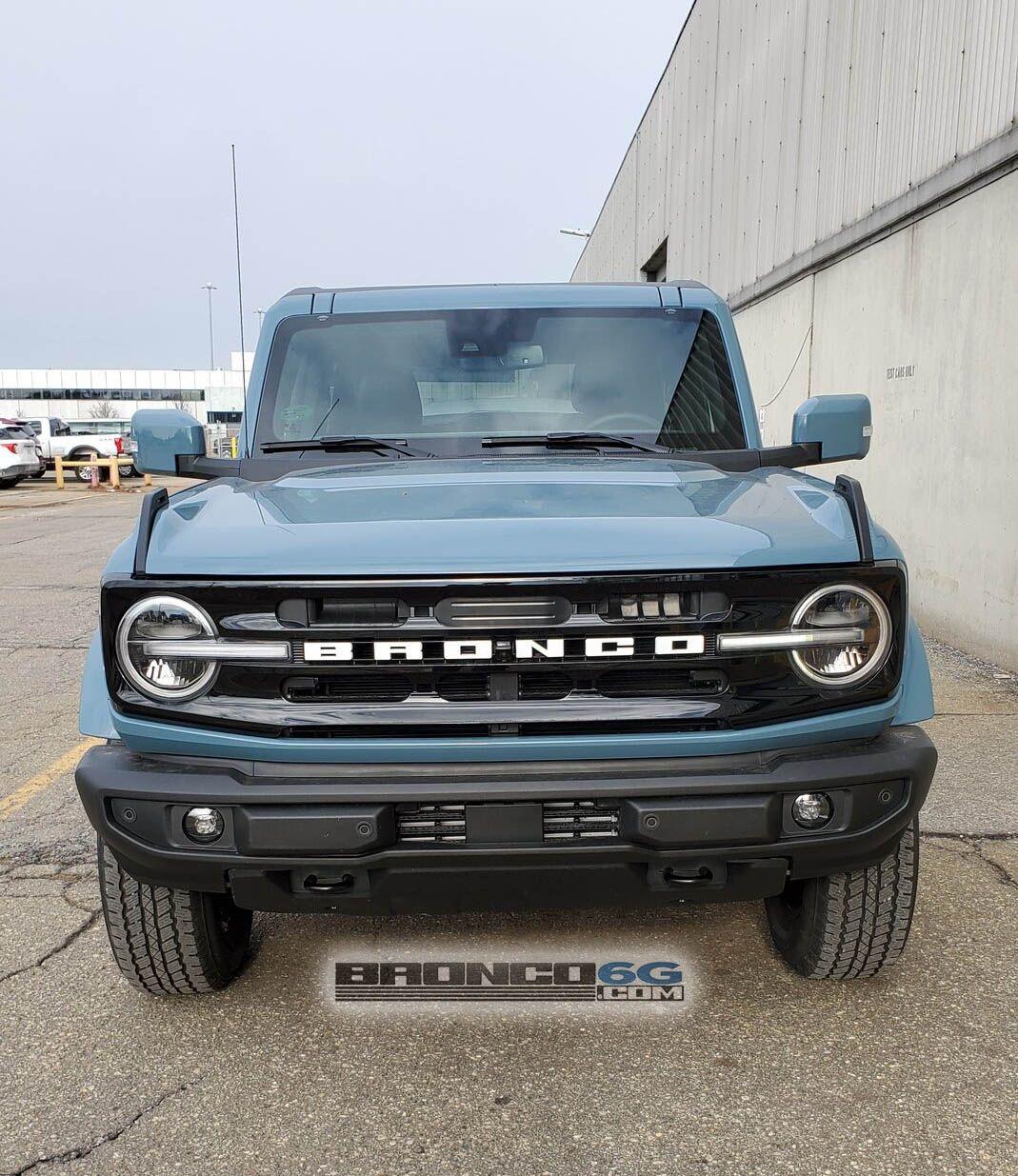

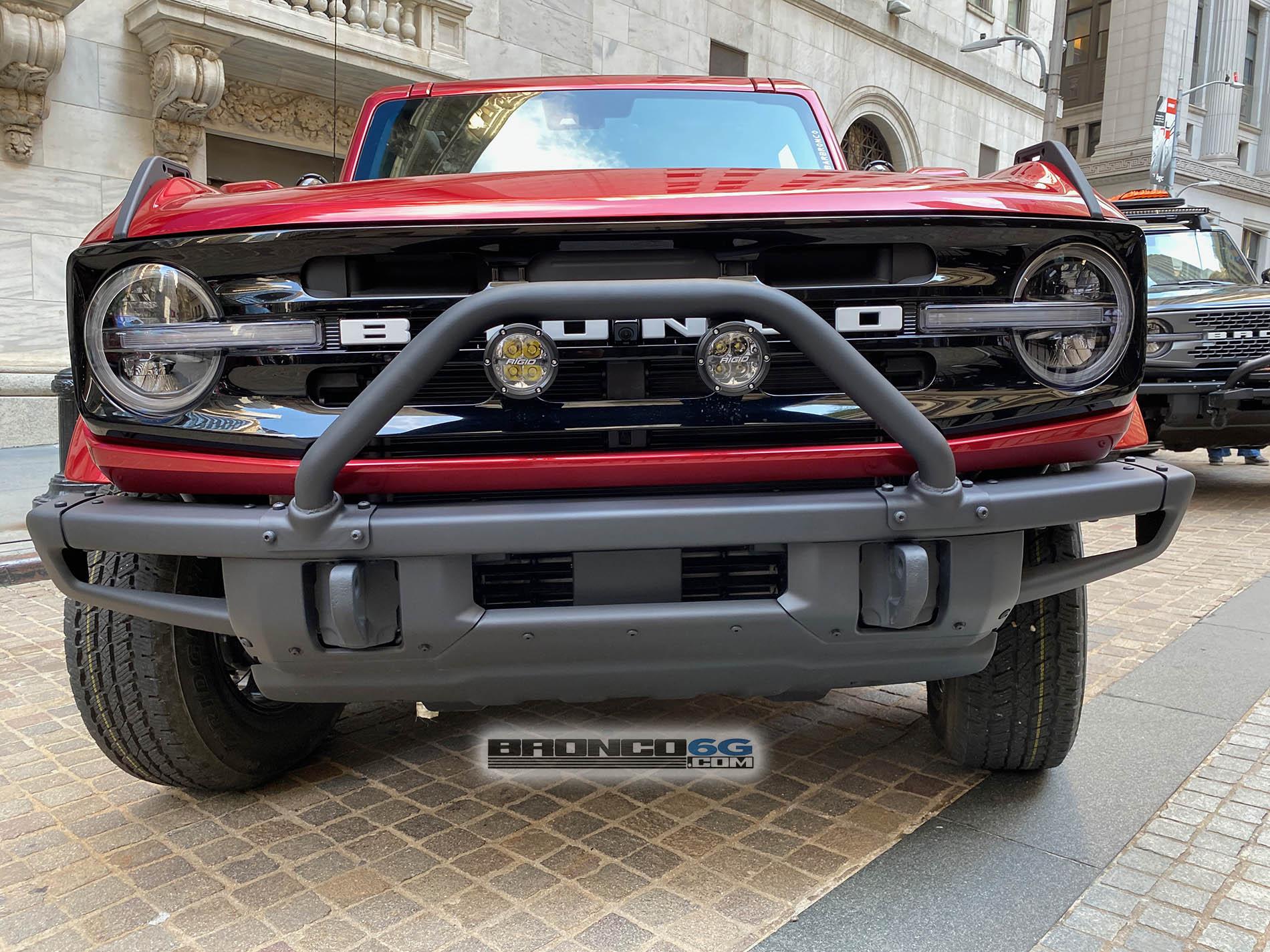

For trims with the standard bumper (with or without fog lights), these ends are covered so there are two loops bolted to the underside of those same frame rails. You can kind of make them here:
Ford Bronco Flat towing 1615260347383
Ford Bronco Flat towing 1615261572739
Either way, it would seem that you have a mounting location easily accessible or adaptable in whatever trim/bumper combo your Bronco has.

I'm thinking I might remove the blocky plastic covers from my BB bumper and mounting the shackle mounts (yellow in your photo)
