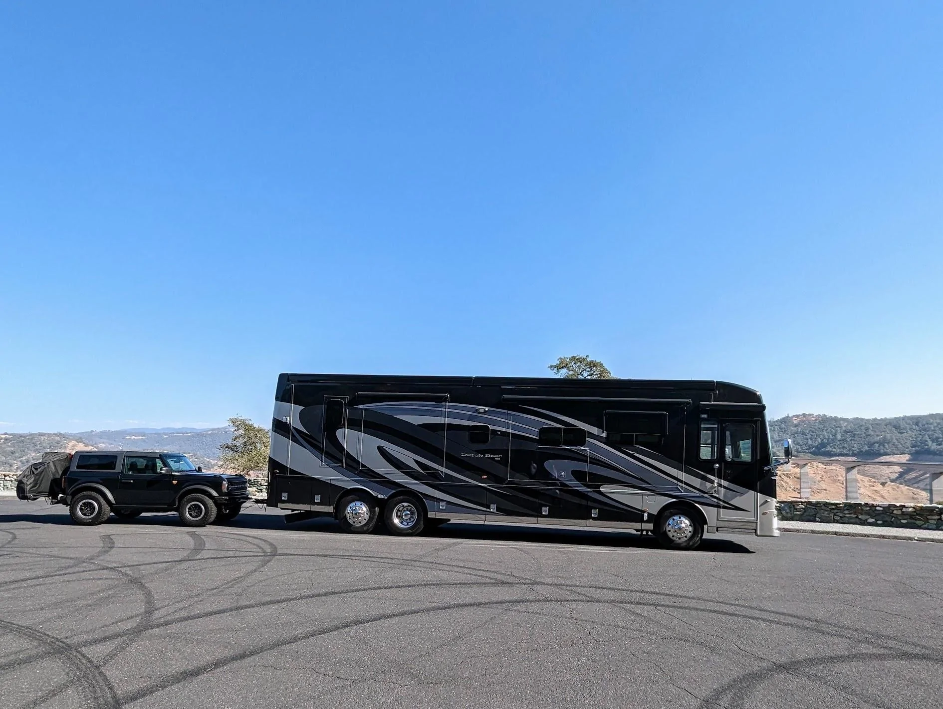

I just made my 2 door Big Bend Flat Towable. I used the Blue Ox BX2692 adapters which involved some cutting to the mount for the bumper to allow the adapters to go in the frame. Also wired in some diodes to the back lights and ran to the Blue Ox connector in the front, and wired in +12V to charge the battery for my brake system. 2 weeks on my buddy's lift to complete including fog light addition (but I'm a little anal when it comes to wiring ;)). Here's the stuff I purchased:

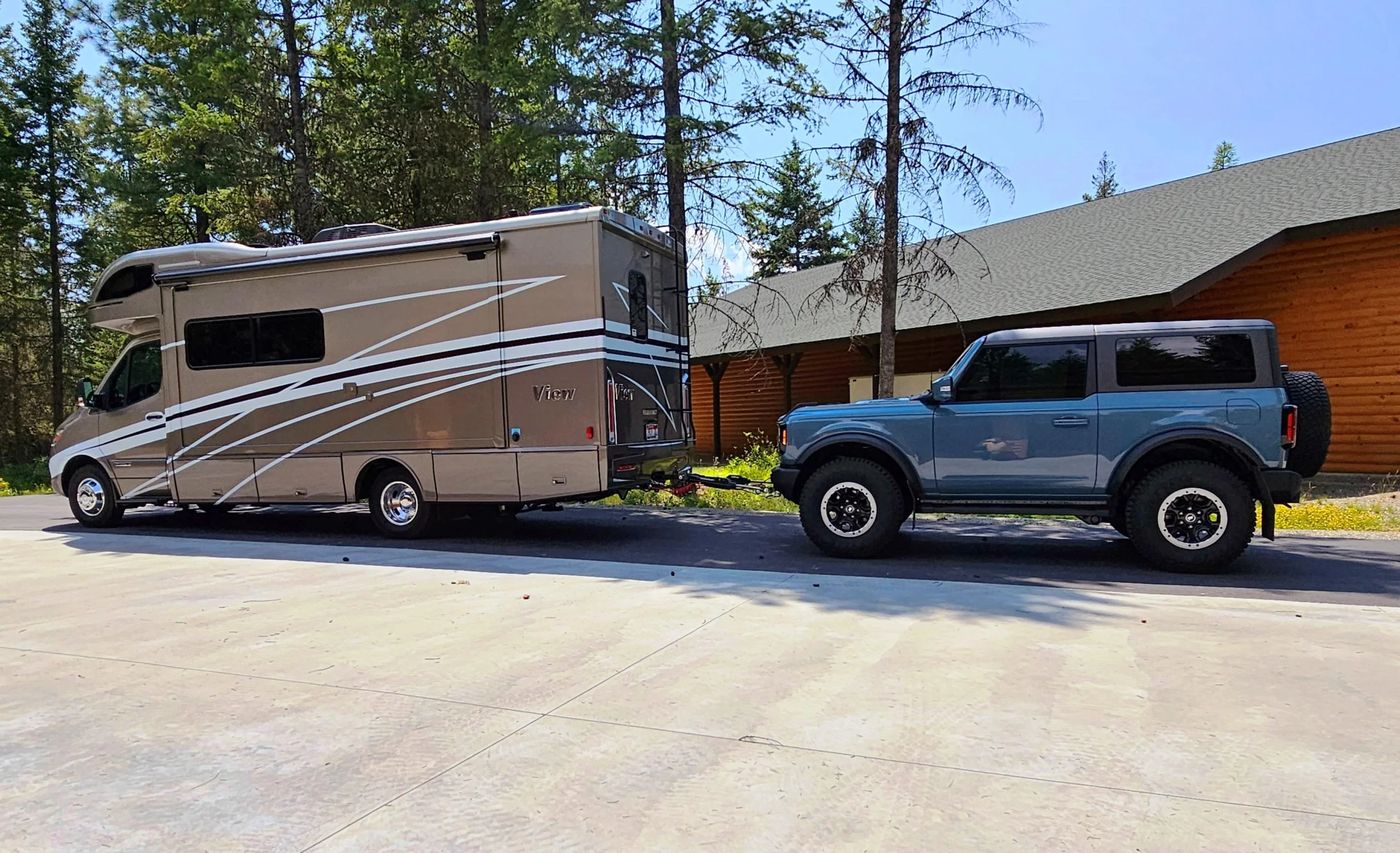

Lots of people have. I have a Roadmaster setup myself. Just look through that thread, posted above, and you'll get everything you need. For the first dozen of us, it was tweaking the groundwork others started to work for us, but most combinations have been documented by now, in regards to the tow connections, lighting, charging and brake controls.

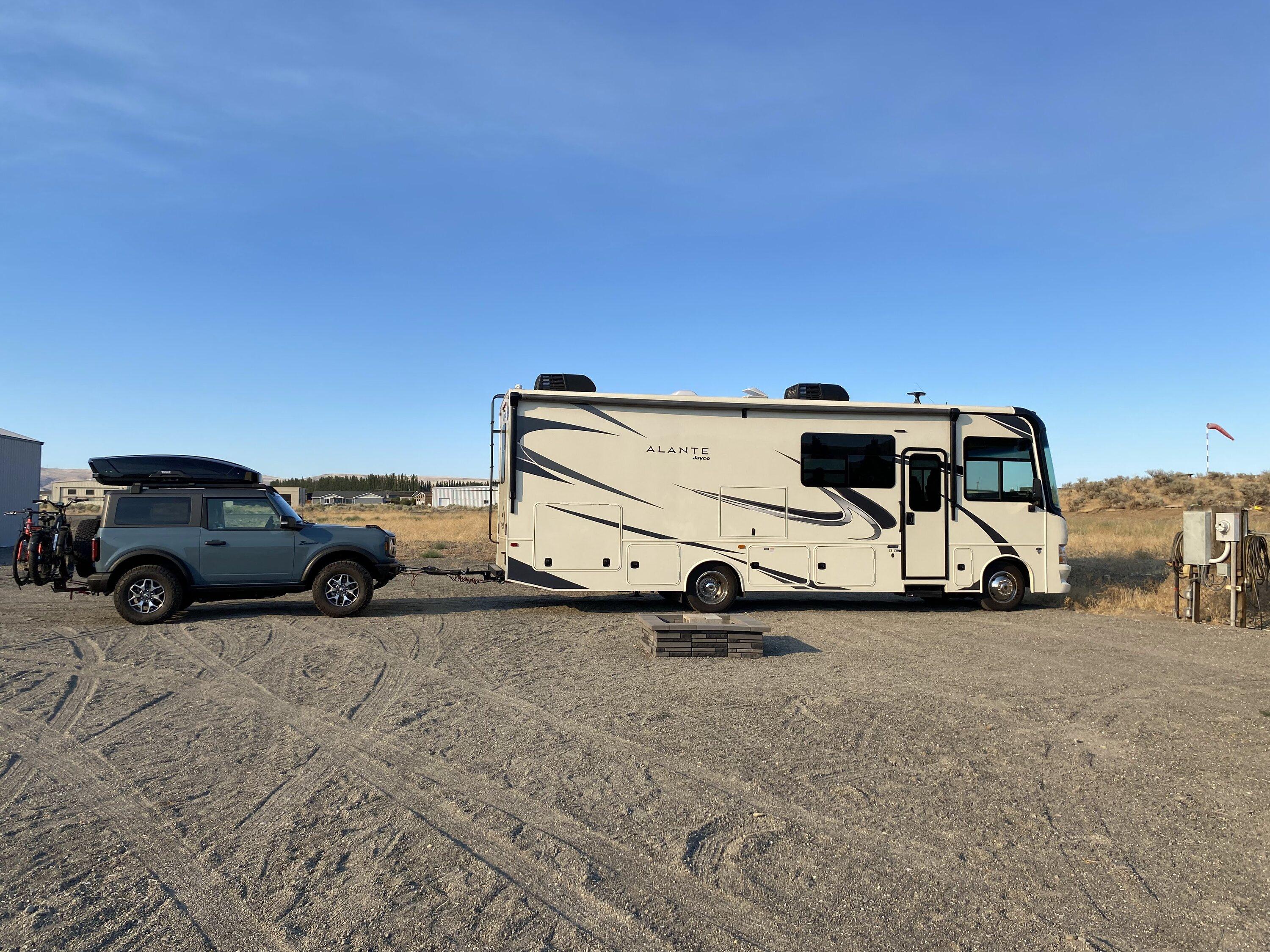

I'm running a Roadmaster Nighthawk bar with Roadmaster Direct-Connect Base Plate Kit (removable arms) for attachment to the standard bumper. Braking system is portable RVi-3. Taillight wiring is Curt 58992 plug and play.
Installation was straightforward without any issues to speak of.
