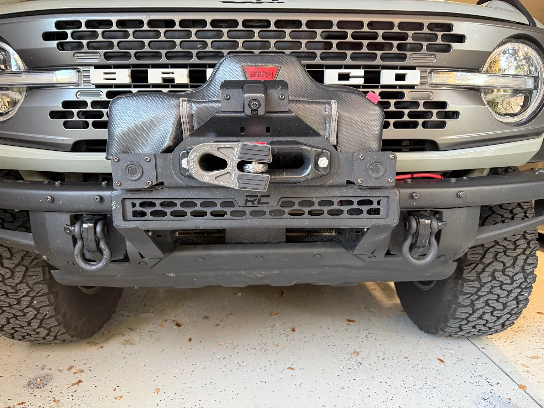

Here’s my RC high mount with warn 12k vr evo winch. The only issue I had was the winch wouldn’t fit (too big) w/o cutting and bending the portion of the winch tray (where the parking sensors go). Also had to extend sensor wires as they were too short. I believe mine is an early RC model, so hopefully they’ve fixed those issues. I did add frame end reinforcements later.
As others have said, anything the sticks out in front or below the stock bumper will be problematic depending on the type it wheeling you do. I can’t tell you the number of times it has hit obstacles in Moab. One has to learn to modify approaching certain obstacles. But for piece of mind, you’ll be fine with either.
Never used mine in three years. Been pulled off of things twice in three years. ☹Always by our friends in their JK. They make certain it’s recorded for posterity. 😀

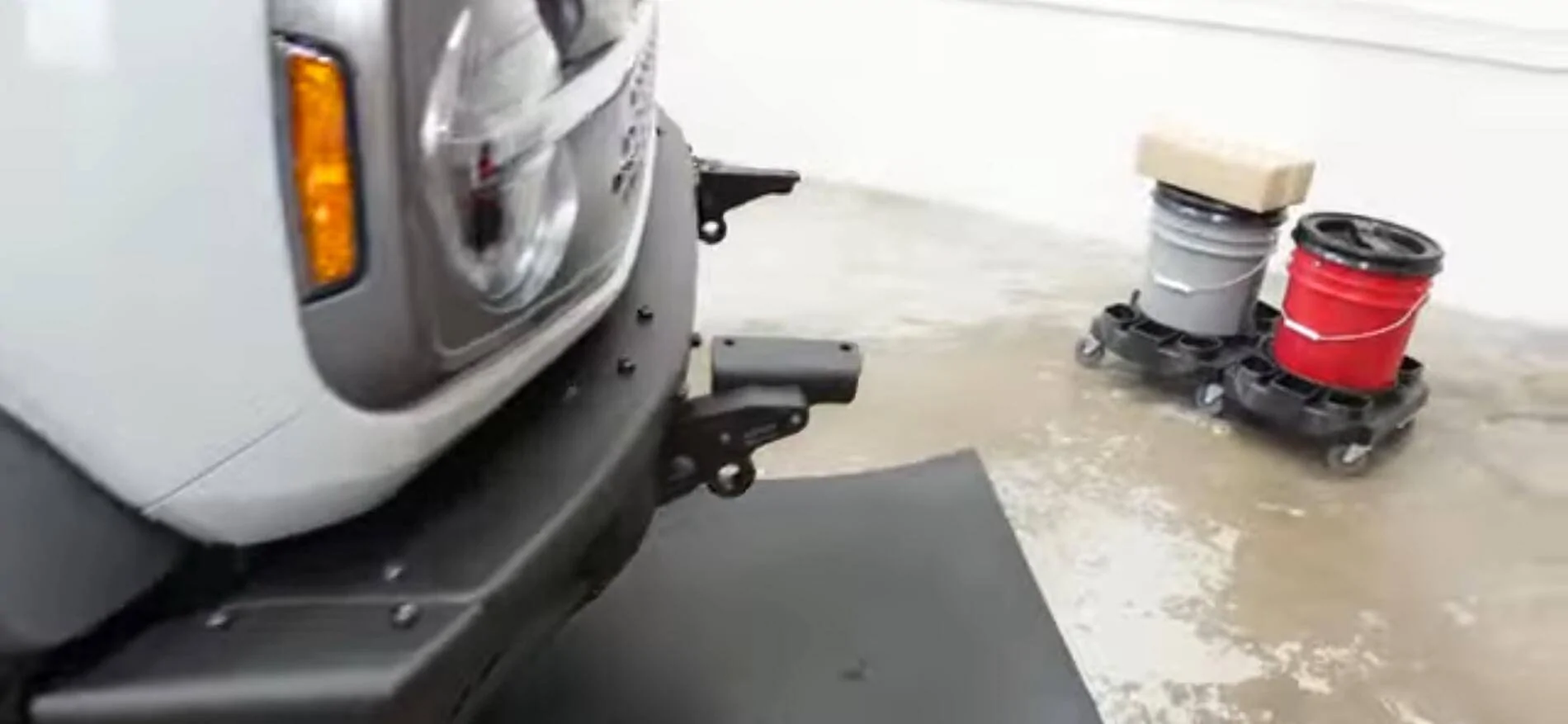

I have the RC mount on my Heritage. I'll probably eventually get the tie-in stiffeners for the frame, but I doubt it's 100% necessary. If you're breaking the mount or frame, you're doing something wrong.
The RC mount definitely looks better and gets you better approach over the Ford setup.
Welds look solid, fit and finish, no issues. 👍🏻
Here's a cid of the install.

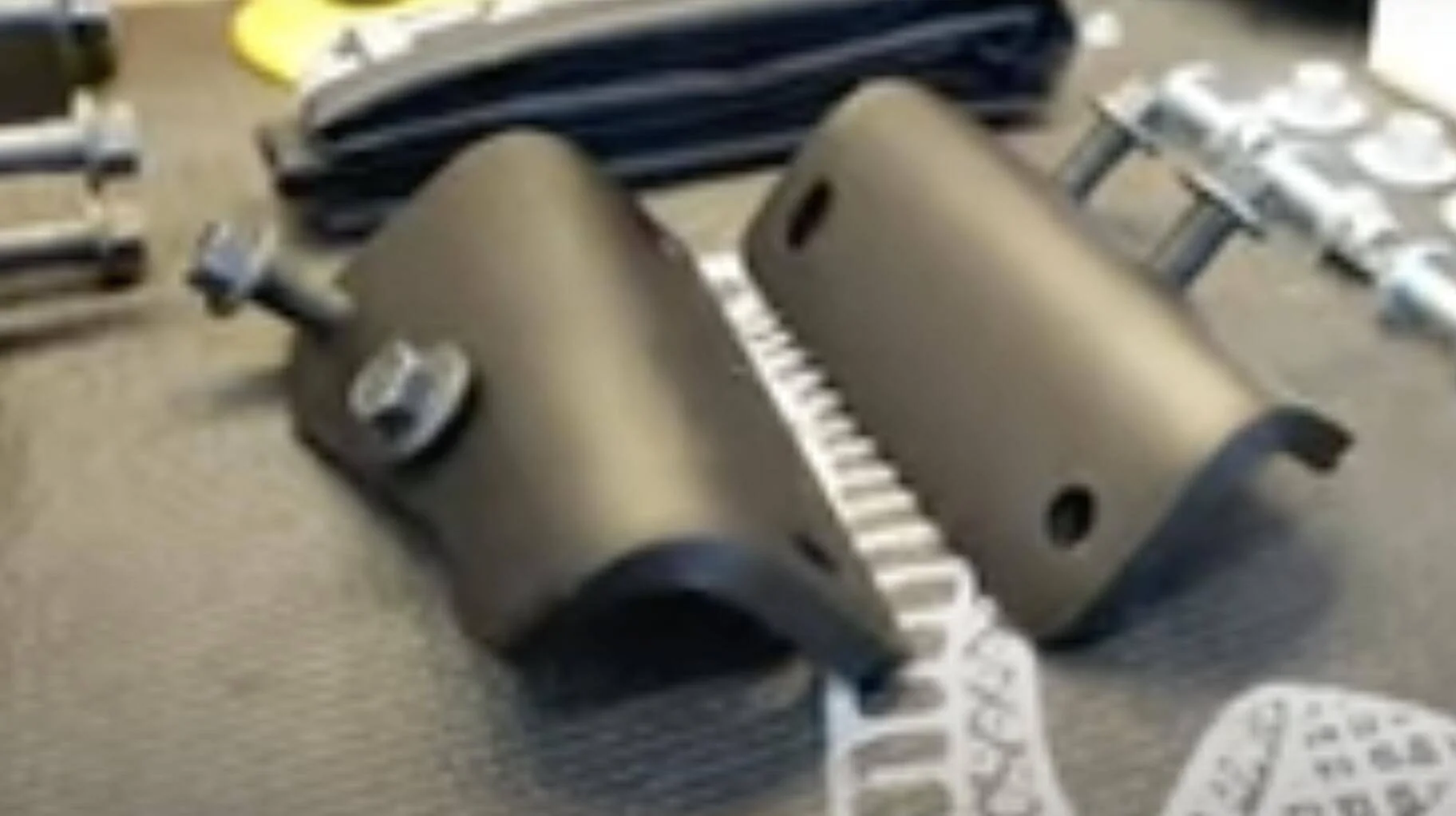

I did go with the RC hi winch mount and frame stiffeners, Had to drill a couple f holes for the frame stiffeners but it was simple, everything went on very easy, without any issues. I took videos of the install, I can send them if you'd like. I do not have sensors or cameras up front so did not use those parts. Using the FP winch kit made the winch install very simple, all the wiring is very easy to install.
I am very happy with the end result

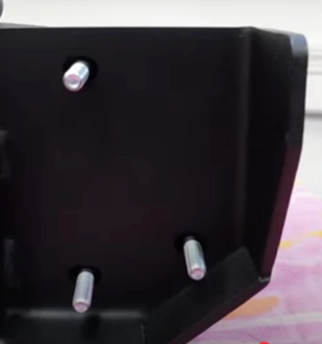

Sorry for the delay, its not the best video but here is the install of the LOD frame re-enforcements
