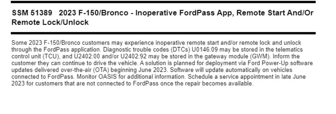

This is the latest on the remote start issues through Ford Pass, according to Oasis. Found this tid bit yesterday afternoon.
