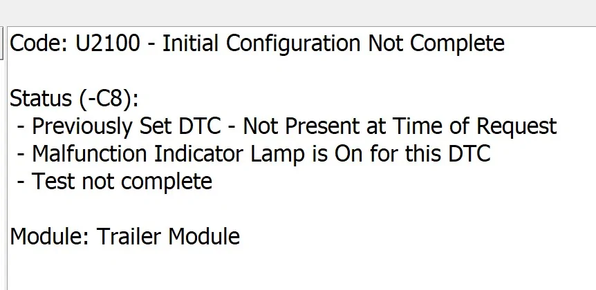

Ok finally got to setting this up in forscan. I initially got TRM codes that can't be reset:
Most of my TRM values were different and I changed and wrote each individual one followed by an ignition on/off after each section. Then I did a quick search and another member in your original thread said the error was cleared after they did a Write All. I did it and all codes are now reset! Going to get a tester and try it out. Hopefully Swedemn can see this and reset his code.
2 odd things I found was in the APIM Trailer Setup Config, the hex placement seems to be different on mine. I changed 7D0-01-03 from xxxx xxx0 xx-- to xxxx xxx4 xx-- (as per the original chart) under "as built" setting but when I went into APIM easy mode, it still showed Trailer Setup Config to "disabled". So I changed the setting to enabled under easy mode and went back into the "as built" setting and it showed the xxxx xx4x xx--. The 4 was on the 7th value not the 8th. Is this an error on the original graph?
