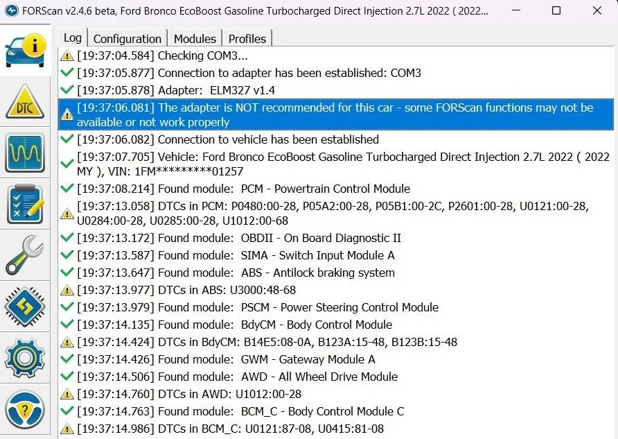

I do see this message saying that the adapter is NOT recommended, but wonder if most adapters show this message (other than the OBDLINK EX they sell, of course):

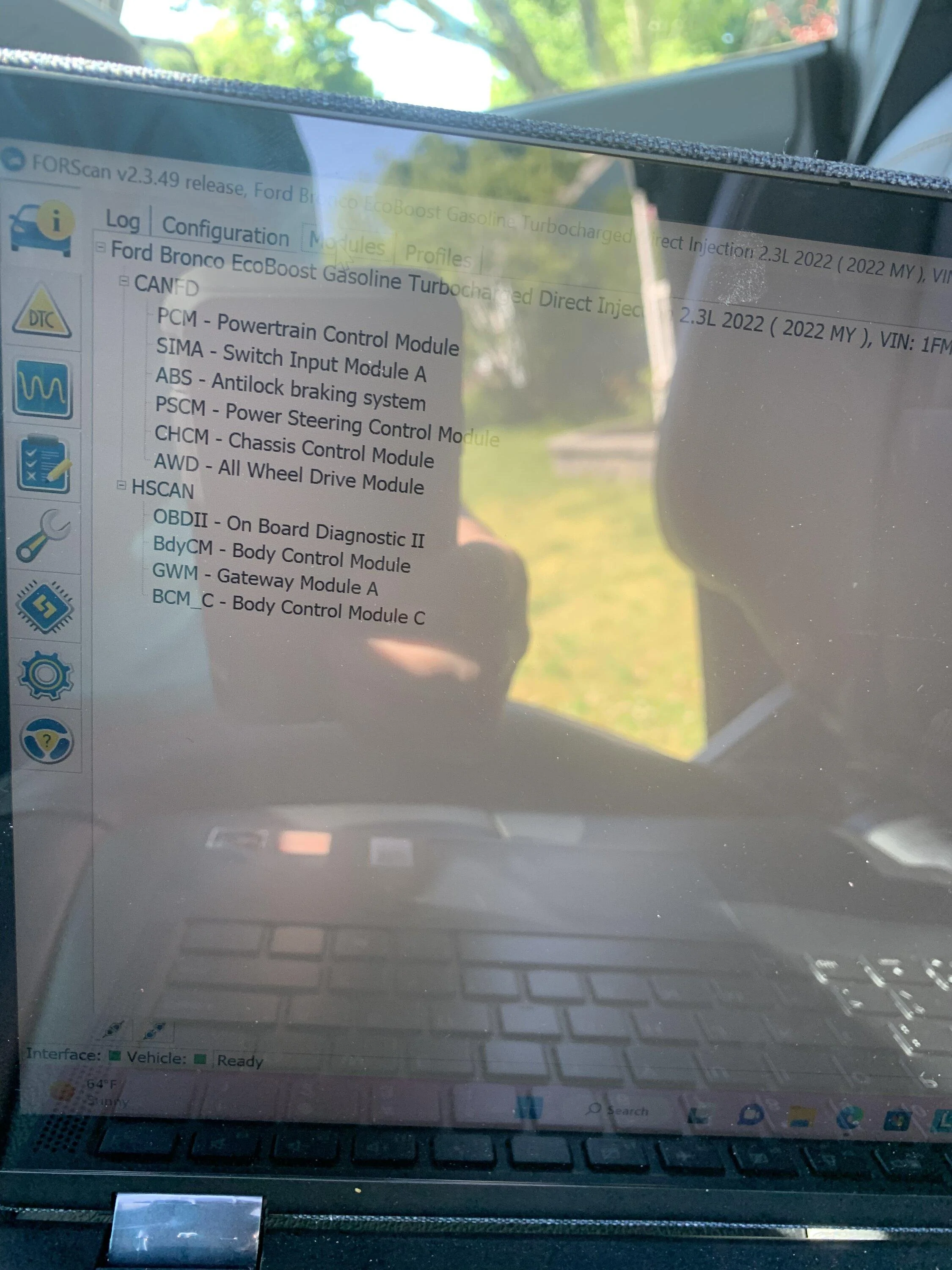

Did u ever figure this out? I’m having the same issue but I am using the obdlinkEX and still get the exact same modules that u are getting. I’m looking for the audio control module to fix the back speakers after installing 6.5s

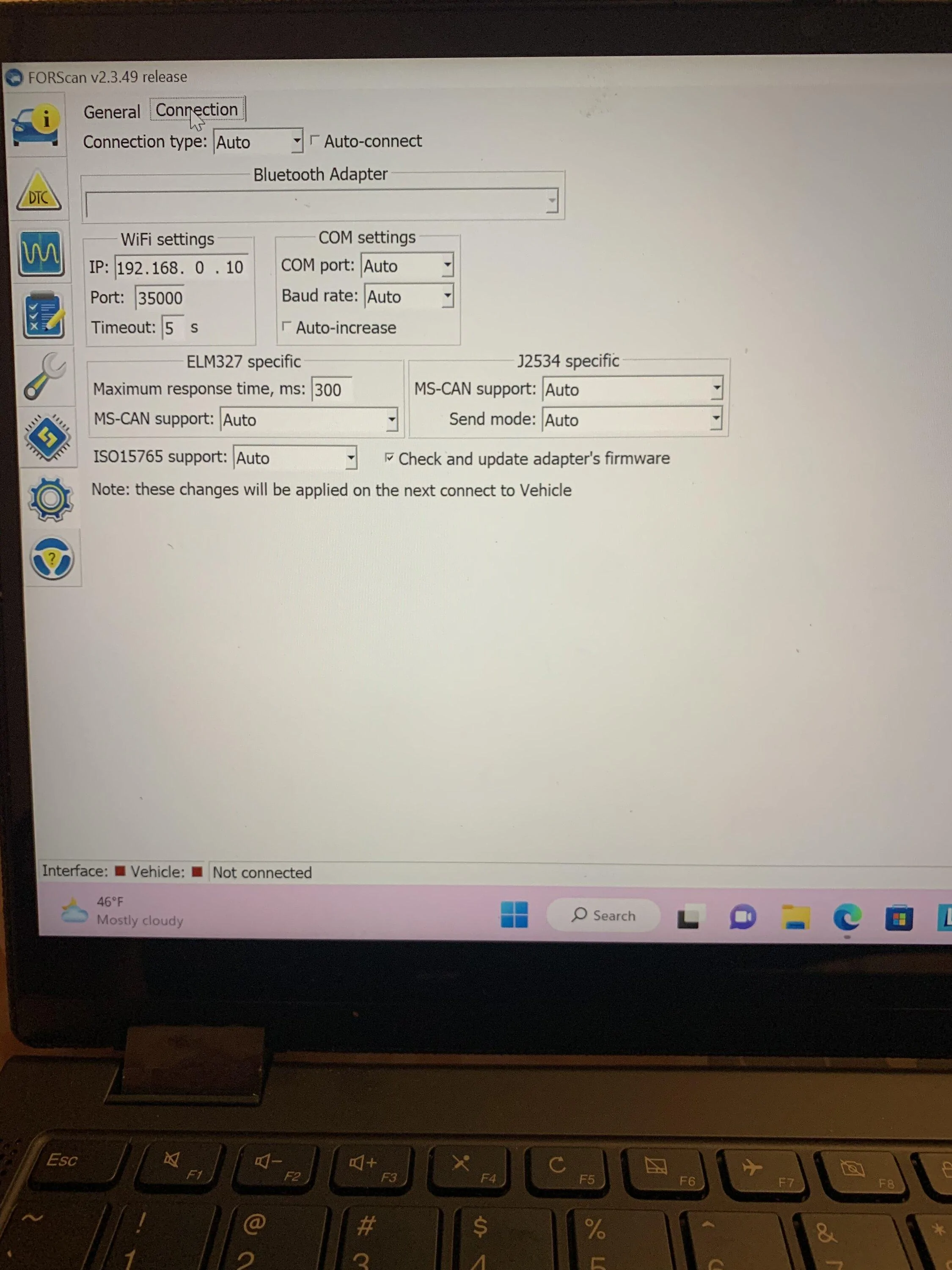

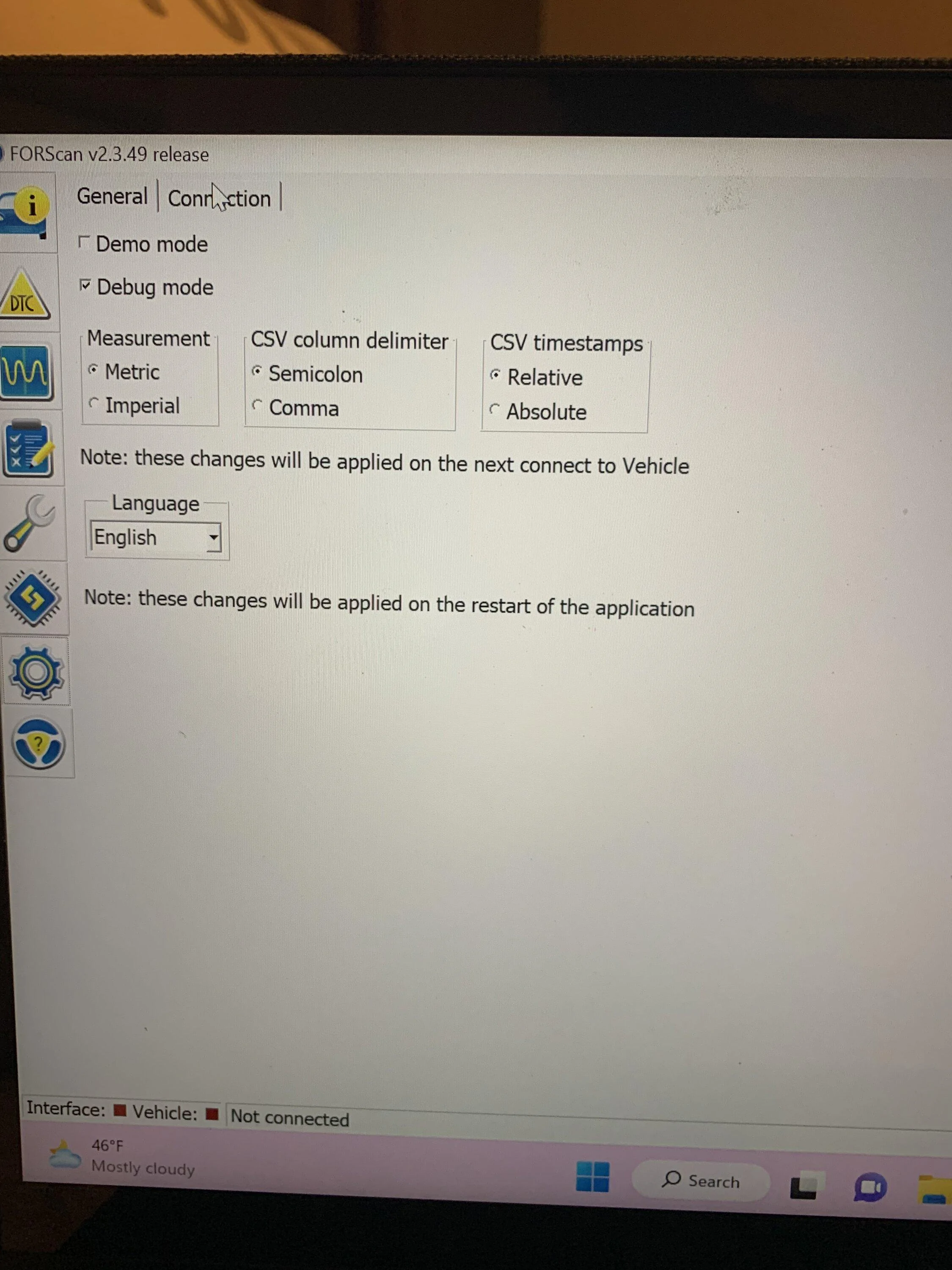

So I’ve tried with engine running, engine in accessory only, starting while connected. And I only get those same modules. This is driving me crazy. My free access is gonna expire before I get these speakers working. Pics of my screens attached Incase anyone sees anything I have messed up.

My same exact issue. Yesterday, I checked again with the engine running and saw just those same modules that you listed. I toggled the DEBUG mode to off, but the same modules were seen. I'm still unable to enable global window up, enable the fog light switch and disable the triple ding on startup.
You don't get the message with the OBDLINK EX that I get with the OHP, indicating that the adapter is not recommended for the vehicle. But you're still not able to see the rest of the modules.
