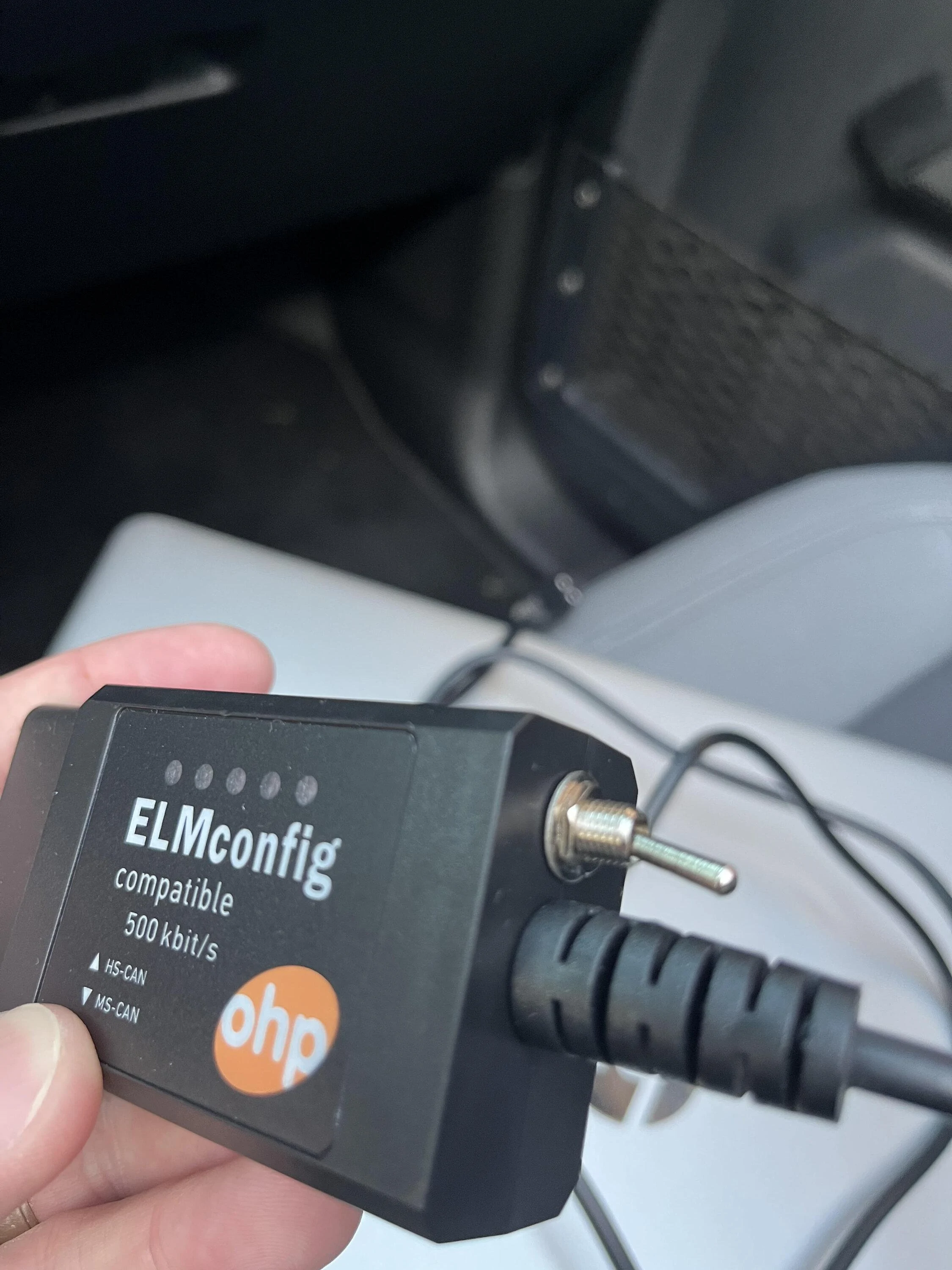

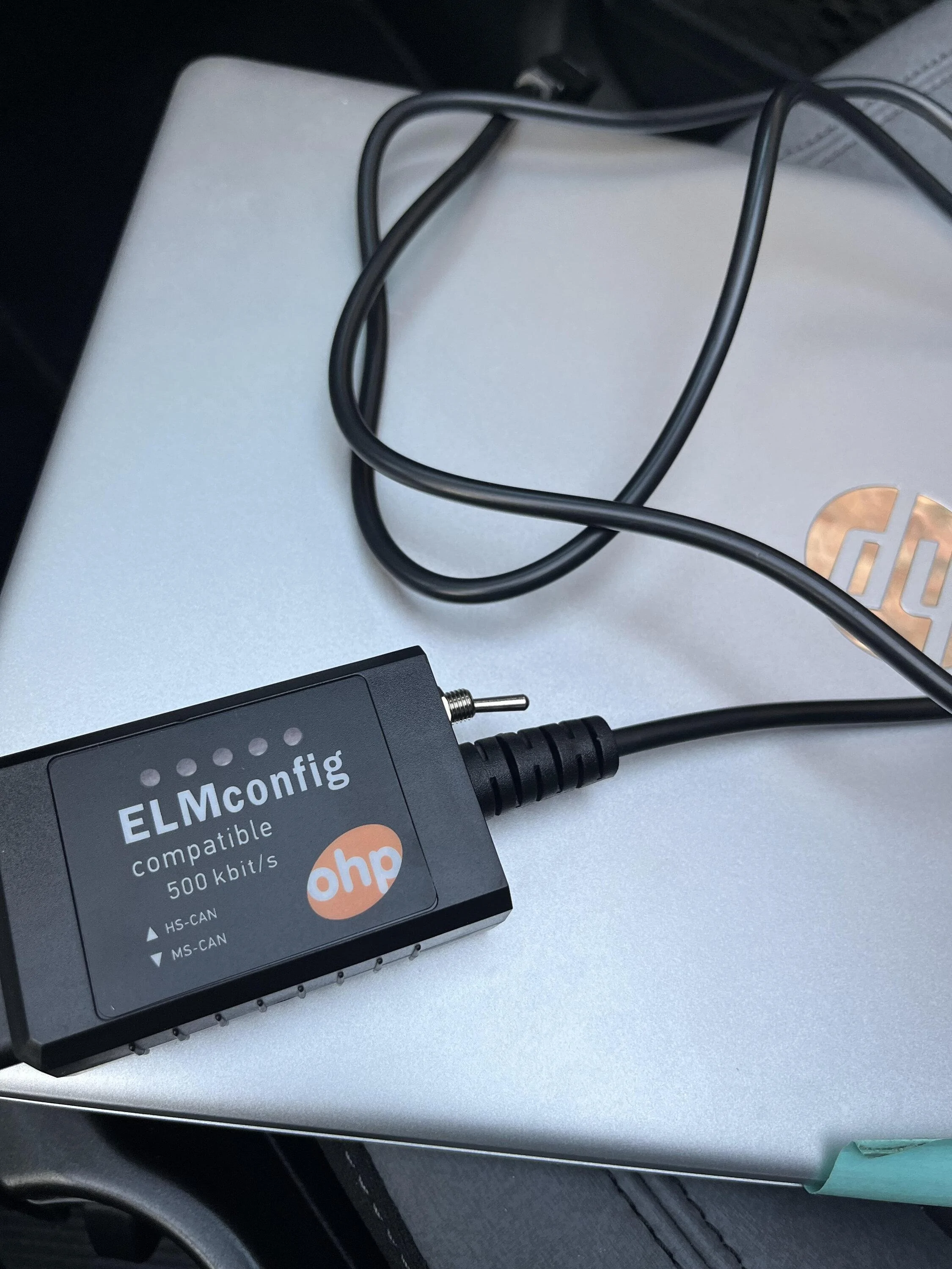

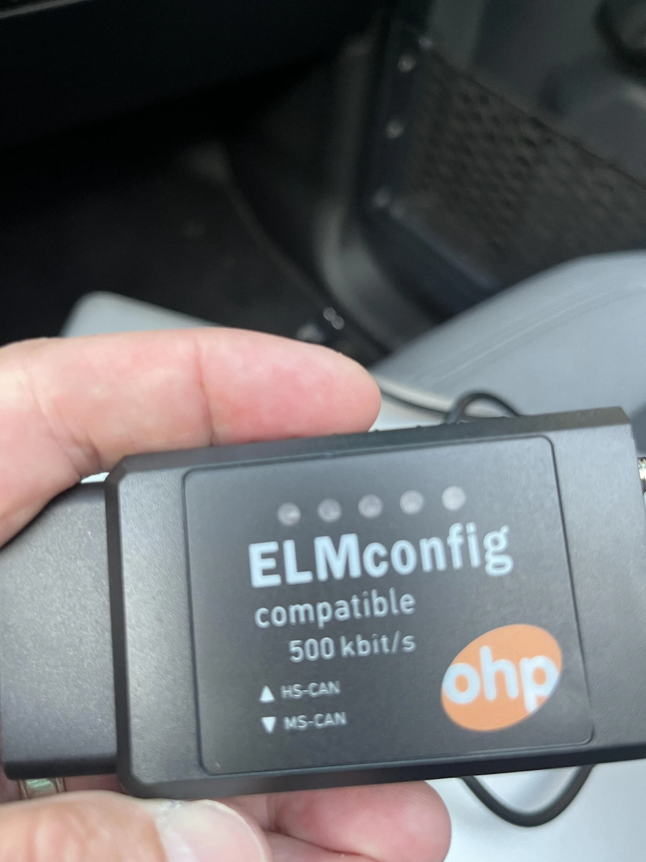

I too was not seeing all the modules in FORScan until I bought the recommended adaptor shared in another post (see image of the correct adaptor). I have a 2023 Big Bend Bronco w/o the B&O sound system. I was also using a fairly new and basic HP Laptop.
What I did that worked:
1) downloaded the updated FORScan software and did the 2 month free trail version where they will send you an activation code to copy/paste in the the program.
3) downloaded the recommended USB port access software from FORScan's recommendation.
4) bought the recommended adaptor from Amazon, under $25
5) followed the instructions provided with the adaptor
a) key take aways when following the instructions:
i) place the adaptor switch pointing to the HS-CAN position first before plugging into the vehicle's receiving port. After plugged in and you select "connect" within the FORScan program, it will show you about half the modules. Then, it will prompt you to toggle the adaptor switch to the MS-CAN position. Do this and then select "ok". This pulls in all the remaining modules, and the one specifically I wanted and needed was the ACM module, which appeared and I was able to make the simple changes to the settings.
ii) follow the remaining instructions to write the data, cycle your engine, and disconnect properly.
Hope this helpful to anyone having the same issue.
